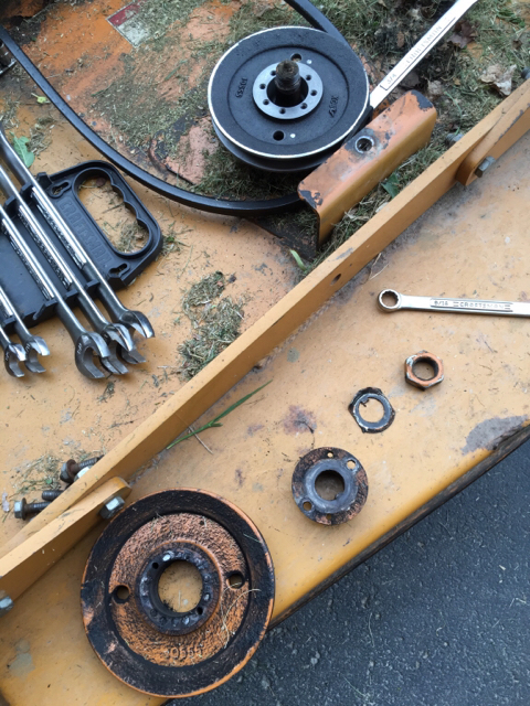

I am also concerned with the excess power. I have an 84" Woods and with my old 35 hp tractor I would break the shear bolts on a pulley once every one or two years. Now that I have a 60 HP I am shearing them 2 or 3 times a year..
I have a feeling that I will eventually be upgrading to a 90" since they are rated for more power. (Also 2x the price)
FYI I mow a ton in reverse, no issues, except it does tend to put more strain on things.
Orange sheave was the original, no more room for shear bolts. I drilled and tapped a bunch of new holes in the new sheave so I don't have to take the belt off in order to put a new set of bolts in.
