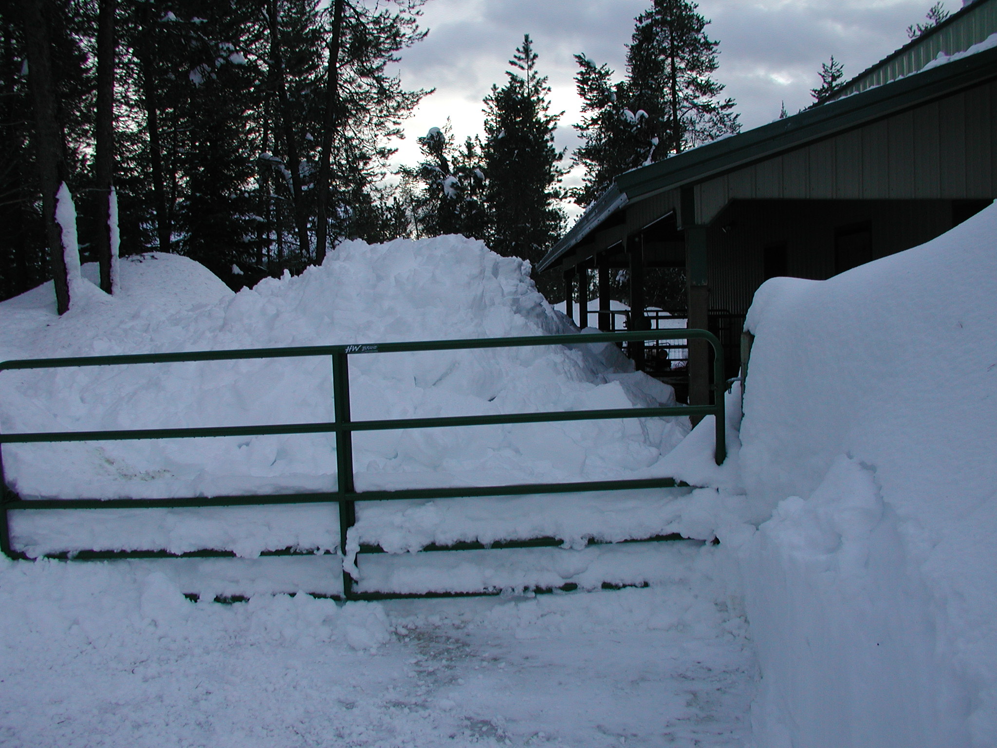

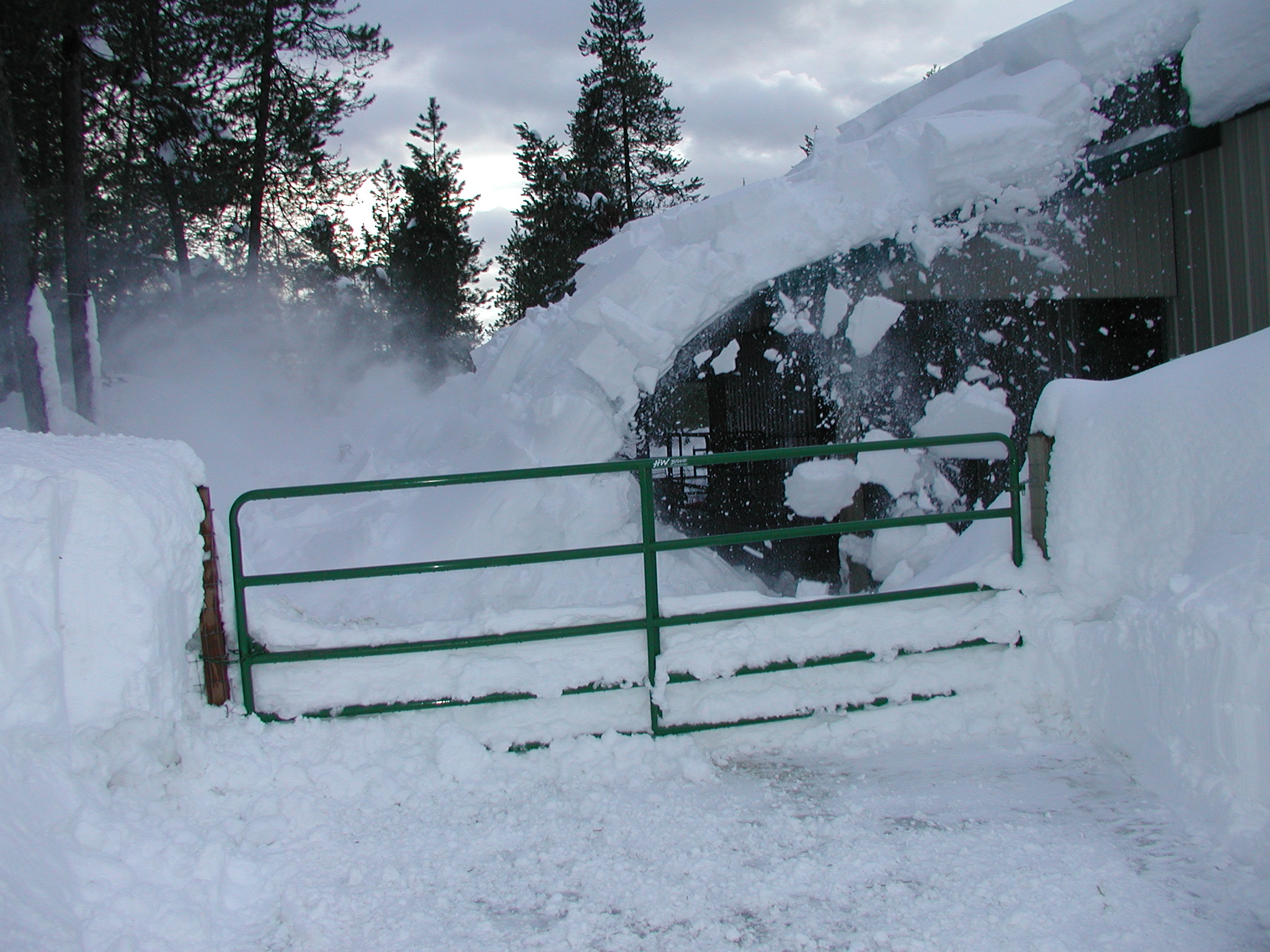

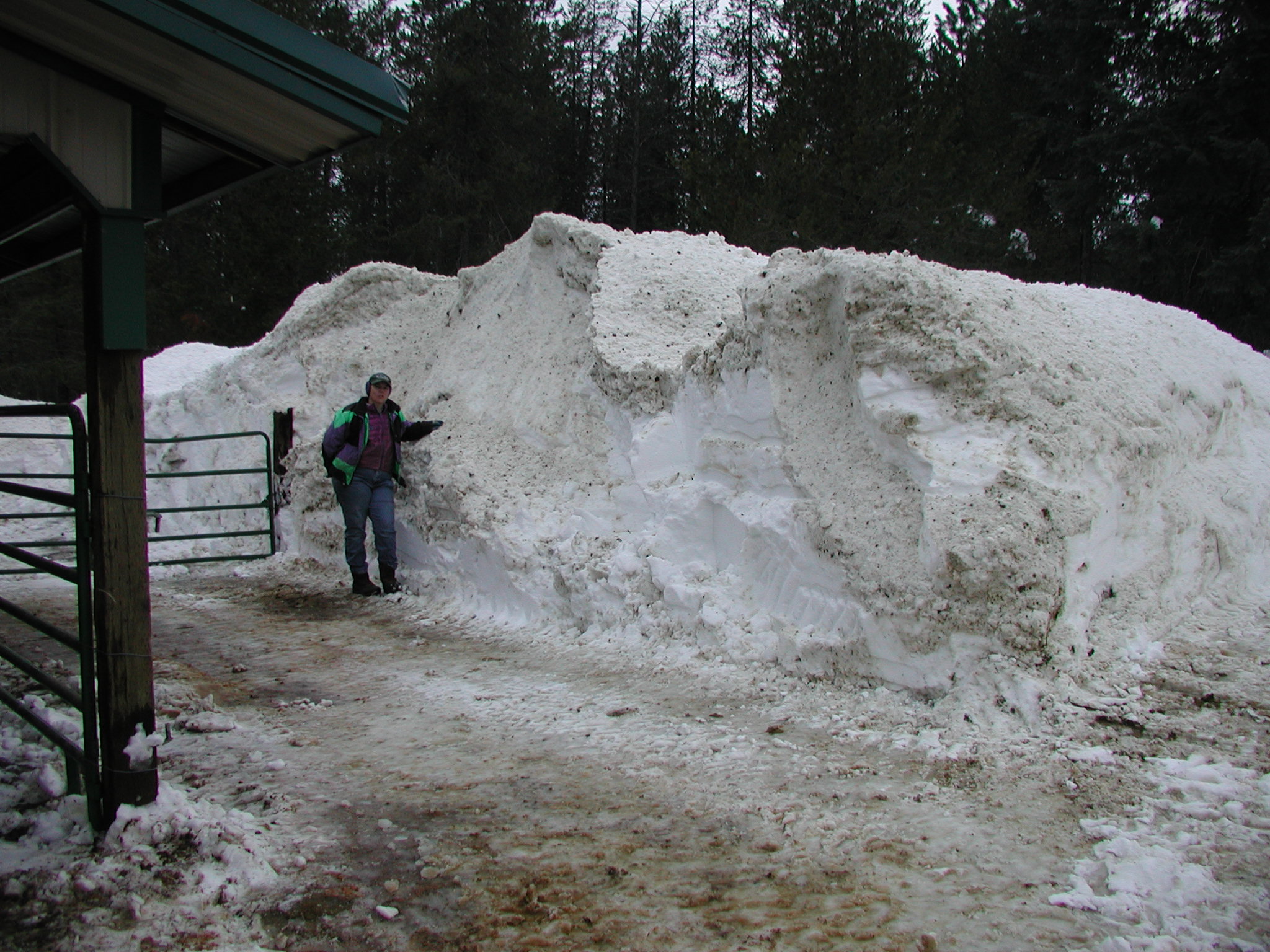

i like the overall idea of the pull type rear blower...but how can i possible use that with this kind of snow
They're not meant for any location with significant snowfall. I think the primary market is for snow contractors who have to quickly clear clear laneways / parking lots, with accumulations of 5 to 15 cm. ( 2" to 6" )
You would not be able to use a pull type for that kind of snow loading.
You defininetly could use a Pronovost PXPL-86-92-104 or a Pronovost Group 3 TRC rear mount snowblower and you have up to a 34 inch impeller drum diameter for heavy wet snows; the TRC option has a rotating impeller drum to by pass the chute and spout to discharge left or right with the impeller and drum opening to alllow fast discharge and casting of heavy snows.
