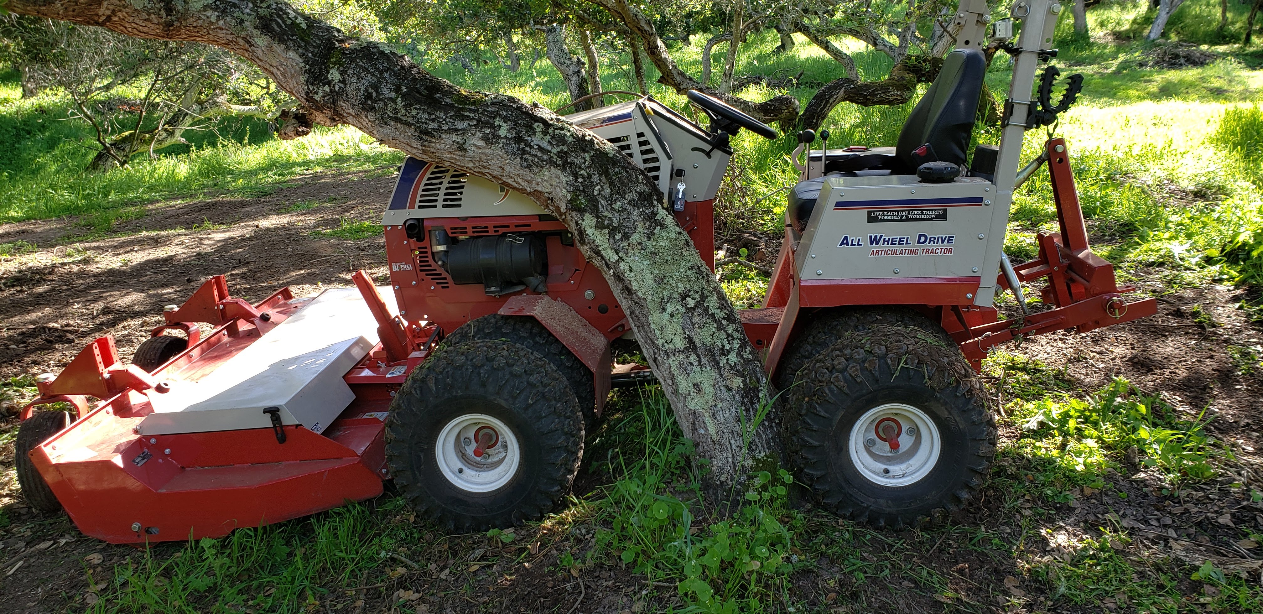

Hiya. I've recently gotten a 4500Z to clear and maintain very hilly property in central California. So far, it climbs and descends with considerable control, and I'm making serious progress clearing out the poison oak that has made this acreage untouchable to date. Hooray.
Still, I keep finding myself in this position:
I've read the advice about using the mower deck to lift the front wheels and shift them out of the path of the tree, but on this slope (which, in this picture, looks negligible -- it's not. It's about 20 degrees) that just doesn't work for me. Loose ground isn't helping at all.
I've finally learned the lesson (after cutting down two trees to free the tractor): Don't try to mow close to the uphill side of the tree -- it's just too easy to slide into this position on loose steep slopes.
Still, I keep thinking that if I had a rear-mounted winch, I could pull the rear end uphill just enough to clear the stump, and refrain from cutting yet another oak down. If you look at it, I have plenty of anchor points at my disposal.
Anyone ever mounted a winch to the back of their Ventrac 4500? If so, any advice? If this is a dumb idea, can you help me understand why?
Thanks!
If you up against a tree ( the tires, or close too the fenders) You need to stop. Get a come-along (hand winch) and find something solid up hill from you. Attach a strap to the upward (uphill) caster wheel bracket. secure the strap to your hand winch, and another strap that is affixed to the solid up hill tree. Put tension on the stap so the deck cannot slip down hill. Once everything is tight, start the tractor up and raise the entire front end of the tractor up by down pressure on the deck.
Once the front tractor wheels are off the ground, ratchet the come-along until your clear of the tree. Drop the deck down , remove the strap and drive it out of there.. takes a few minutes, but no tree or fence removal to get it free. Also, you will find the stabilty of turning on hills better if you Move the front deck casters to outside edges (just have to drill an extra hole on each side. Its how I always assemble the new ones before they are delivered)

I've tree-wrapped my Power Trac many times. I've always just driven around to the downhill side of the tree, then articulated off of it using whatever implement I had on the front for downpressure to crab-walk the front tires away from the trunk. May take 4-5 times, but it has always worked.
If the tree is on my left I:
- Turn fully right.
- Push the implement down unit the front tractor wheels get loose from the ground.
- Turn fully left.
- Lift up the implement so my front tractor wheels are one the ground again.
- Repeat a few times until I'm clear of the trunk enough to drive away.
Easy peasy. ;)
Only problems are if you cannot drive around the trunk because of other trees. Then it's time to thin the forest, so to speak! :laughing:

I now take Mr. Miyagi's advice; "Best defense is no be there." Johara described the common technique correctly, but the two times I got trapped, I had the contour mower on and it has large swiveling front wheels that prevent ground contact with the mower decks; thus NO traction. Pivoting around the obstacle was not an option as once there was a tall drop off on downhill side and the other involved an electrical guy wire. To crap away, you gotta have traction on the implement. It is not like having a bucket on or such.

My mower deck and brush hog both have caster wheels and I'm still able to get away from most objects I get wrapped around.
But sometimes you do get into a situation where you can't drive around the tree to the downhill side.

Nice work on the winch installation, Andy. Based on the one that we mount in the rear trailer hitch of our UTV it will be useful for many things. I can't see it solving the problem with wrapping the Ventrac around a tree, though, because the winch can only pull the tractor more or less straight back. Using pulleys will allow you to apply the force at the other end of the winch cable in any direction, but not at the tractor.
I've only had this happen once so far with my newish Ventrac (experience is a good teacher). The solution that worked in my situation hasn't been suggested yet, so I'll throw it out. I could see that with each articulation of the tractor the tree was getting closer, so before it progressed to the point where this wouldn't solve the problem I removed one of the outside rear dual wheels. Then I could just drive straight forward. That meant I only had to source a 1" socket, a breaker bar and a block of wood (to drive the inner wheel up onto) to solve the problem.

Agreed that this is no "silver bullet" solution, but as you mention, I've been using a snatch block and one of the various trees around to pull sideways when I needed to.
Removing the wheel -- great solution. I just didn't catch my mistake in time to employ that plan.
For now, my best defense is to follow the advice of another user in this thread: "Just don't do that." =0)
Still, wheel removal, potential articulation shifts, winching -- all better than cutting down a perfectly good tree. I'll report back with successes and mishaps.
