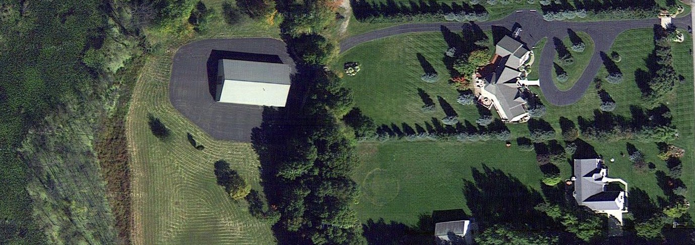

Hello guys,
I recently purchased a 2005 L4330HSTC - loving it so far. Had 700 hours, but well kept and maintained and will of course continue to be so. :)
I bought the machine for rotary cutting 10 acres behind our home. I also bought it for plowing our driveway and the area around our 62x100 building -- all of which is paved.
My initial thought was attaching a plow on the FEL, but with heavy Michigan snowfall, you run out of room for the snow -- plus, the plow is just obnoxious to maneuver around the circle drive, etc without damaging the lawn. I'm exploring blower possibilities. I'd prefer to keep the bucket and FEL to manage drifts, firewood, etc. The idea of blowing all that backwards isn't appealing to me, so I believe I'm settled on a rear pull-type blower such as the Erskine.
The question is, are there any reasonably priced alternatives to the Erskine? I can't see paying $7-8k for a snowblower for non-commercial use. I've come across the meteor unit, but haven't found much information about them.
Any insight would be appreciated and any thoughts on the rear pull from people who have used them in Michigan (or equiv.) winters would also be welcome. Naturally, one should expect to stay on top of snowfall - which with a heated cab, I don't think I'll mind doing -- a good escape from the wife and kids. :)
Thanks in advance!

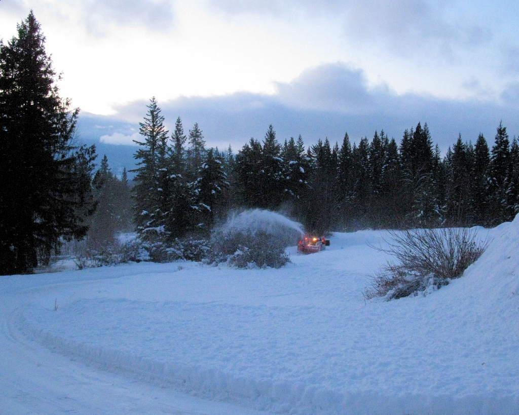

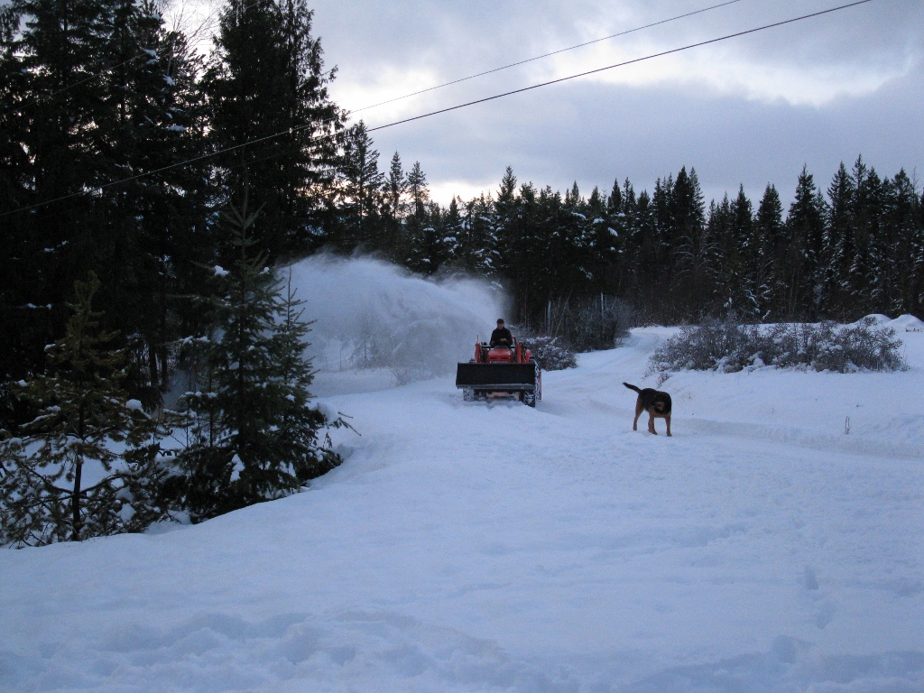

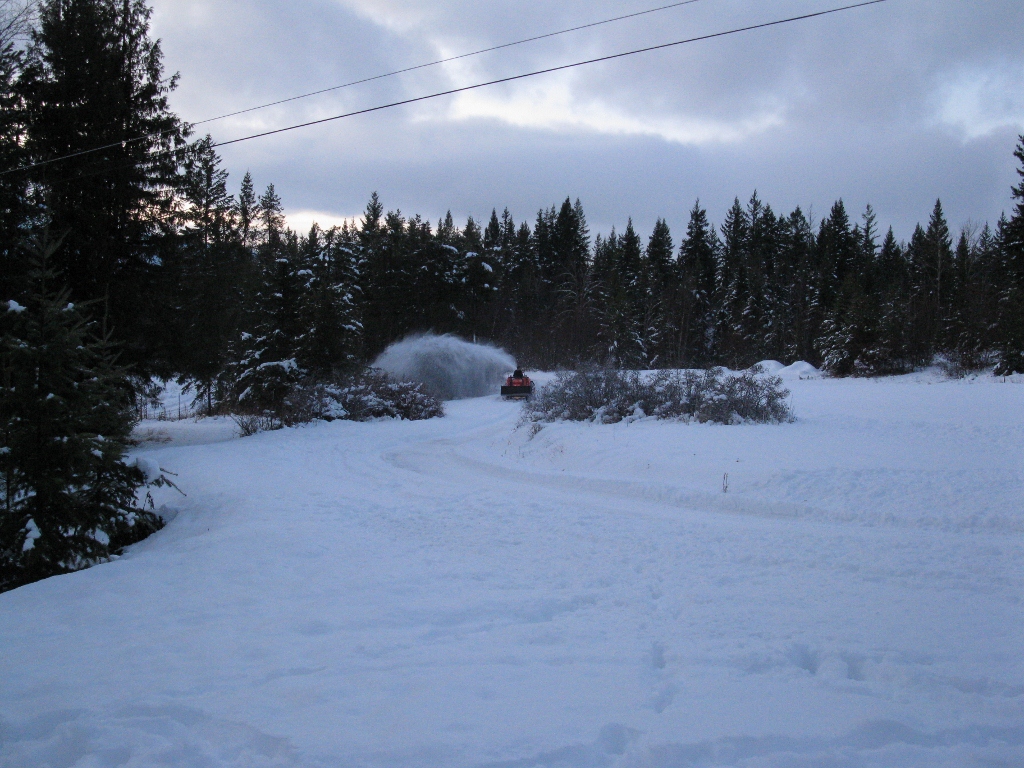

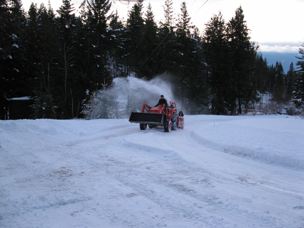

+1 on this. I have a similar layout with a drive-thru loop and long driveway. The pull-type greatly reduces having to look backwards. Although we get a lot of snow in my location it seems to never to dump more than 12" at a time (over the 9 years I've been here). My DK35 SE with the Meteor 75" pull-type easily handles it. Until last winter I used a smaller tractor and rear blade which required a lot of work in reverse. It was so hard on my old back that I had to quit plowing one neighbour's driveway. Thanks to the pull-type blower I'm again able to clear the large dumps from her driveway(another neighbour does the small ones with a quad) with no discomfort. I think the time I spend clearing has easily been cut to 1/3 what it used to be, and with NO back strain.
ERichter posted a link to a good video. Here is another one my dealer made for YouTube:
Snow Removal.mp4 - YouTube
As long as your tractor can get through the largest expected single snowfall a pull-type will likely serve you better (in my opinion) than a standard rear-mounted blower. The front mounted blower recommended by RFB will also serve you well but will be more expensive.

/ Rear pull snowblower #18
Hello guys,
<img src="http://www.tractorbynet.com/forums/attachment.php?attachmentid=278797"/>
Thanks in advance!
Try a Meteor pull-type. I have one and have found it a very good implement. Cheaper than others I believe but sturdy. Consider a hydraulic operated chute. I had to figure a way to limit rotation to keep the snow off of me and the tractor. It no longer gets me!
