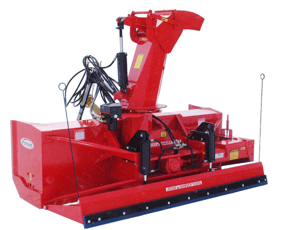

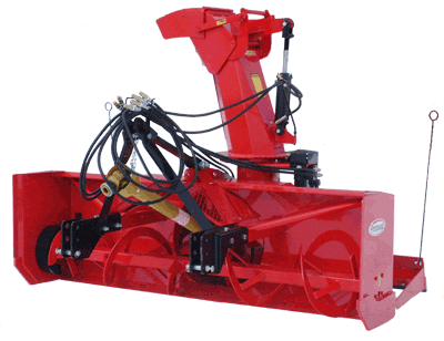

I think the same thing as rbargeron: a rear pull snowblower is built to be heavy. Usually that kind of blower is no less than 1000 lbs. My reference is Pronovost. Their smallest blower weights around 1500 lbs (plus 300 lbs for the back blade) and the minimum width is 86". I looked at Erskine and I think their blowers are too heavy for a B7800. I've seen a lot of blowers like that in my region but they are equipped on M-series tractors (M-110, M105).
I'd go for something smaller.
