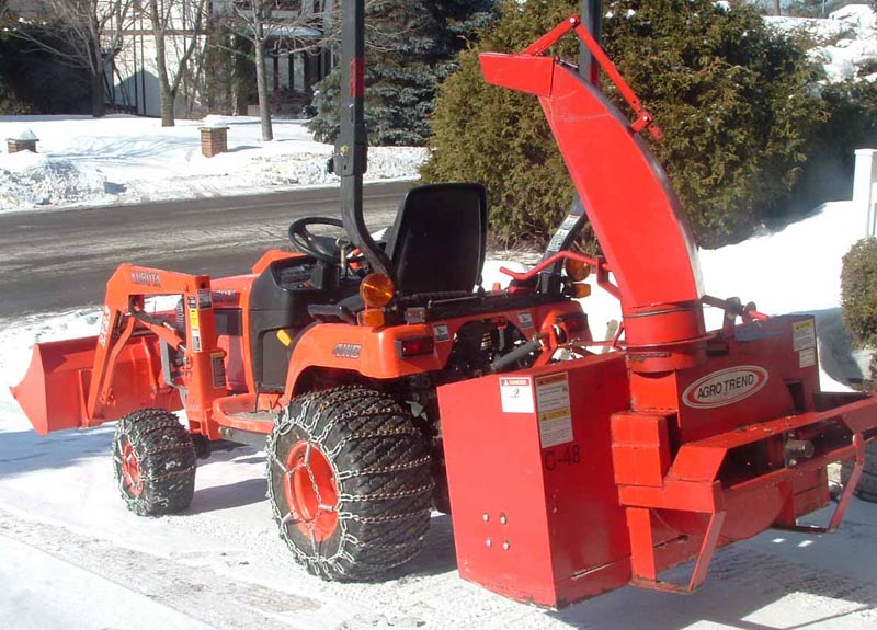

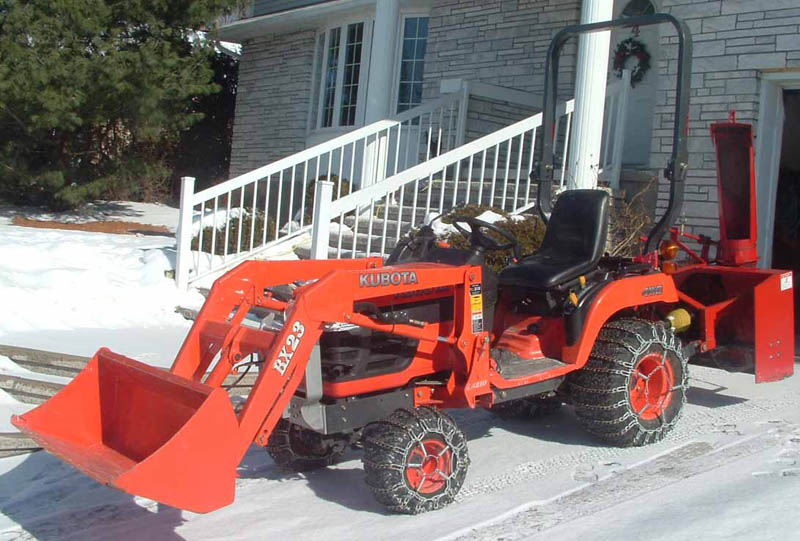

I just want to take the opportunity to add two nice pictures coming from lp333. Since that kind of snowblower isn't seen very often and the thread came back up I thought it would be a good idea to add pictures of his setup. Enjoy ;)

Stef is doing such a great job showing off my rig that I did not think it helpful to step in.
I bought my AgroTrend C48PBH used. However, my local Kubota dealer tells me that this model sold new on special order for about 2,200$CAN in 2006. I am guessing that it might sell new for approximately 1800$US further South.
I'm sorry lp333 I didn't want to get ahead of you. I have absolutely no experience whatsoever about owning or operating a reverse snowthrower... you're the man ;) . IMHO, the use of this kind of blower is rather limited for compact tractors (clearance). We see a lot of blowers like that on big tractors (80 pto HP and up).
I'm pretty sure you're setup is very pleasant to operate when the "winning conditions" are present ;) . BTW, with a setup like yours what's the ideal snowfall? My guess is around 6 to 8 inches but as I said I have no experience with that kind of blower.

... I'm pretty sure you're setup is very pleasant to operate when the "winning conditions" are present ;) . BTW, with a setup like yours what's the ideal snowfall? My guess is around 6 to 8 inches but as I said I have no experience with that kind of blower.
The going is easy with only 8" of snow, perhaps because I have chains on all 4 wheels. The BX23 starts slowing down and the wheels spin when the front tires disapear under the snow - in other words, when the snow reaches 16 inches or more. In thick snow, I like to lower the FEL to prevent the front wheels from getting buried.

... Might have to rethink the rear pull style as just 10 miles north of here had 5-6' drifts with just 5" snow (50+ mph winds) and 50 miles nw 17' drifts with 17" snow and wind...
A rear pull blower working in tandem with a FEL can be pretty effective in adverse conditions. Howevert, under the above rare and exceptional conditions, I'm not convinced that a conventional snowblower mounted on a compact tractor would have such an easy task.
