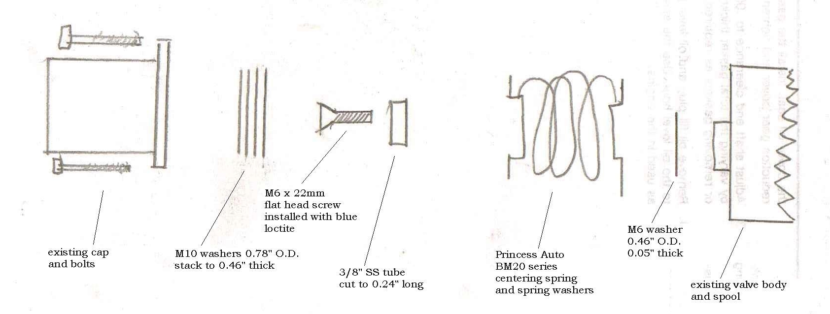

I misunderstood as I thought your snow blower was driven by a hyd PTO pump, and you are saying that it is driven by the PTO shaft, and the chute and deflector is hyd. Got it.
   / Rear remote spring center
#12
I managed to convert to spring center using parts from Princess auto and some washers. I kept the 3 position parts in case I ever want to switch back.
I doculented the parts used and have attached the file.
Thanks for your help.

Thanks cleat, great job!. May do the same to one of mine. I bought the BM20 valve at PA for my front remotes for snow plow etc. Nice to know the parts fit the 'remotes' valve setup.
Dave
