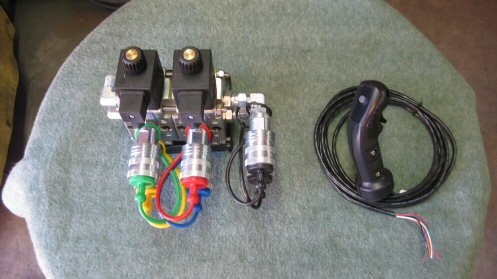

  3. Summit hydraulics 4 spool kit and Summit/WR Long 3rd function kit. This would allocate everything with its own valve.

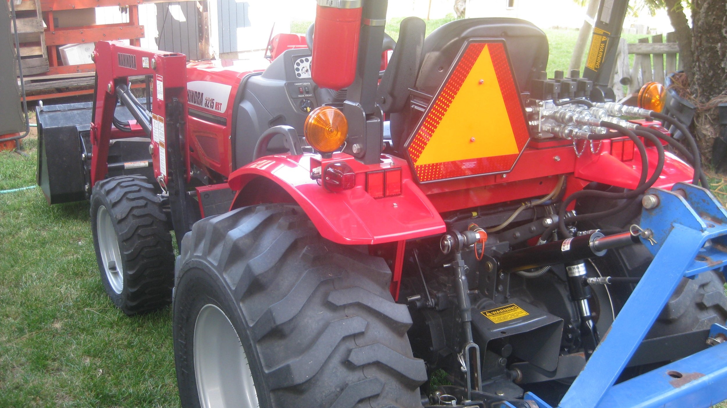

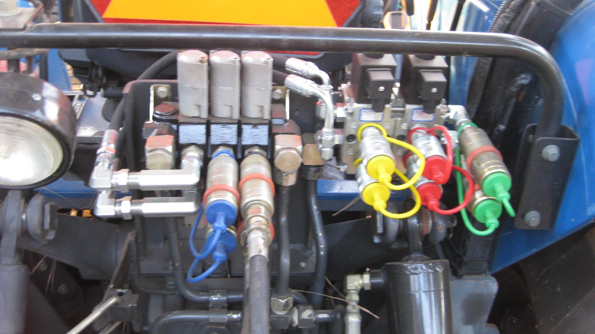

Maybe get both of the factory rear remotes and then go with some diverters if you decide that you need more sets of couplers.
I have one tractor with one factory rear remote with a triple diverter and my larger tractor has 3 factory rear remotes with a double diverter.

So add a double diverter. This takes care of the additional sets of couplers that you need.
A triple diverter is pictured on the tractor.
Controls for the diverters would be on the factory rear remote lever.
You would be able to control 3 separate functions without ever taking your hand from the control lever. :cool:

I think for your situation I'd start with the Branson remotes and run the top and tilt off them. I would get a summit 3rd function kit for the grapple. It's a decent price for the parts and includes a high quality joystick knob with buttons.
I don't like switching hydraulic hoses all the time when I switch implements, which I do a lot, so I'd spend the extra $$ for a fender mounted two valve unit to operate the flail. You might be able to get a kit from my dealer, Dave's Tractor in Red Bluff CA. Or make one. With dedicated valves you can get some with float if the flail needs that.
You can chain all the valves in series. The lever operated valves will need power beyond ports and the solenoid valves for the 3rd function, don't need power beyond.
