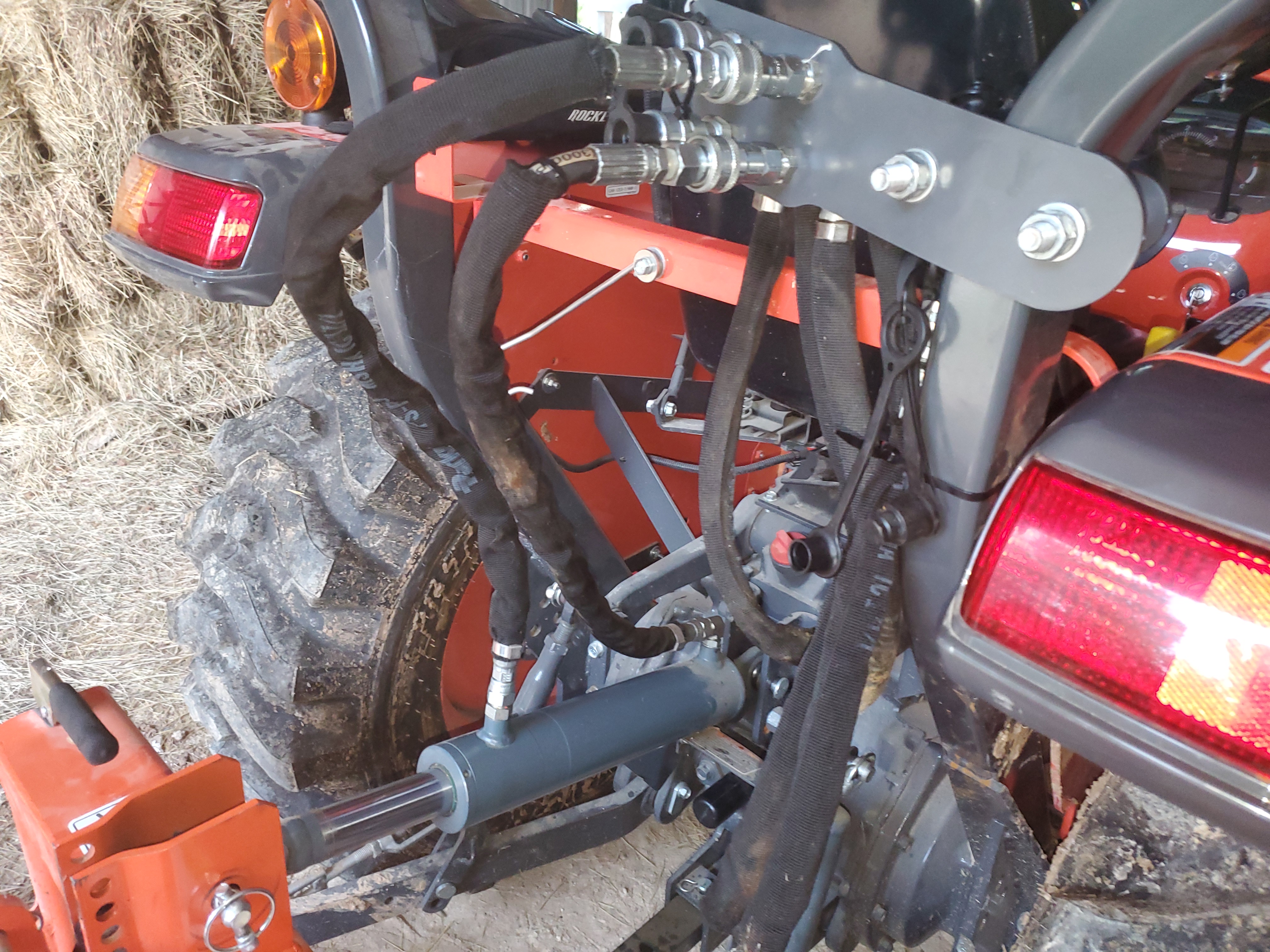

I managed to move the plate up and out of the way, but the tilt cylinder hoses are too short. Additionally I had to remove my tool box due to interference.
Still sorting.

I need to lengthen all hoses and flip the coupling plate to the outboard side of the rops. Over the taillight. Not ideal but better than hitting them when the hitch lifts.
Going to try and get my dealer, whom I like, to foot the bill.
This is kinda bs the money I spent on Kubota parts (which are actually impressive, other than zero engineering going into the mount setup) and the time trying to get it working.

What if you switched the coupler mounting plate to the front side of the ROPS and had it as high as you can ( so lower that it is in the picture) and still have the side link hoses long enough?
I have no idea if this would work or not, :confused3: just a suggestion. ;)
That was my first thought as well, but it lacks the clearance
Eta - assuming I'm understanding correctly. Think I am.

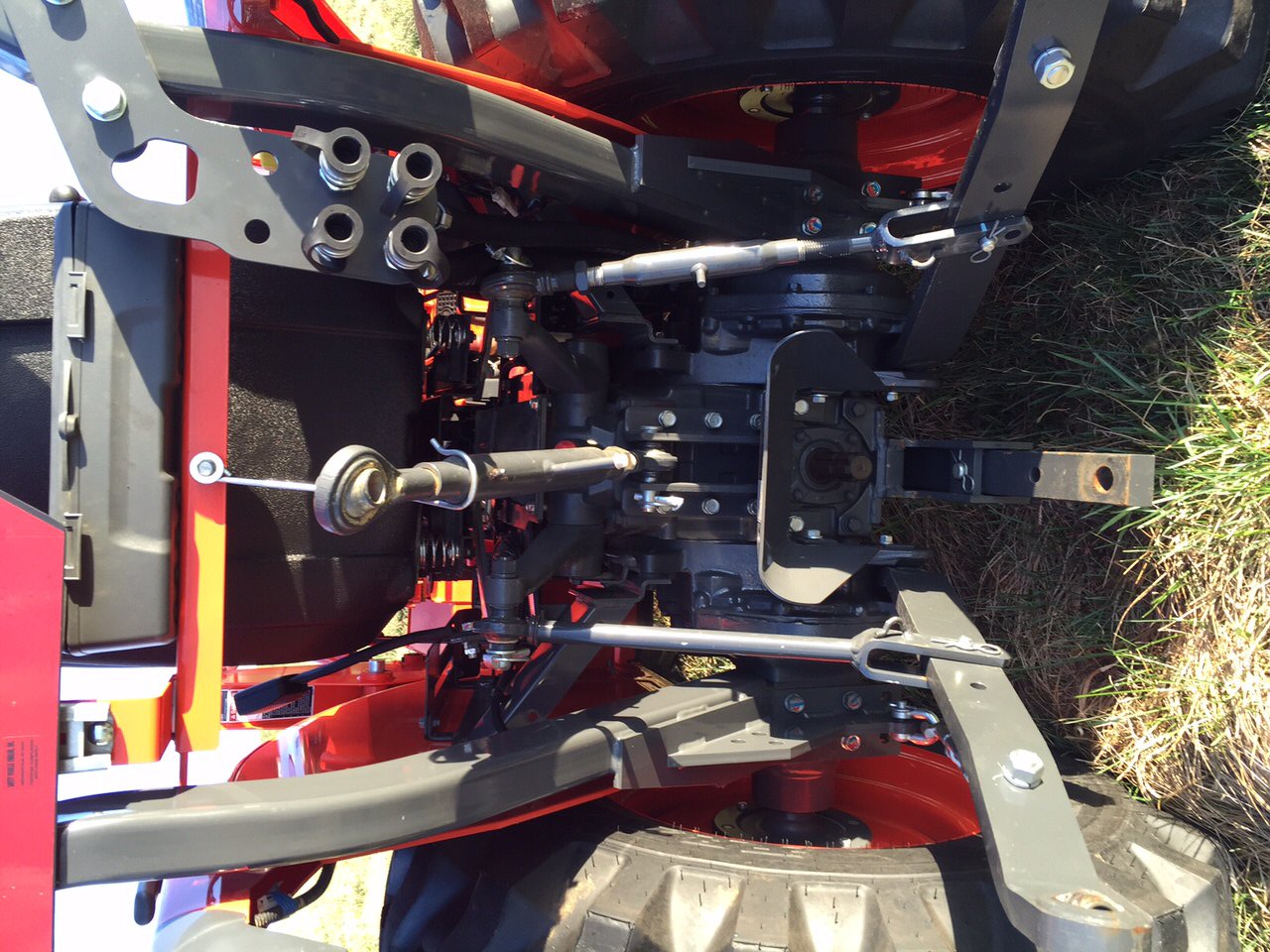

OEM Kubota coupler mount for an L3301.
Sorry about the picture. :eek:
   / Rear remotes Kubota L2501. Issues
#18
MtnView thanks a TON brother. That bracket is what I need. I'm going to try and get a part number for my dealer.
