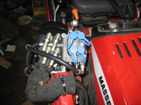

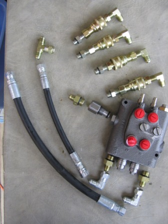

Here we go. I will post my progress so far and lessons. Keep in mind I am new to tractoring and have never done any hydraulic work.
To catch up, I decided to add a 2 spool valve to my GC 2310 for its birthday. My bride said I can get an implement a year and I wanted a grapple. I looked at the electric long valve and was quoted over five bills for it! I figured I could add more functionality for less money with a 2 spool valve. My next upgrade is going to be a hydraulic toplink.
Anyhow, I checked the archives and asked around (Thanks Kenny) and decided on the Eaton Cessna 5 GPM compact valve with the power beyond sleeve from Surplus center ($235 with shipping)
Most of the threads I have seen discussed adding the valve into the Hoe loop and mounting to the ROPS. My primary intent was for the grapple so I wanted it closer to the front. I decided to mount it next to the loader valve.

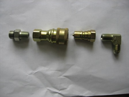

As I said, I am new to this so When I got my valve, I started to look at all the different types of connections etc. and found a lot of confusion. JIC, NPTF, NPSM, 30 degrees, 37 degrees, straight, tapered, metric, O ring Boss. I wasn't sure what I had and how well things mix so I ended up going to a local hydraulic shop. I ended up spending close to $200 (you were right Kenny, nothing is cheap in hydraulics!!) I figure I probably could have saved at least $50, maybe more if I went on line, but there was value for me in making sure everything fit together before I bought.
Any way, here is a picture of my parts.(sorry I do not know how to post into the message as anything but links).....
http://www.tractorbynet.com/forums/attachment.php?attachmentid=78286&stc=1&d=1180834948
http://www.tractorbynet.com/forums/attachment.php?attachmentid=78288&stc=1&d=1180834948
I did consider a 3/8 QD upgrade, but it would not fit without all kinds of funky angels due to the small size of the valve. I ended up changing the position of the male and female from the picture as well so it was just like my loader valve. Especially for the grapple thumb I figured I did not need the extra flow
One thing I learned is that the stock QDs are a little undersized, according to their specs.
I did upgrade the hose between the PB and the new inlet to 3/8 to allow max flow and went with a different brand QD. Since I was not tying in to the hoe loop, I did not need to ensure interchange between them.

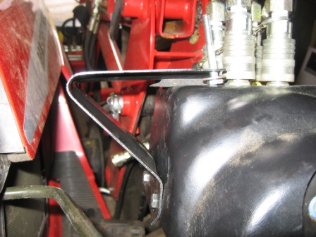

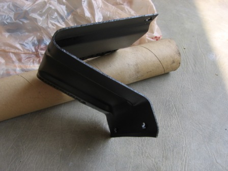

Next I got out my wife's sawzall and found some scrap steel and made a mount.
http://www.tractorbynet.com/forums/attachment.php?attachmentid=78298&stc=1&d=1180835768
And attached it using the same scews for the loader cover.

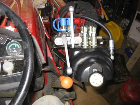

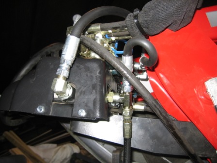

Here is the view from my seat - I believe I am going to need to tuern both handles down as they hit the QDs when pushing forward. It may rub on the cover though.
http://www.tractorbynet.com/forums/attachment.php?attachmentid=78300&stc=1&d=1180835768

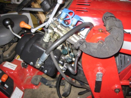

Here is a nice view from above you can see how I was able to run the PB Loop between the existing QDs for the loader. I ended up having to run the new feed from the loader PG over the hoses. I ended up getting both hoses too long. I forgot to account for the fittings. :(
http://www.tractorbynet.com/forums/attachment.php?attachmentid=78302&stc=1&d=1180835768
The new outlet to sump is also too long. I think I need to replace this one, but I believe it is low pressure - low flow.
Here is the new Tee I added to the sump return.
http://www.tractorbynet.com/forums/attachment.php?attachmentid=78303&stc=1&d=1180835768
It seems to work, although I do not have my grapple yet or any other toys, I mean tools. It clearly pressures up when the valves are deadheaded and the loader still works!! :)
My next task will be connecting the new hydraulics to something. How do I fiigure out which is supply and which is return to the remote pistons? Does it make a difference?
Thanks to all and stay tuned...
