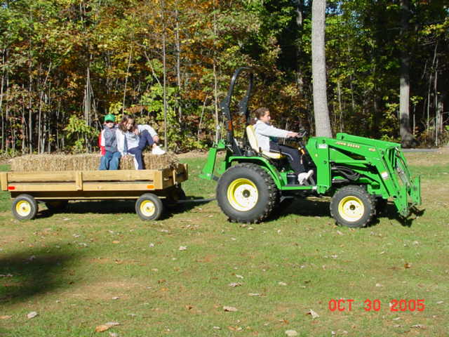

And now for a test drive from the chief test driver to confirm there are no leaks or other problems, along for the ride is the crew chief and head mechanic to make sure everything was working properly!

   / Rear Remotes on a JD4110 #13
Very Nice! Your pics will be very helpful when I get around to doing the same thing! /forums/images/graemlins/smile.gif What did you use for handles on the valve?
#14
Thanks for asking, I had meant to include that part in the original post!
I had thought I could source the correct handles from Danfoss, Finally found a local dealer, and after 2 weeks of calling and them blowing me off, they finally replied with a cost of like $45.00 a piece! Yeah Right!
So I got some 5/8 round bar and made them myself, modeled them after the ones on the log splitters at TSC. It was a PITA to get them the same and work properly, but we all have unlimited time right?

   / Rear Remotes on a JD4110 #15
Okay- Any concerns with the gpm of that valve??
#16
</font><font color="blue" class="small">( Any concerns with the gpm of that valve??
)</font>
I had thought that originally, But the IN/OUT fitting size is actually larger on the Eaton valve (SAE 8) compared to the Danfoss (SAE 6), I am not sure why they are rated so differently, The 4110 is rated 5.1 GPM, so I think the Eaton one will do the trick easily.
