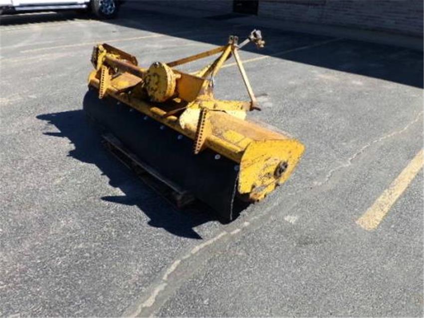

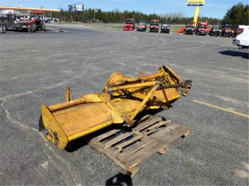

I found a used Mott 72 near where I live. It looks to be in good shape. I'm going to call Monday about it. Anyone have any experience with this model?
Here are some photos. Looks used but serviceable. i am going to inspect it this week.
Any thoughts?
