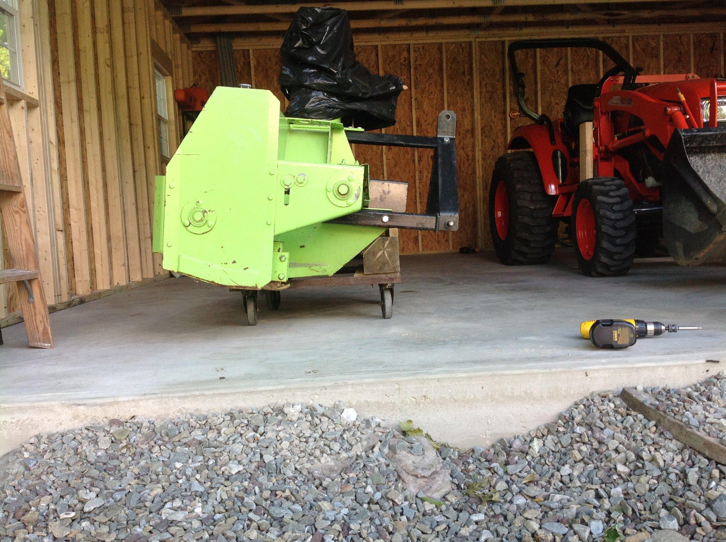

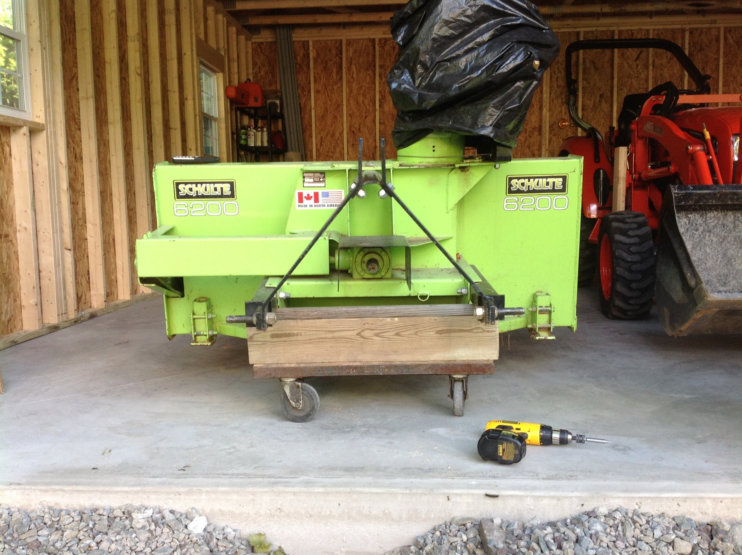

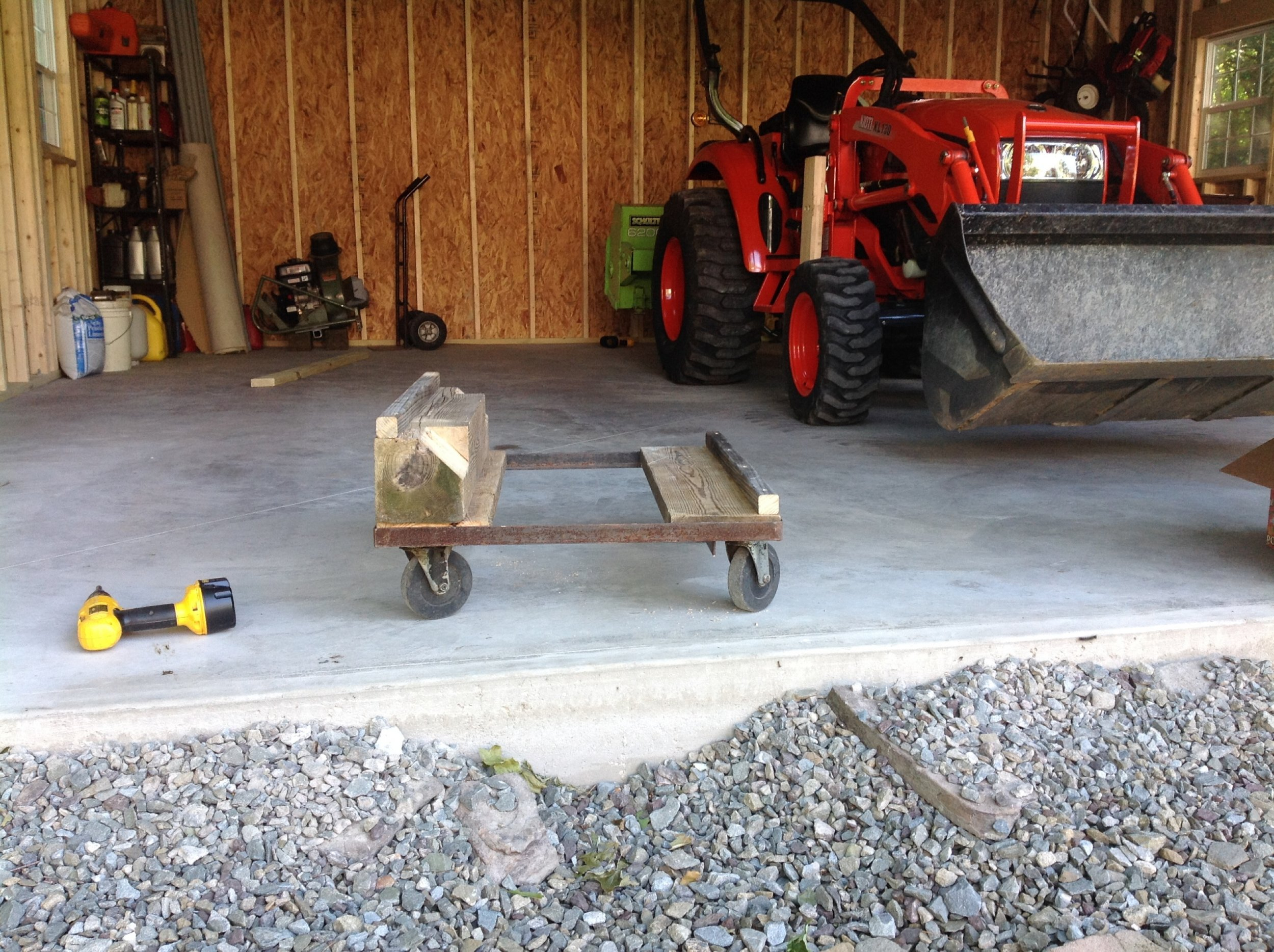

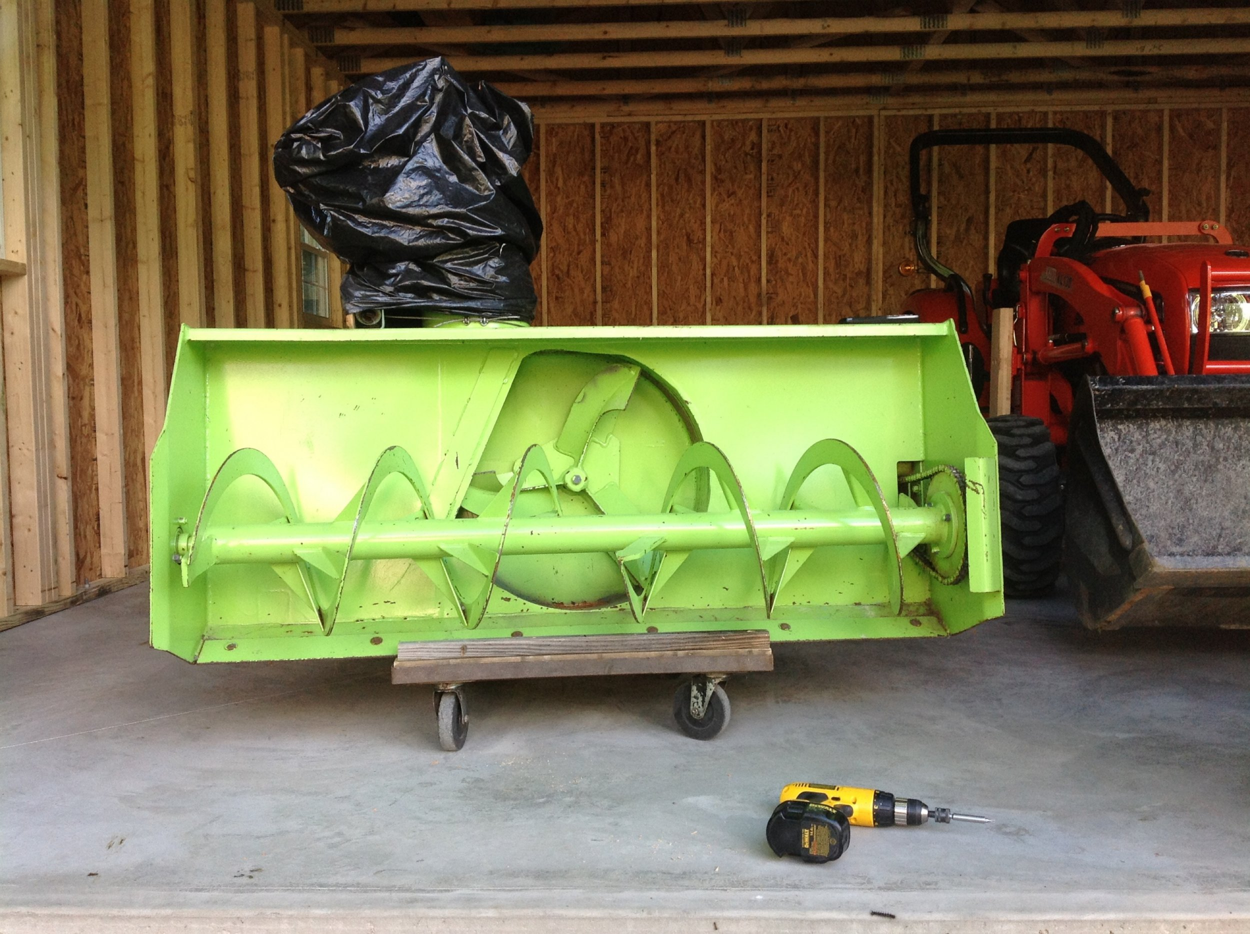

Here is a cradle I made out of a found dolly a few years ago. Blower weighs a little over 400 lbs and with a swepted floor you can roll it around with one hand. With the blower still on the tractor roll the dolly under it and add what ever you need to cradle the blower.
