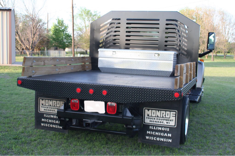

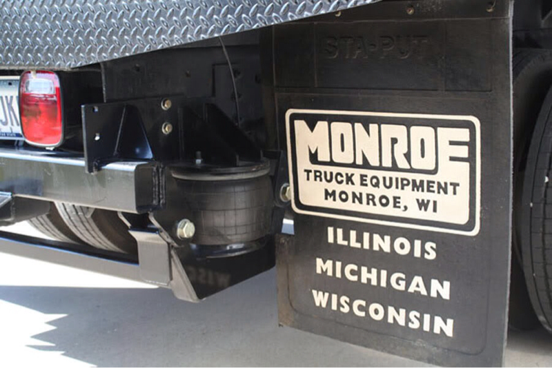

My old setup on an 06 C-4500. Kelderman rear bags. Compressor w chuck at the rear. Separate valves. One for each bag. If you look closely, the air chuck is beside the left tail light. The air filler valves are above the taillights. image-364792229.jpg image-1409742544.jpg

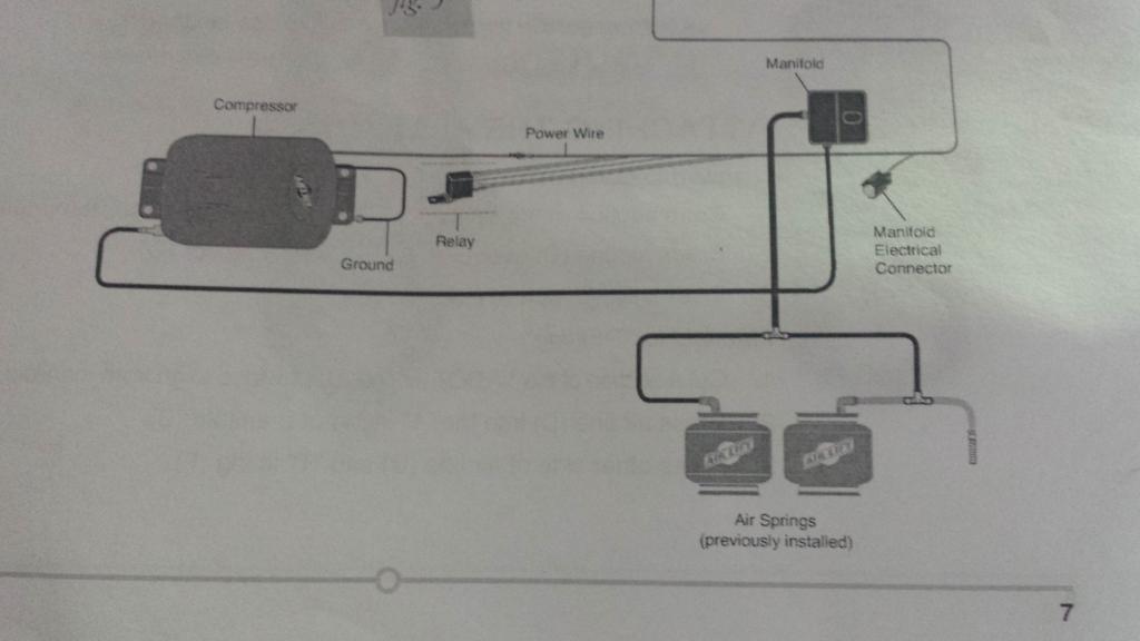

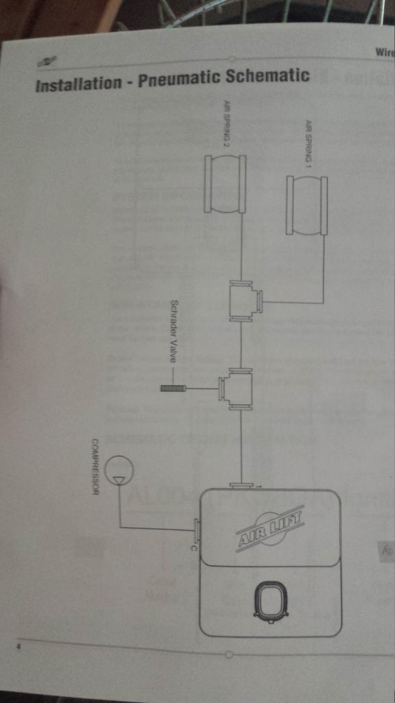

   / Rear suspension air bags (air lift or firestone) ?? #67
   / Rear suspension air bags (air lift or firestone) ?? #68
   / Rear suspension air bags (air lift or firestone) ?? #69
Mine are done like the second photo. I did that in case I ever had a compressor failure I could still air them up conventionally.
   / Rear suspension air bags (air lift or firestone) ?? #70
I have Airlifts on my van. I like them and did not use the T for reasons mentioned, that's what my research showed. I can air both up in a couple mins using a small bicycle pump. One added thing I like about this arrangement, if I have a leak it's narrowed down quite a bit.
