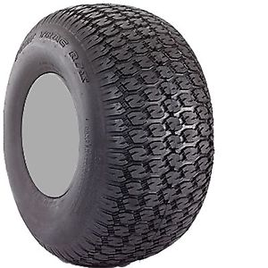

Here's what I did. On my 4410 I replaced my 27x8.5x15 turfs with 26x12x12 for more flotation and traction. If you shop around you can find a 26 inch tire that's the same height as the factory 27x8.5x15 Titan tires that the tractor came with. If you watch what you buy you can find a peanut style tread that will give you more traction on snow that any other kind of tire. I have no problems running out of power long before I run out of traction pushing snow on a cold day with my front end loader. This is without any tire chains or added ballast.
I bought new 12" rims from John Deere with the correct bolt pattern for my 4410. They were off of a mower and I found them by looking through the John Deere parts books. I but them in two and made the rims an inch wider. Next time I would go two inches but I thought I needed to play it safe. I went through several sets of front tires before I caught on that you could buy them on 6 ply ratings. This last set has lasted a lot longer.
Right now I'm using a Carlisle Turf Trac R/S s-l300.jpg

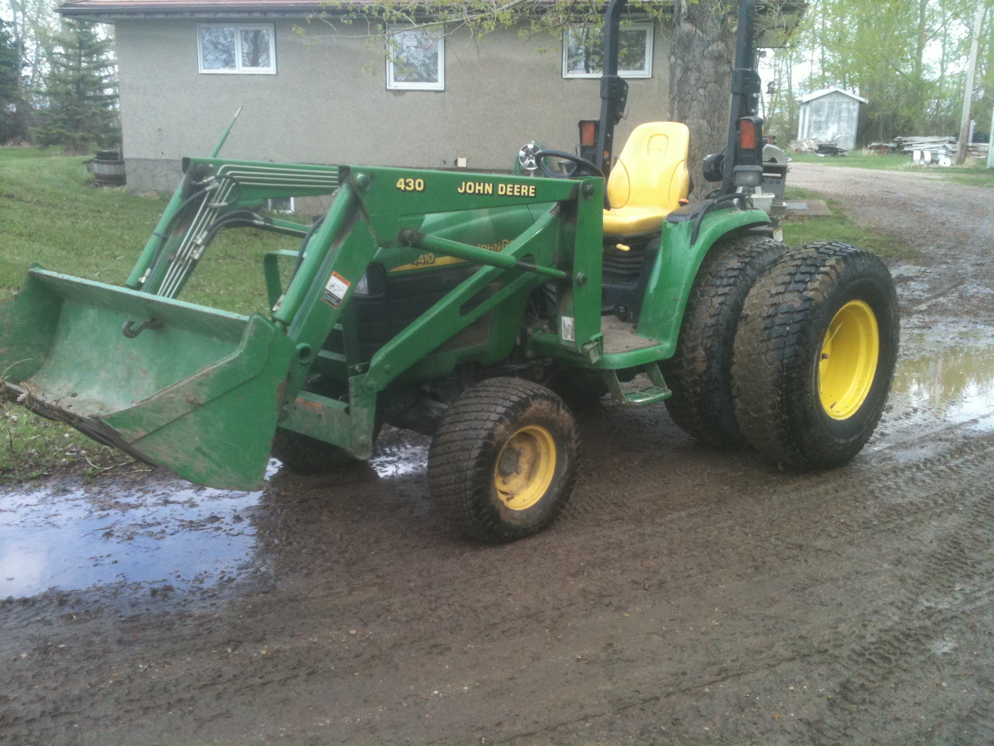

Good point but in about 2000 when I did this I didn't even consider the gauge of the metal. I don't think I need to worry about it any more.
The sharp ones here will realize that 4410's weren't even out in 2000. These rims spent a few years on my 955 before I bought the 4410.
