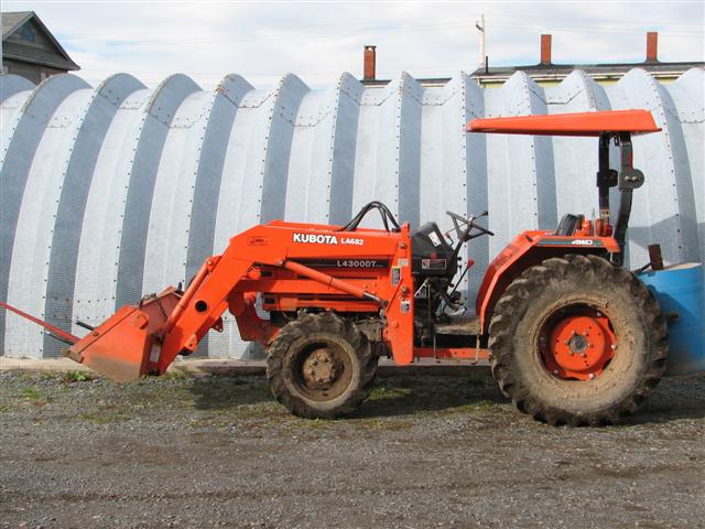

Here's one I made for about 15$ worth of materials and hardware, including an old cattle feed tub, and spare drawbar. Just had to buy the cement, some bolt/nut fasteners, and then drill holes in the toplink 'flat' stock metal I used.

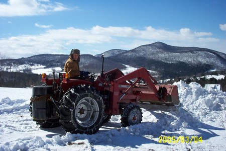

Right on Soundguy, I did the same thing with a 35 gal drum and a bunch of rocks and concrete. I think its close to 700lbs.
scotty

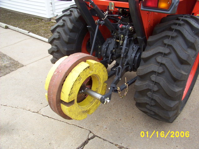

Just slapped this together this weekend. It is 2 John Deere D wheel weights and a bailer flywheel bolted together. The shaft is reduced down twice to 7/8ths for the arms with the shoulders of the reducer forming the inside stop. A couple pipe collars hold the weights in the middle. It is balanced so it is easy to drop off in the shop and roll around out of the way. Another nice thing is if I forget to pick it up, it will just roll along behind until I notice it. It weighs 500# total. I think 300-400 would have been best but this is what I had. Ag tractor dealers have weights like these in piles with nowhere to go if anyone is looking.
