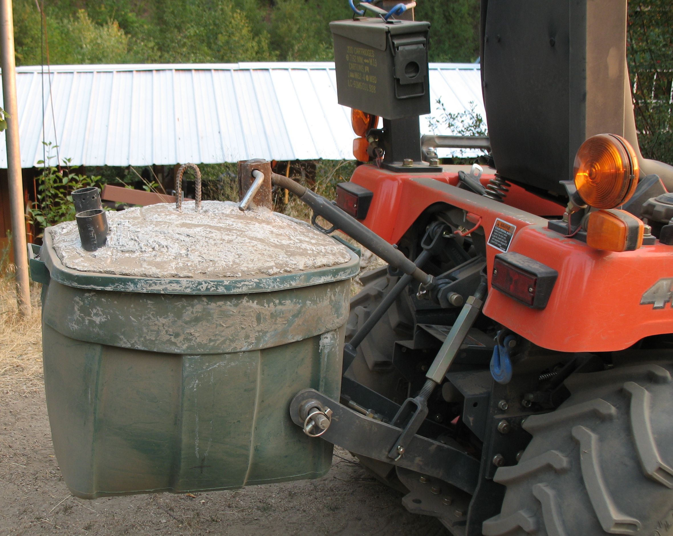

Here's mine.
It's an old cattle molassis feed tub, ( free after the cow was done with it ), a spare drawbar bolted tot he bottom of it, a piece of flat stock for a toplink connection, some assorted bolt/nut/washer hardware, and a few bags of concrete mix... minimal cost altogether. Took an hour to assemble... and if i ever ditch it, I remove 2 nuts fromt he bottom and slide my drawbar off...
