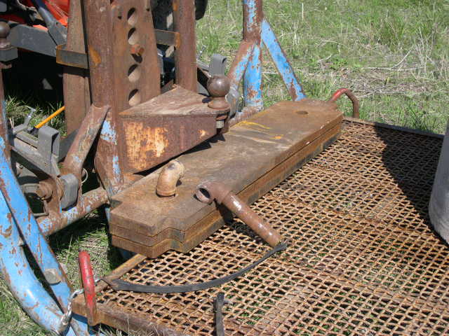

My multipurpose rear attachment tool is a hay fork with welded support for gooseneck trailer ball, weights permanently attached to the hay fork, a carryall platform on the hay fork to which I can add additonal weights. In my case, I obtained some old elevator weights, 80 to 100 lbs each, at a metal recycling place. These are handy to move around to various implements as weight needs change.

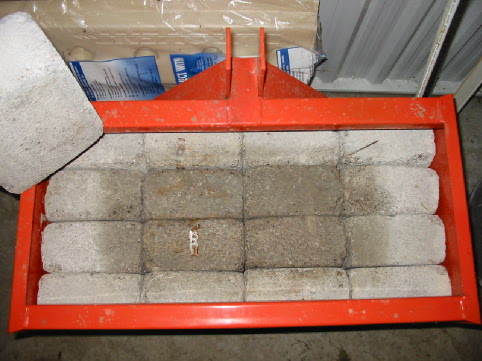

I got this ballast box with my B7800 and put these retaining wall blocks in it .Holds 19 of them easily and they weigh 25 pounds each. Could fit a few more in if you stood the top row on edge.When I take it off, I set it on a wheel dollie (made for car hobbiests) and wheel it into a corner and out of the way.
