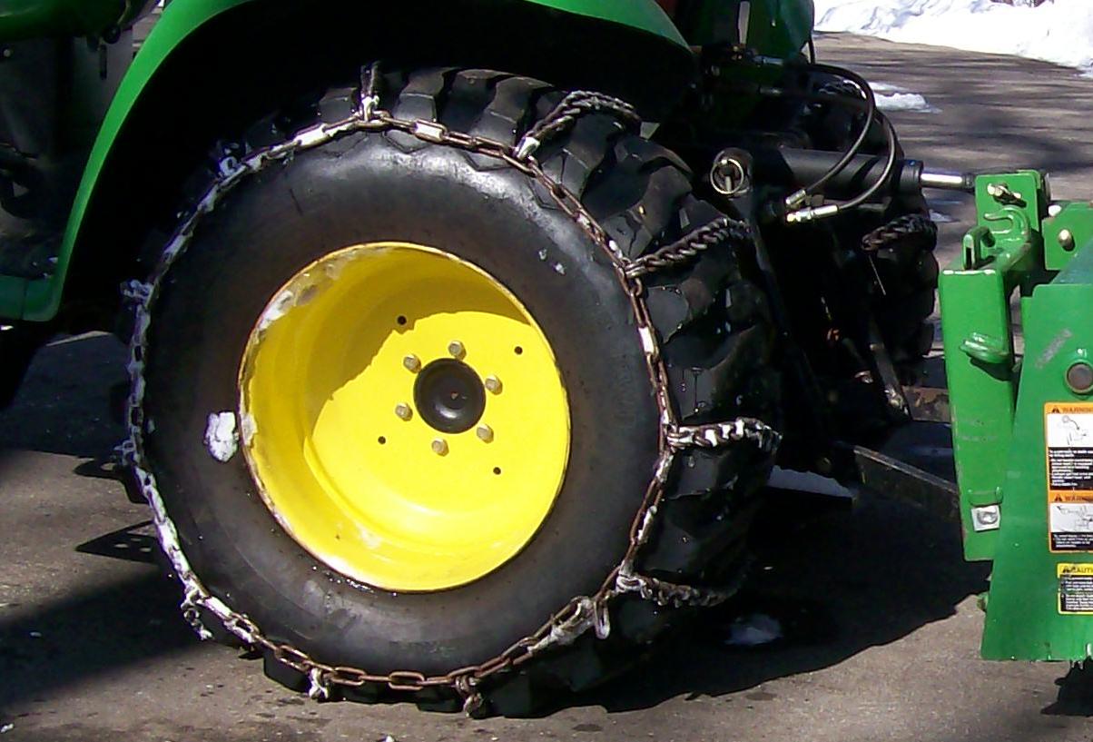

Thanks for the info. I didn't think about chains doing damage to driveways but you're right in that I should ask. What type/style chains should I get? I've looked into a little bit. I know one thing I sure don't want any part of the chains flopping around doing damage to the fiber fenders. I could see them getting beat to death with a wayward chain. How much weight will a ballast box hold?
Chains are your answer.
These don't flop around, and they work very well.

Here are the chains I have. They have DOUBLE the cross bars, because the cross bars want to fall in between the lugs on the R4 tires. Mine have V-bars on them, and EAT the driveway! lol
They are insane in the woods, I use them for skidding logs out! :thumbsup:
The tensioners keep them from flopping at all, and they have NEVER touched my fenders yet.

Do you have any trouble with the chains falling inside the treads thus making them ineffective?
