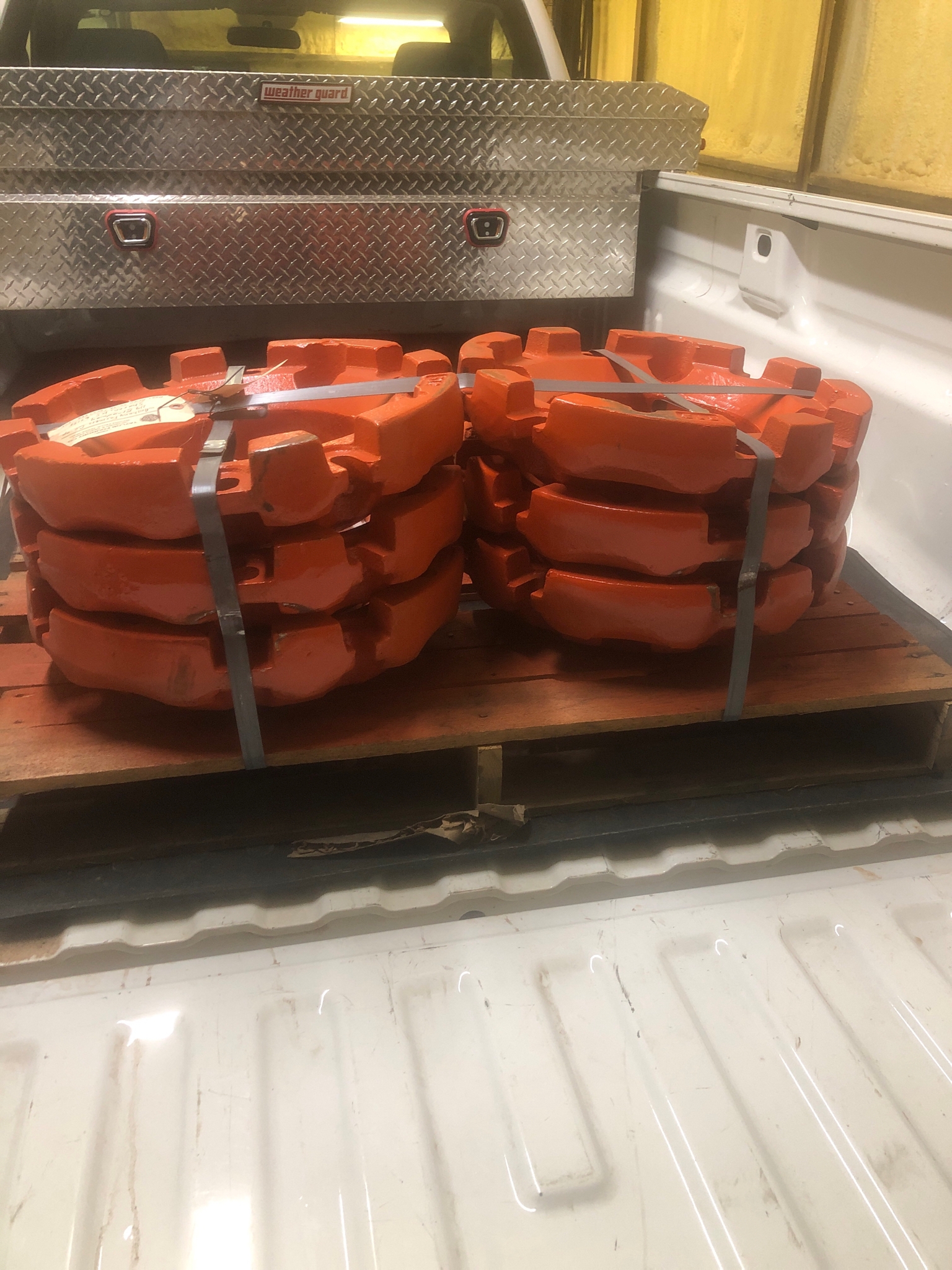

Should have bit the bullet 10 years ago but I didn’t until now. Didn’t want fluid in the tires so I bought 6 107# weights for my kubota L 5740. View attachment 3172095
Did you have any ballast previously? Filled tires, for example?
I had filled tires on my 5740, but it was still light in the rear with a full bucket load of material. I added wheel weight, so now have both and it makes a huge difference.
Every loader I have ever seen REQUIRES ballast, and exactly how much or what combinations are spelled out in the manual.
/ Rear wheel weights
#32
No fluid, just always had something on three point when using front end loader, still plan on doing that with the weights.
