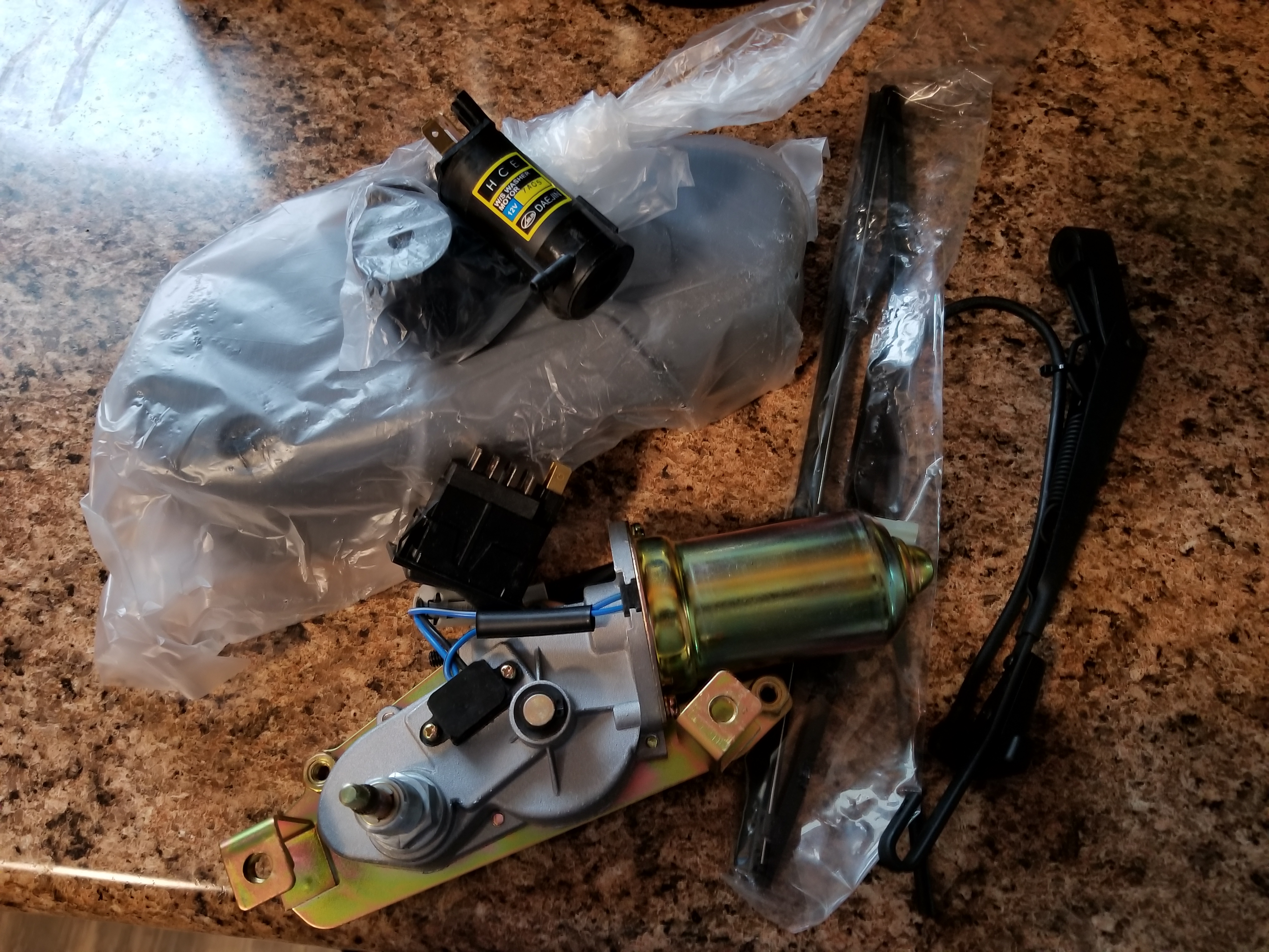

Has anyone here installed a rear wiper kit ,?

Mine came with the rear wiper so can't say I've installed one but it should be a fairly easy install with the factory wiper.
   / Rear Wiper install
No, I have not but you should be able to do it all the wires are there , you need to install the switch and wiper motor . Other members here have done it on other tractors The dealer does it can't be that hard :)
If the harness is install it will be a quick and easy install , Have Installed on other brands of cab tractors require removal of cab top , not a big deal either way just wondering what I'm facing have kit on order ...

I thought all the cabbed LS machines came with the rear wiper. Cant say I have ever seen one without it.
Anyway, the top comes off easily and the wires should be right there. Think about upgrading the stereo speakers while youre in there.
I have already upgraded speakers , good to hear the wireing harness is in place....not all come with rear windshield wipers. Haven't really needed one until this year . ...any advice on blade replacement

Actually nothing wrong with saving money , however a John Deere wiper motor installs different than the XR series tractor wiper motor.....been a while since I replaced a JD wiper motor but was thinking it bolted up to cab top , not mounted on the windshield like the XR LS series....I could be wrong it's been a while since I worked on a green or sometimes yellow tractor.....

Part number 20140820 (M05-1-01)
Motor Assy-wiper (Combo SW)

Rear Wiper moter was a easy install , Have yet to install washer, seems to be a exter hose at tank...didn't see wireing for pump but it's probably there....kit came with washer motor not for sure if. it will install in present tank...has anyone here installed a rear wiper kit ? Motor, arm,switch and blade are installed ten minutes tops ... all that's left is the washer...don't think it will be to bad , but If anyone here has installed one I have a couple of questions

Completed wriper/washer install on my XR4040C /A rather easy install , all wiring and washer fluid hoses came installed from factory , the wriper kit came complete with the exception of a coupling to connect hose from wriper to factory Intalled washer hose from cab... the washer fluid tank supports two pumps (rear pump comes with kit) so you have a separate washer for front and rear ...note: when Installing wriper/washer switch there is no need to remove side post just remove blank cover pull out the plug and connect to switch and snap switch back into place ...there are two unused terminals at the top of the switches ..one plug contains wiring for wriper and washer...

Easy install , nice thing about L.S. - O.E.M. wiper kit is every thing fits ...it is plug and play really cuts down on the cuss words.
