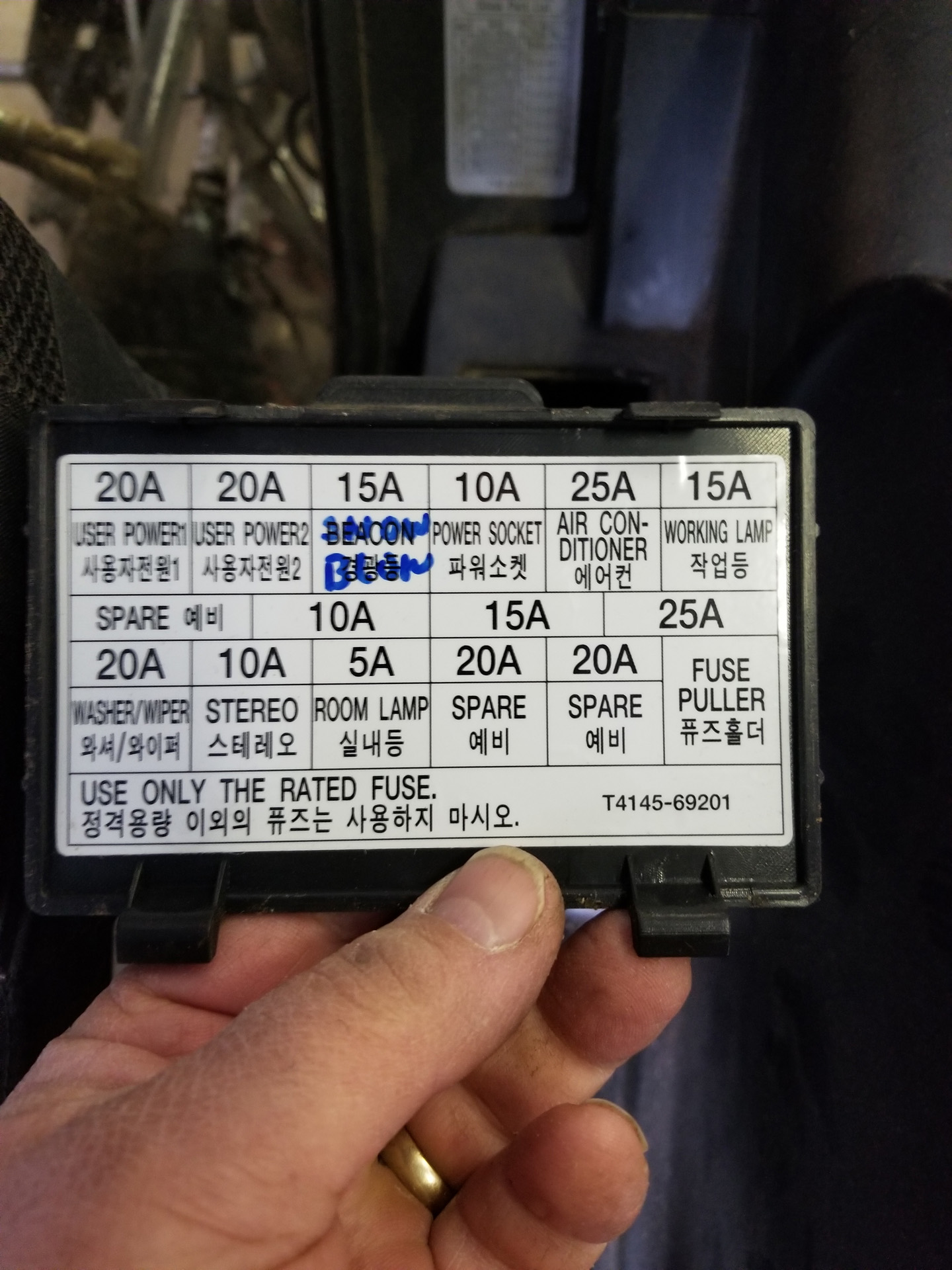

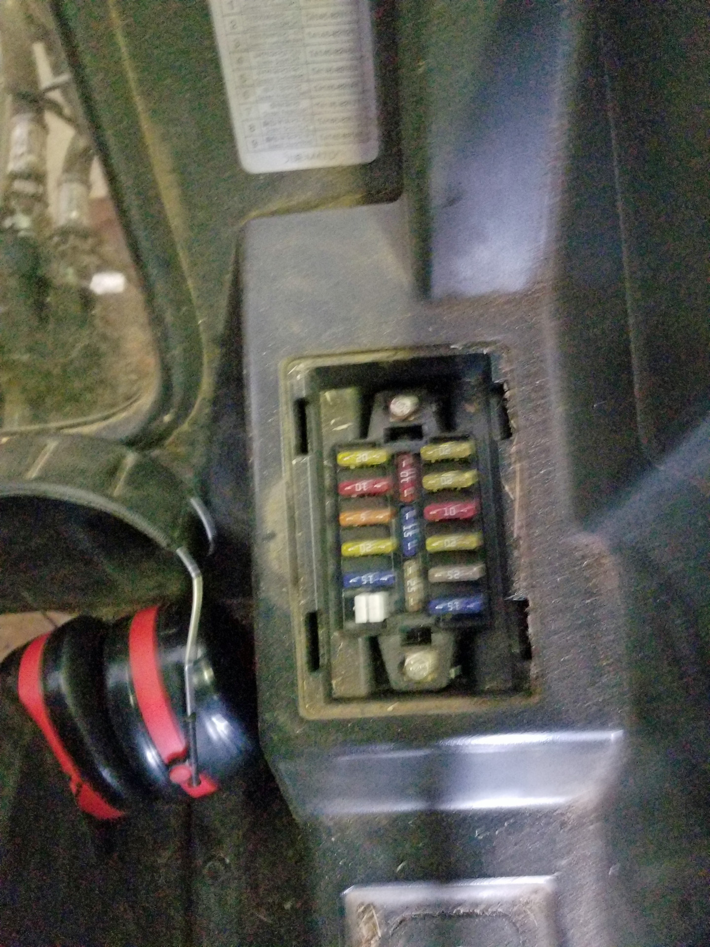

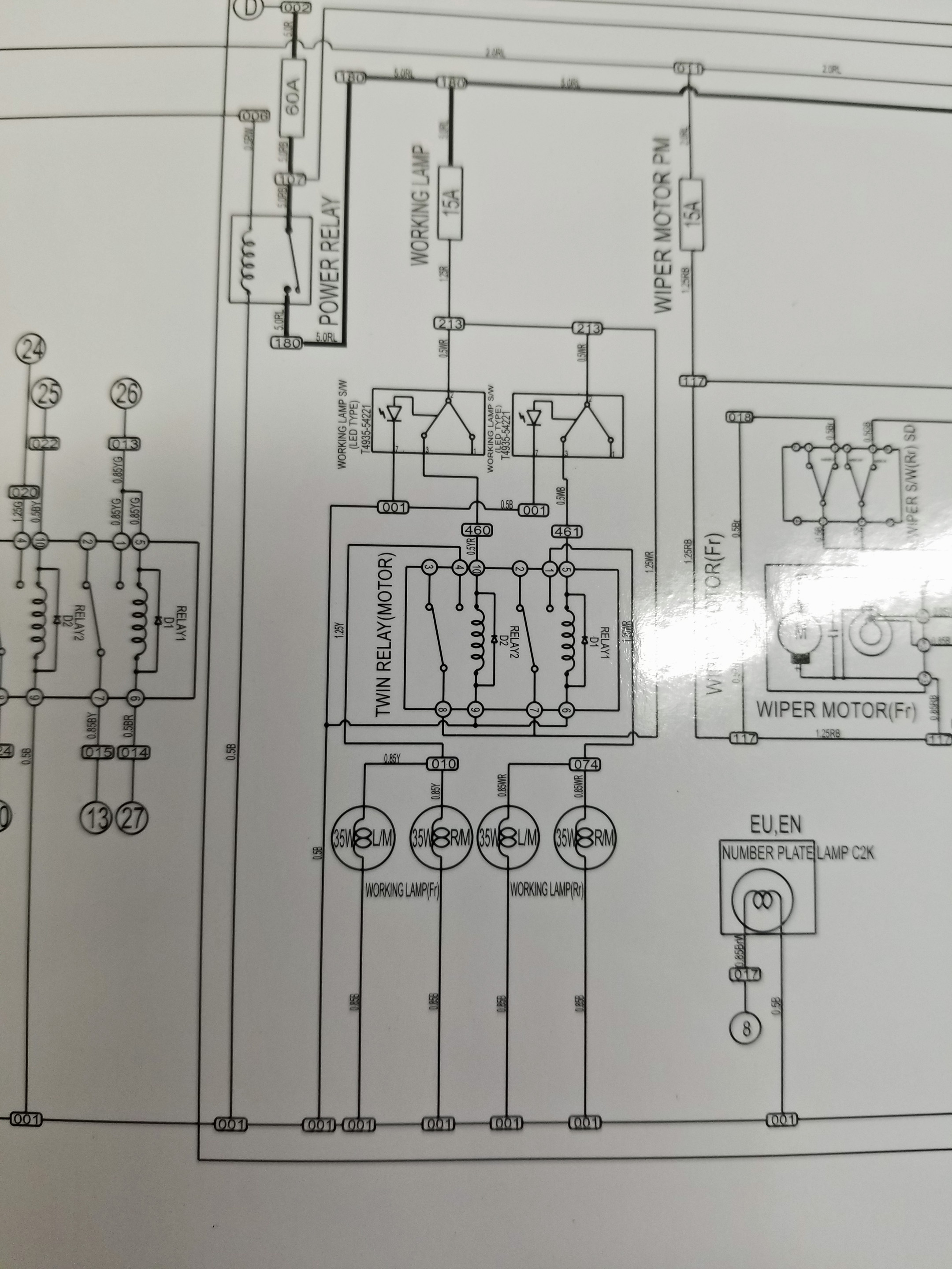

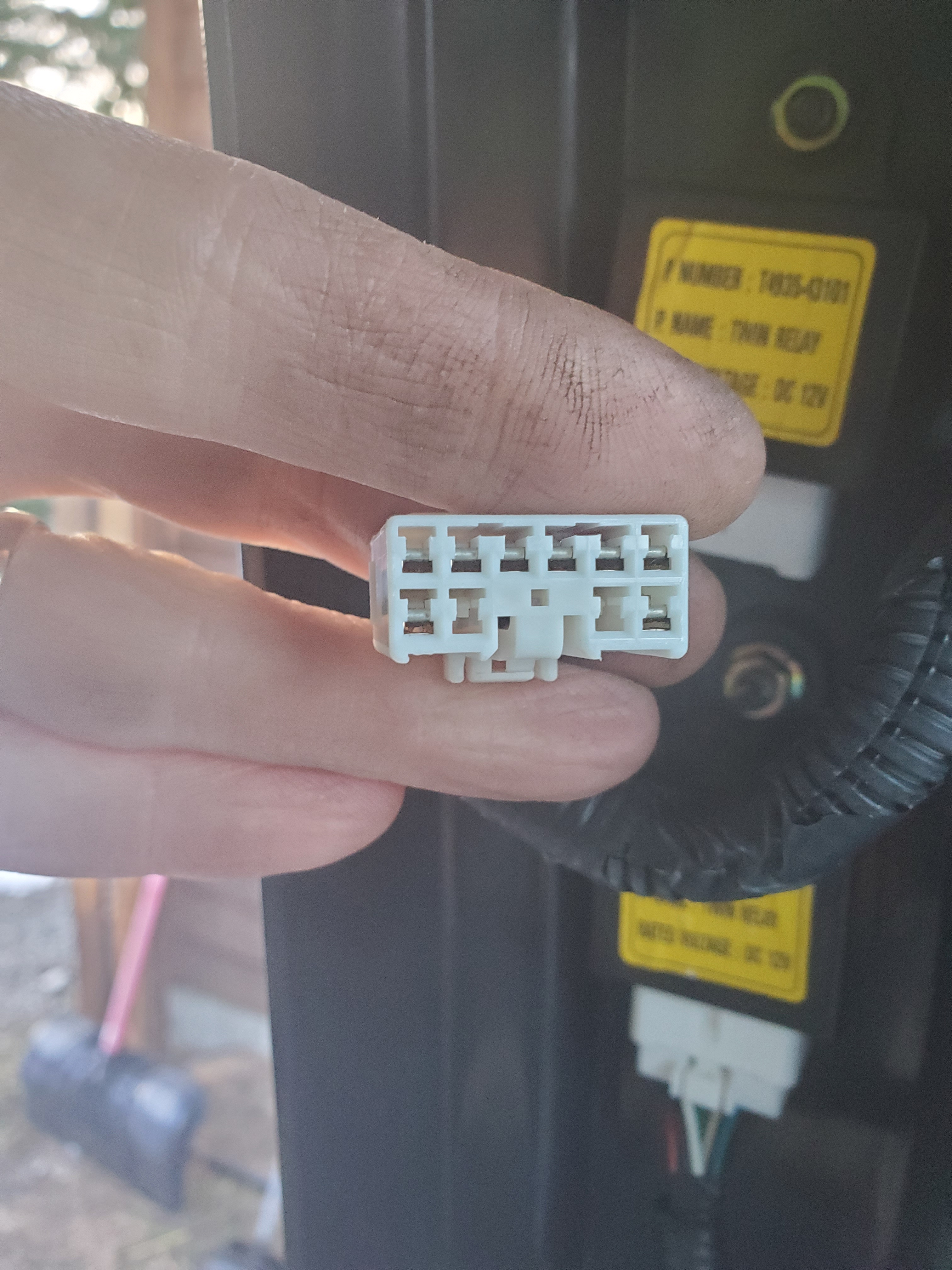

ok. after looking at my tractor and my shop manual, i can tell you some things on my 2010 DK45 cab. first, pulling the working lamp 15 amp fuse kills the rear lights. second, there are 2 relays located on the right hand cabin pillar that control the lights. i have included some pics. so the switch controls power to the relays, and the relays power lights. 1.jpg this is the fuse label. working lights is the lower right 2.jpg when i pulled lower right fuse lights went out. 3.jpg heres the line drawing from shop manual that shows switches, relays and cabin lighting. 4.jpg this is the cover on the right piller that has to be removed. im not sure, but i think its the piller cover with the cigarette lighter socket that is the one needing removal, but the book is vague about which one to remove. 5.jpg these are the 2 relays. 6.jpg these are the relays detailed
there twin relays, so if 1 part has failed (rear lights) the front part can still be working.

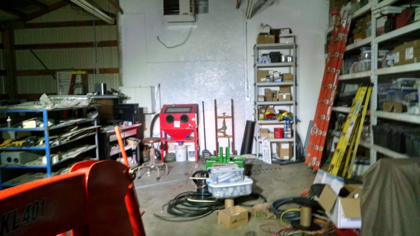

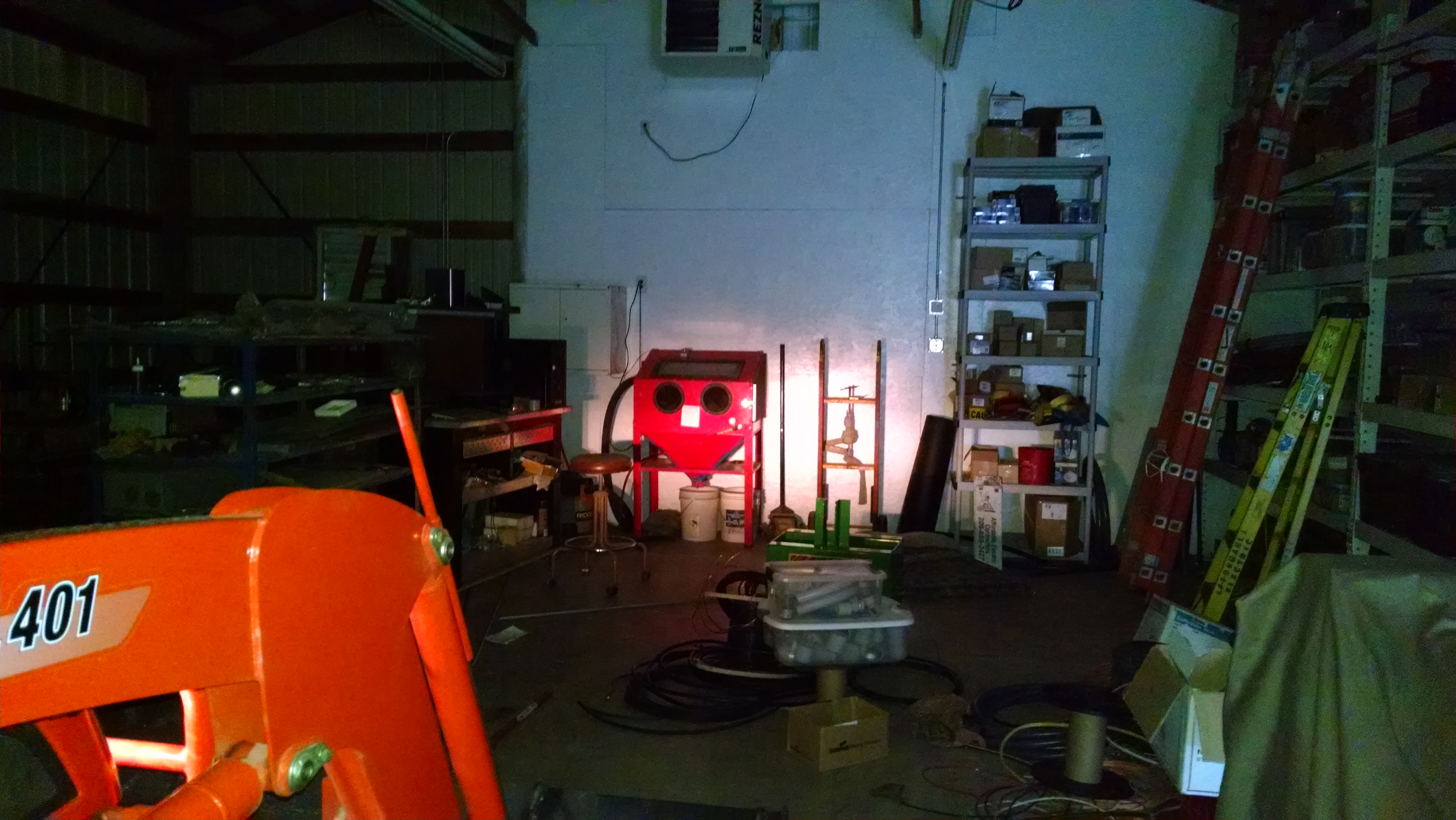

years ago i pulled off all 4 cab lights and changed them out to LED. way better lighting. but no heat is produced, so sometimes snow builds up on them.front light reduced.jpg front lights reduced.jpg. this is before led install orig lights reduced.jpg
this is after led install led lights reduced.jpg.
only sucky part, you have to raise the roof of the tractor cab to access lighting brackets and wiring. whole job took about 3-4 hours as i recall.

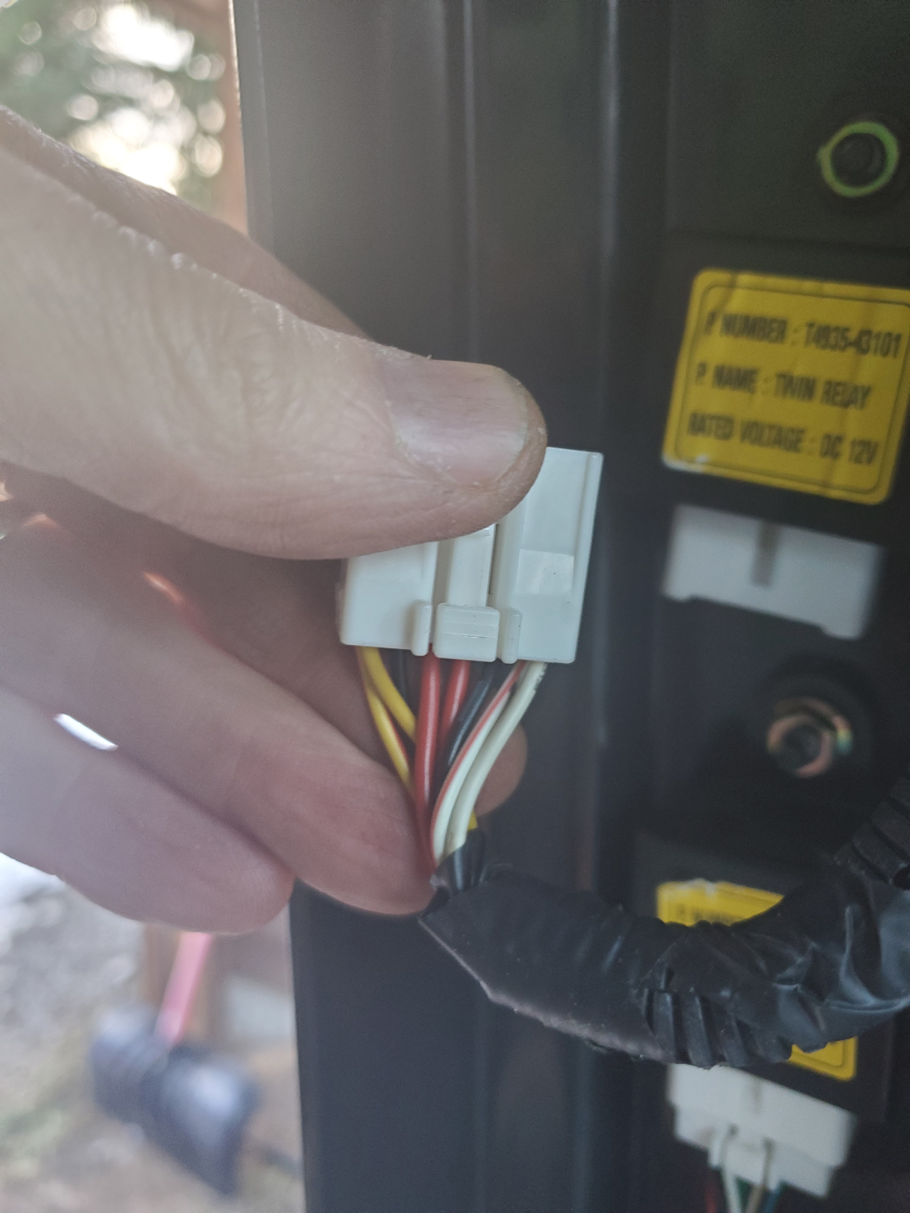

I've got the shop manual but finding the relevant pieces takes understanding their logic (or lack). Now I understand why I couldn't originally find the cabin fuse box in the manual, I went to the index and sure enough, the index only references the main fuse box and doesn't list the cabin fuse box page at all. Guess I need to read complete sections.

I tested at the rear work light and there is no power, as I suspected.
I took off the pillar and found the work lights twin relay. This is where I realized that I don't really know what I should be testing.:D
Looking head-on at the white connector, there are two rows of pins. The wires behind the pins are as follows:
YBRRBW
Y****W
With the front work light switch on (ones that are working), Yellow to Yellow has power and the Black and Red on the right side show power.
With the rear work light switch on (ones not working), the Black and Red on the left side show power.
I didn't test all combinations and didn't know what to test on the relay itself. Any advice on what to look for?
If not the relay (and how can I tell) ... what can I test next?
Thanks in advance for your help.

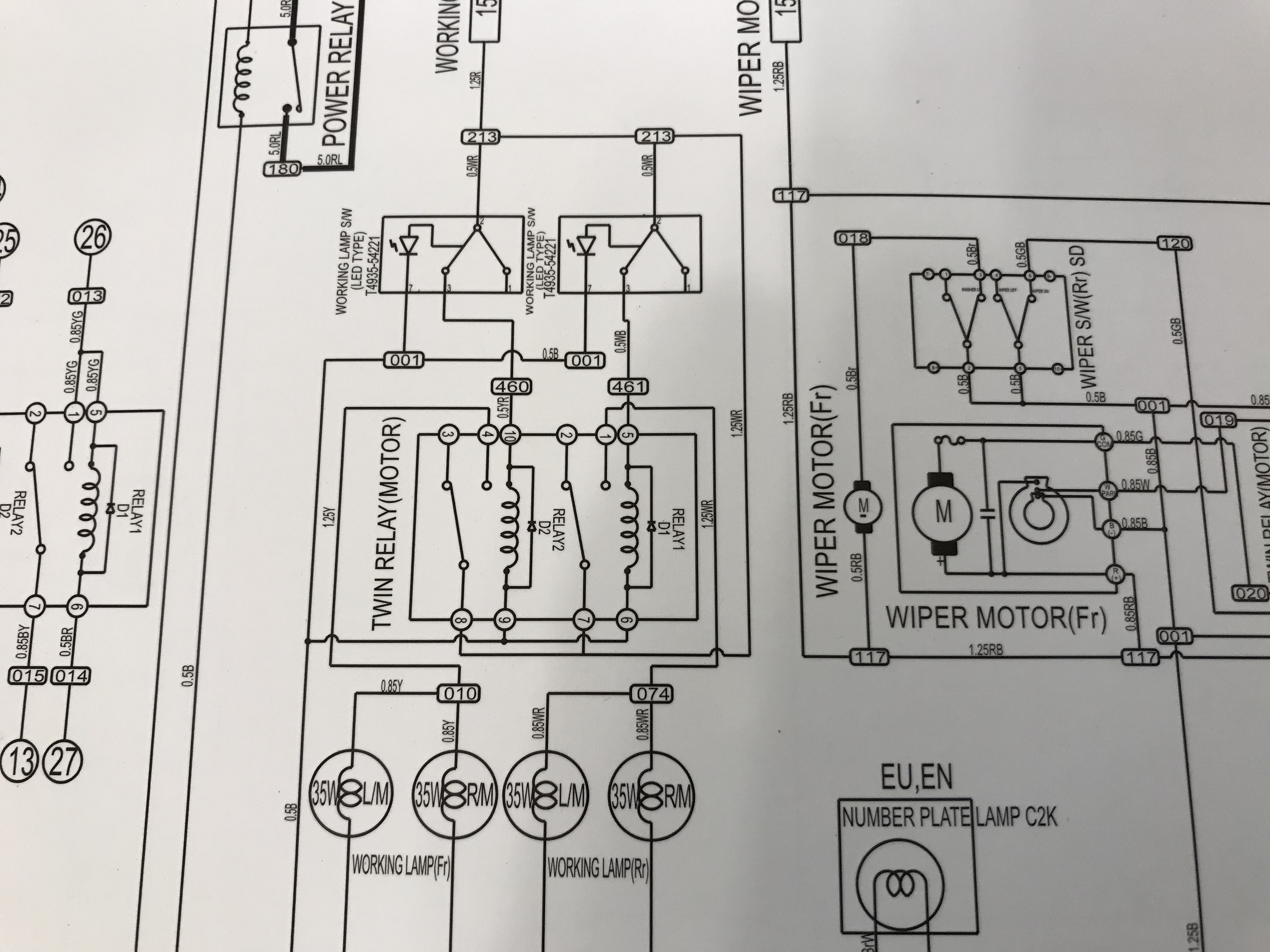

3D0F4E4A-EB1F-45ED-B728-5A44CD1D17E4.jpeg going by this diagram, there should be 6 wires on one side of relay and 4 on the other. Either wire #4 or #1 go feed the lights. It looks like the use the same twin relay for the wiper motor, so i think you could just swap the 2 to see if thats the issue. Your wiring looks different from the schematic. The book is for a 2010, not sure what year yours is. Im not really sure how to test a relay except for slightly pulling connector out so pins still touch, then testing wire #4 and #1 for 12 vdc ( with black test lean on a known good ground and red test lead touching pin #4 or pin #1) as you flip switches.

Actually, the schematic is correct and I found the same one in my manual. Since there's only 2 wires fed to one side of the relay (the side with 4 in the schematic), I didn't show the two empty slots. Anyway, your idea of using the wiper relay to test with was brilliant. Front and rear lights worked just fine with the wiper relay, so I'll be ordering a replacement from Tractor Joe. Their price isn't bad for the relay ($30), but shipping is a killer ($18). Couldn't find a better site, though.
