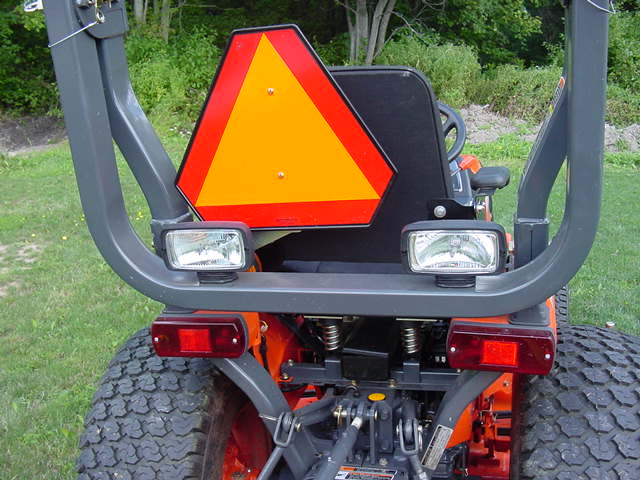

Here's what I did on my b7500.

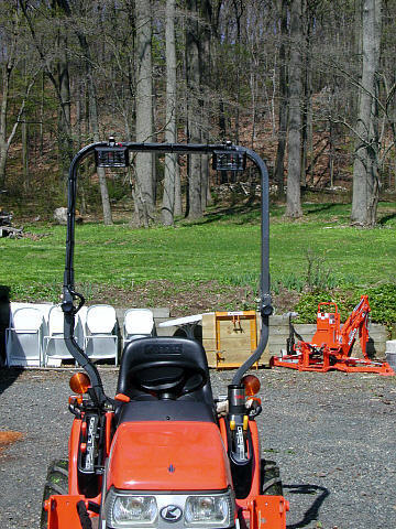

And my solution...(see attachment)

   / Rear work lights #4
Hey Chris did you drill through your rops to mount the lights ?
It looks like a very clean instillation.the lights work foreward when the rops is raised and in reverse when the rops is lowered. Good idea. Doesn't it weaken the rops by drilling through it ? At least that is what the manual of my bx22 tells me. thanks for posting the picture I also would like lights on top of my rops the headlights don't work well when operating the loader. Did you need the high capasity generator to run the lights ? David.

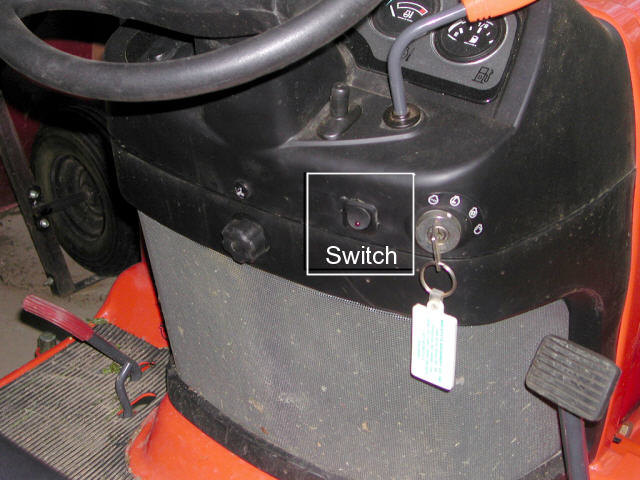

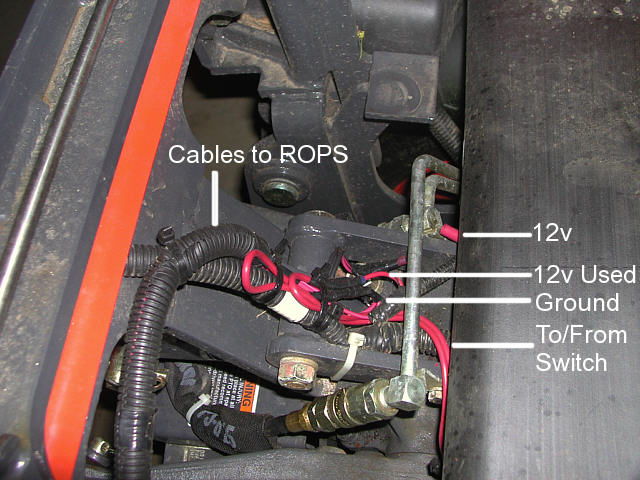

   / Rear work lights #6
There is auxiliary power right down under your seat...it's there for the factory aux lighting kit. However, you'll need to rig up your own switch for the lights when you install them.

   / Rear work lights #7
Here's a pic of the power source...

One small recommendation- hang your work lights from under the top of the ROPS. That way, you don't bash them around as much when you drive under trees. Mine on top take a lot of abuse. I am going to change mine around when I get a chance.
Good luck.
