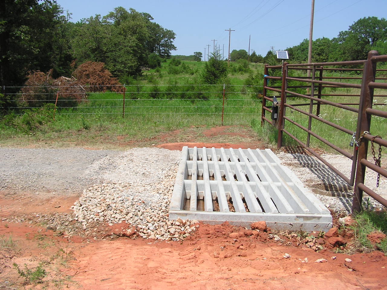

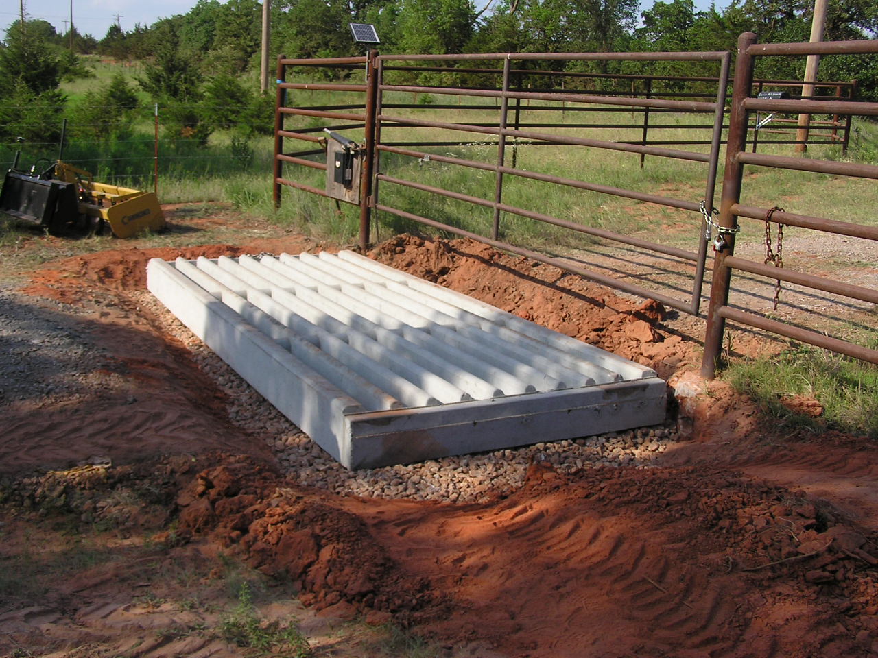

My 16x7 Precast concrete was cheaper than steel pipe.

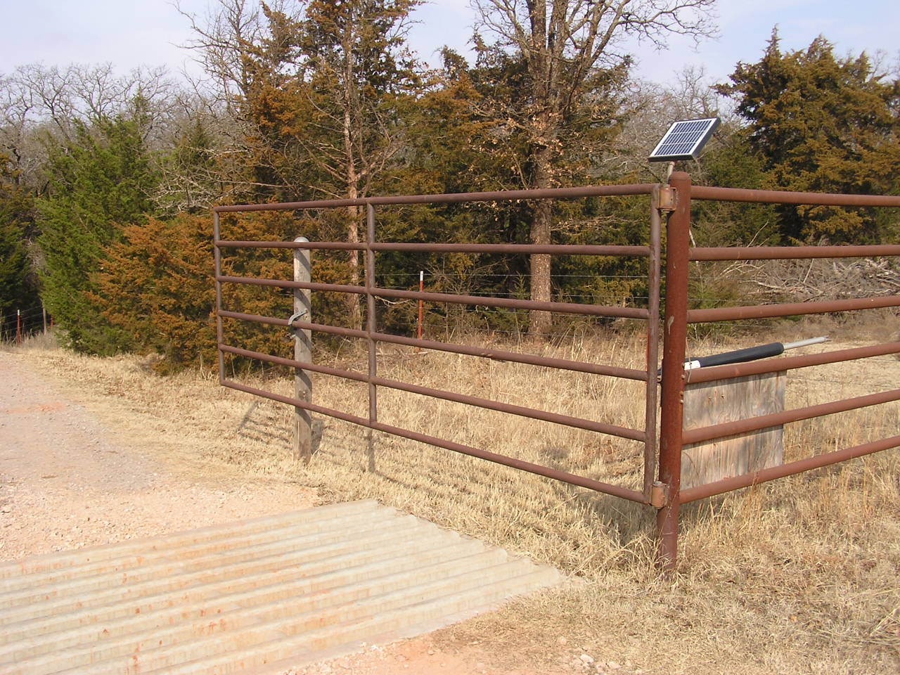

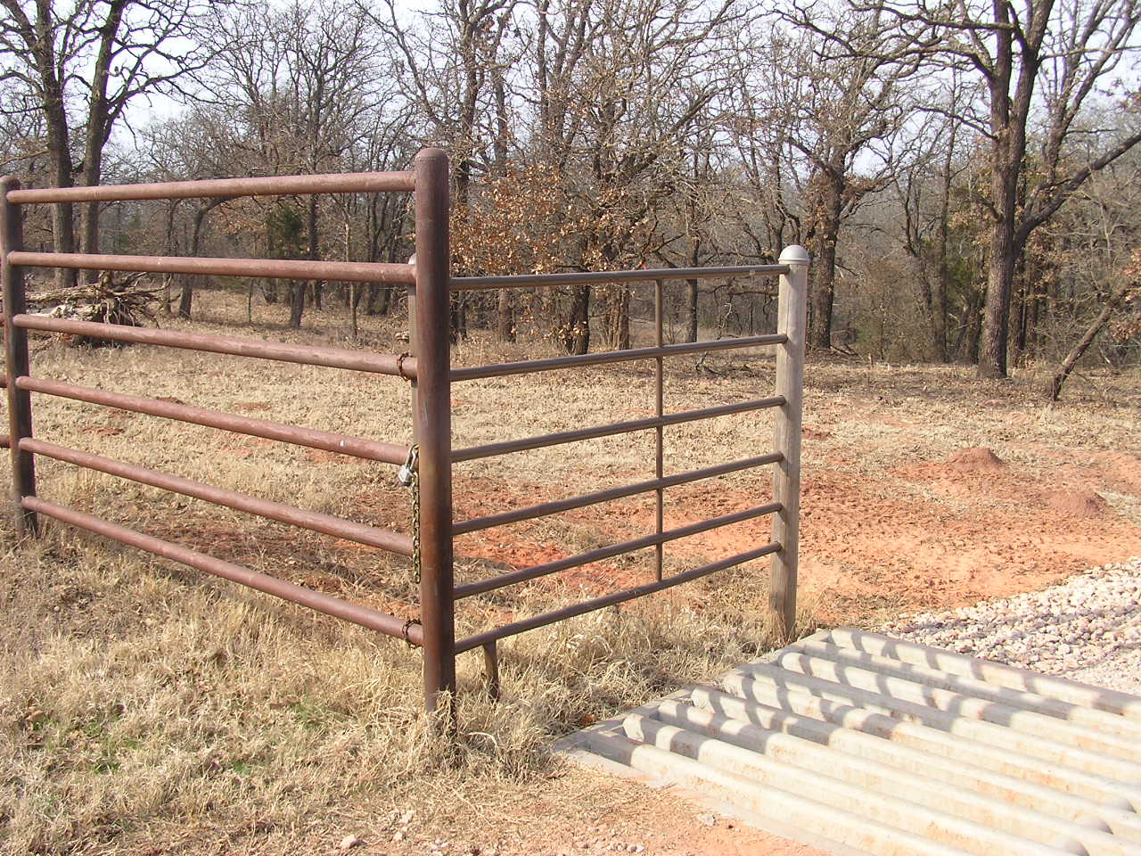

Found this one on craigslist.

I always put my CG so the fence line hits the middle and they have a side or diminishing side like the crags list CG. Are you going to put a barrier at the corner so the curious calves don't escape?
   / Rebar cattleguard #50
Could not put it in the middle, too long for the gate opening.
The gate blocks escape on one side.
Cut off a damaged panel for the other side.
