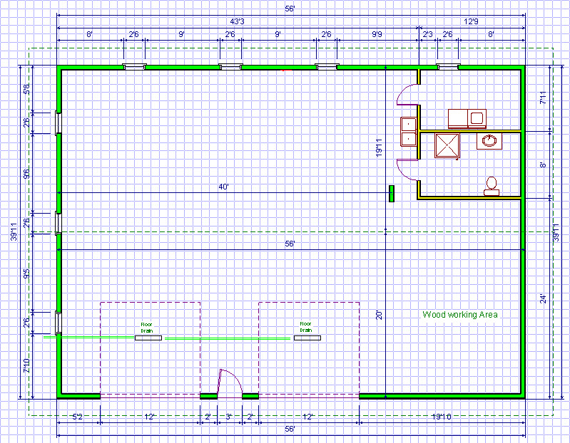

Raspy, thanks for the photos. I've been doing some of the layout on my own. Included is a photo of what I have so far. Not sure what I had posted earlier, but I'm using 3/8" rebar on 12" centers and the pex will be placed on 12" centers. In the photo there are two room in the upper right. The first will be easy to lay out but the second is a bathroom and it will have a toilet and shower that I will need to work work around. I'm think of using only two loops on the right 1/3 where the rooms are located with the pex running vertical instead of horizontal like on the right. Between loops 1 and 2 there I have an area I'm going to work around for a 2 post lift in the future. I will frame this out special and have the cement about 8" think for these two pads.

Wedge,
Let's be sure we are talking the same language here. I define a loop as one run of tubing from the manifold and back. A zone is an area controlled by a thermostat. It can have any number of loops. Some rooms might have more than one loop, but the loops should be set up to only heat one area. In other words, a given loop only heats one room, but runs of tube, to and from that room, can travel through common areas. That's the way you show yours and that is good. then you can balance the flow to adjust the heating level in all the various areas. Bedrooms can be cooler than kitchens and warmer than storage rooms, etc. If you use 1/2" PEX make your maximum length 300'. 3/4" can be 500' max. Or mix and match for different areas. A bathroom might have 1/2" tube on 6" centers with 150 linear feet, and a shop might have 3/4" tube on 12" centers with 400 linear feet. Try to make all loops about the same length if practical, or near the same restriction with different diameters. If you have a small room with a 150' loop, do the larger rooms with (2) 150' loops, etc. Once you get this more or less worked out you will know what manifold to get. A manifold with one more set of outlets than you plan is a good thing because you can add one more loop or make a short crossover from out to in for stabilizing the flow and temp.
No need to run the tubing under any cabinets. Keep it 10" or more in front of the toilet pipe, no need to go behind it. Don't put it under the refrigerator. Closets are optional. Pantries are optional. Be sure to put it where your feet will be in any office spaces or work stations near machinery. Be sure it is in pathways. Run the tubing into and out of each room by going through the door, if possible. This frees you up to drill under floor plates and it makes a warm path through the door for walking.
Try to arrange the bar or the tube so you can run the tube along with the upper bar.
Hold the heat back about 1' from the inside of exterior walls.
Near exterior doors you can make an extra pass at 6" and you should also keep the spacing closer in the bathroom.
Route your supply line along the outside wall first and then make your runs across the room that came back and "touch" the feed line as they do their U bend. See it in my pictures.
You can run your sup and ret lines to a given room side by side, or siamese them, as you pass through a common area to get to your destination room. The siamesed lines can run on 12" centers with other paired lines.
Pass the PEX through PVC conduit 90s to enter and exit the slab. 3/4" for 1/2" PEX and 1" for 3/4" PEX.
You seem to show two manifolds. Why?

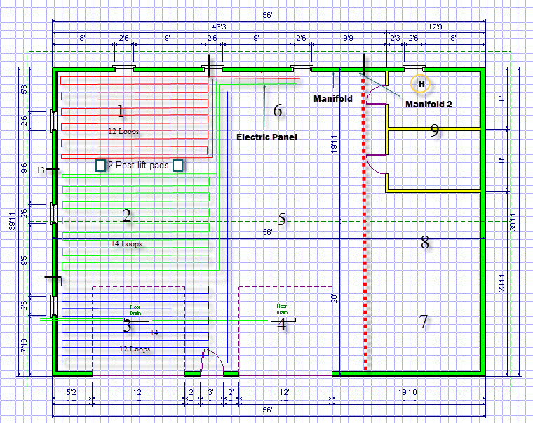

John we are on the same page. I know the difference between a loop and zone. I've been told/read that you should have zone for each area you want to have at different temps. I would like the rooms in the upper right side of the photo to be able to be adjusted separately from the main area. I have been trying to keep the loop lengths to as close to 300' as possible. The lower right open area will be a wood working area so I thought of some sort of sliding door thing to separate that area from the main garage area. I do plan on using all 1/2" pex and right now I will have two manifolds One 8 port and one 4 port. Like said I really just want to get the pex and manifolds ordered for now so I can get it layed out prior to the cement being poured. I live in central Indiana so lately a large candle might heat the garage :D, but once the cement is poured you can't go back and place the pex. I've been dreaming of this barn for years and now that it's started I want to do it right.
I do appreciate the comments and experience.
PS I've added a basic layout of the final design.
Wedge

Wedge,
Bear with me if I'm being too specific.
You do not need a thermostat, which is a zone, for each area you want at a different temperature. For instance, you might have a kitchen and a dining room on one thermostat, but run the two rooms at different temps by balancing the flow to give you a proportional difference. One would lead the other by a few degrees. But you'd want separate thermostats in the bedroom and kitchen because they have different schedules and different heating characteristics. The manifold will have balancing valves that adjust the flow in each loop. This gives the proportion. More flow means higher temps in that loop area. More time means higher room temperature. A thermostat will control a group of loops or a whole manifold that represents a zone.
You can make different rooms, that are running on the same thermostat, run at different temps. That is why I'm being so specific about your design. Do you need more than one thermostat? How will you control the various groups of tubes?
If you want more than one stat, you can still have one manifold if you control the individual loops with telestats. This gives the best flexibility and means you can switch rooms to other thermostats with a very simple wiring change.
The maximum number of loops per manifold is usually 12. More than that will mean another manifold.
Remember, 300' is a recommended max for 1/2". Shorter is better.
Looking at the pix I sent, you'll see I went with 3/4". This is not normal, but means fewer loops, more tube area per sq. ft. of floor and a much more durable tube than 1/2", to get you through the pour without damage. You might consider it.

John I understand and do appreciate the details. I want to have two area's heated at different temps or maybe even the same temp at different times. I did a quick look at the difference between 1/2" and 3/4" pex and it was significant.
Wedge
