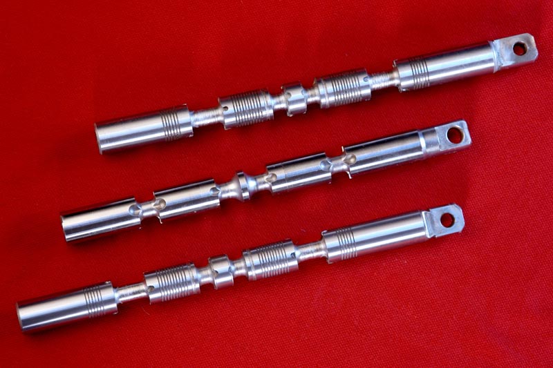

Have you removed the spool to check for debris? Bits of rubber, metal, etc.
With everything removed from the spool, lube it and slide it in the valve housing and see if it is binding, or hanging on anything. If you mark the way it is now, you can rotate it 180 degrees and reconnect everything and check for smooth action.

I have not removed the spool. Excuse my ignorance, but which part is actually the spool?

Thanks all for the help. Great advice. After further inspection, it was rusty crud in the spool cap that was binding the joystick. And as y'all advised the magnet was a good idea as I learned there are 5 ball bearings that want to roll out. I got it all back together and it operates smoothly now!
