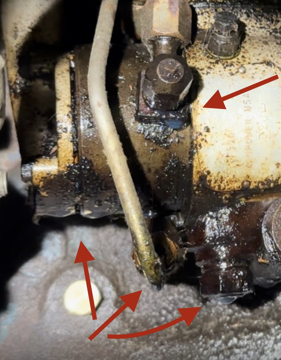

Today my injector pump started leaking pretty bad. I’ll have to clean it up to try see where it is coming from. It is dripping pretty good so…replace or try a rebuild kit? You’ll have to excuse the dirty tractor. It’s new to me. Ran it four hours before it started leaking. Does anyone know the actual kit part number? Vintage 1973

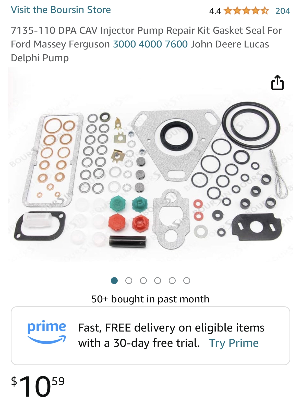

Welcome to TBN. Have it rebuilt or DIY here is the kit 7135-110

That’s a DPA pump previously made by CAV..
Delphi now..
& yes, the kit is 7135-110..
Depending on where it’s leaking, it’s either a diy or it’s not..

It is leaking from the cover on the left and the banjo bolt on the side. The other two lines below are dripping but easily can be from the leaks above. It is the cover on the left that concerns me.

The cover is held on w 4 5/16 screws.
It’s sealed w a square cut oring found in the kit..
The banjo bolts that r leaking r sealed w a teflon crush washer, 1 on each side of the connector.. they 2 come in the kit..
Ur probably better off taking it off and sending it out…

Anyone have pros cons of using the Amazon rebuilt kits?
