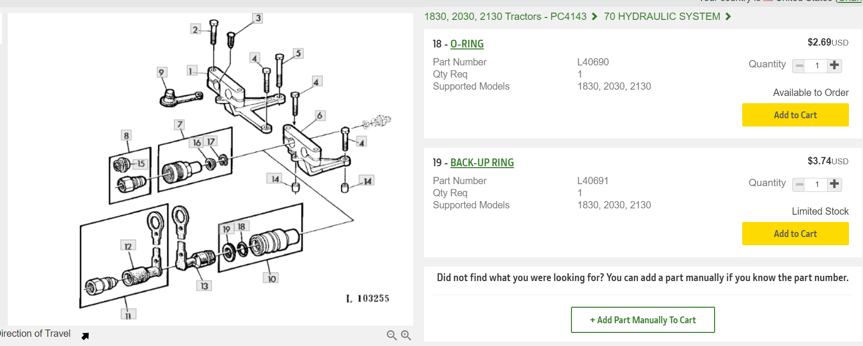

Not to hijack a thread but my 2130 scv is leaking a small amount. In parts it shows the lever but mine doesn’t have levers. You just push the receptacle rearward through the block and connect the male hose. Not sure if it was meant to have the locking clips/levers? They look genuine and are still the cone shape from the 30 series era.
   / rebuild selective control valve, JD 750 with 67 loader #7
My guess is you're referring to the economy type breakaway couplers offered as an option when your tractor was new. You probably need to replace o-ring(item 18) & backup washer(item 19)

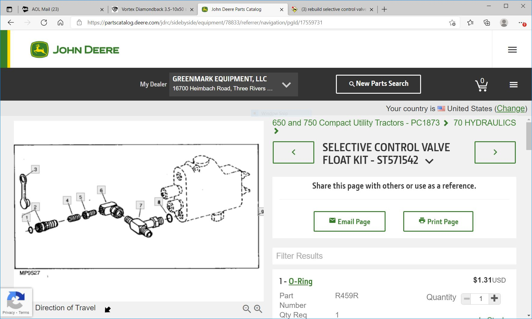

Have you looked on JDparts?
   / rebuild selective control valve, JD 750 with 67 loader #9

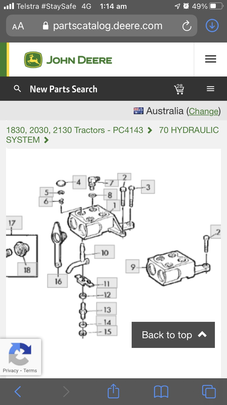

Sure have Zebra. This is what I found.
Also shows this one in my tech manual.
I never knew there was an economy component option.
I guess it will be easier to rebuild as reading shows people have lots of trouble with the small o rings top and bottom of the locking shaft.
Jim, do these economy scv’s work as well or do they have a tendency to remove themselves?
I would think being able to pull out could save me some costly repairs in the long run.
   / rebuild selective control valve, JD 750 with 67 loader #10
Ausmac
I confused as usual. Which type breakaway coupler with "no levers" does your tractor have? Both types are listed in PC4143
