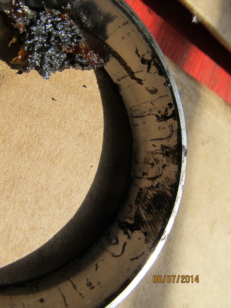

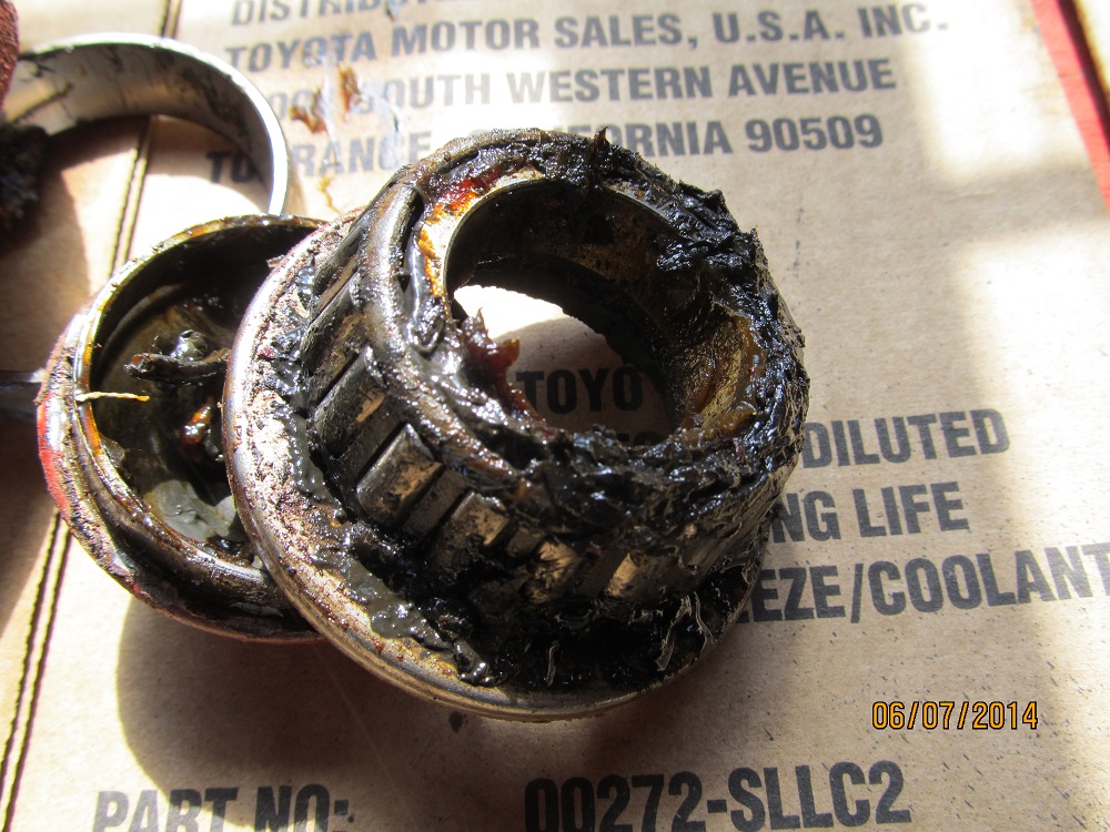

Going to use this implement in a few weeks so time to finish up by packing the wheel bearings and getting the right tires on.

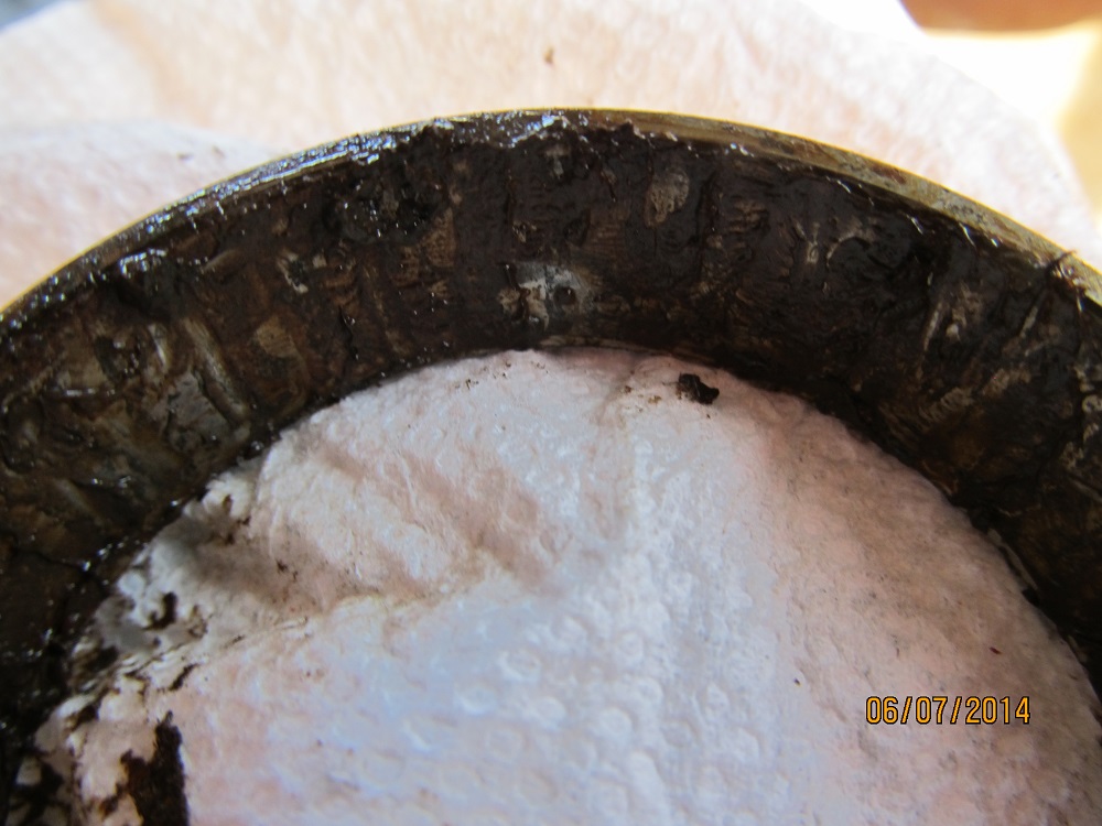

On the wheel bearings, I took them apart and knew it wouldn't look good and was right. Implements left outside with old grease seals lets water into the large bearings and picks up grit. All four big bearings were bad but they're so cheap it's not even worth cleaning them.
Check that crap out. Look at the grit.
This race looks like I didn't wipe it out but I did. The bearing is really scored.
Even races with a little "burn" like this can go bad and I have seen it. A new bearing and race is $9 so why risk it?

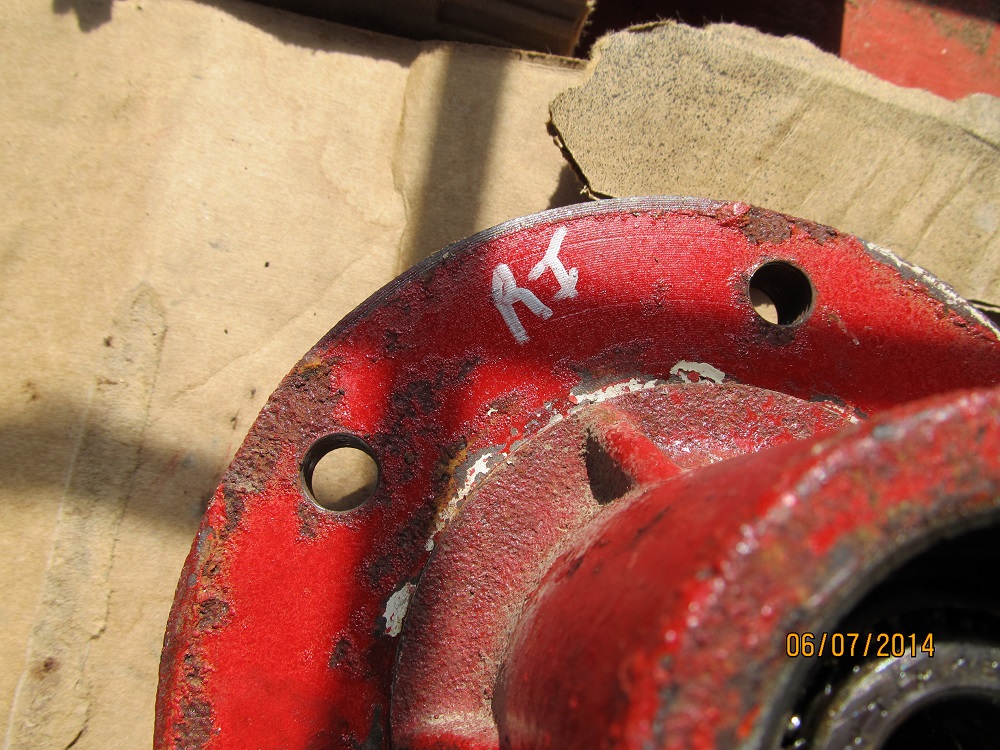

If you try this at home and reuse the bearings, always keep them in the same hub and always label the hub to the place it came from. Old timers told me this 50 years ago and they told me it matters. Makes no difference so why not?

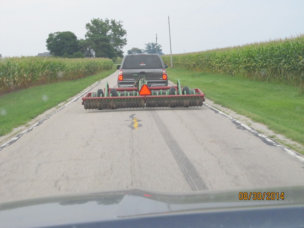

Here's a photo of hauling home after field work. It's about 13' 8' wide and we had to cross a bridge that's a whisker under 14' wide. It took a few minutes, and I really feared getting stuck but we scraped by. As much as I like this one I think I'm going to look for one that's about two feet narrower and sell this one. This one is 12 1/2' usable and I have a separate one that's 8' so a 10' one would still save me time in the field and be easier to transport.

Looks like a nice clean older machine! Did you do the field work with the pickup? just jokin! Tough to tow much over 20 with those old ones as they had to much weight behind the axle. Don't ask me how I know!
Ah, good observation and I solved the problem. I got four 25 lb weights from resale shop--the kind of weight used for weightlifting--and made an adaptor so I could add or remove them quickly from the front of the drawbar. That gives me 100 lbs of added tongue weight and means I could go 50 if I wanted to without fishtailing. I keep it to 35 or 40,however.
I can post a picture tomorrow if anyone wants to see the setup.

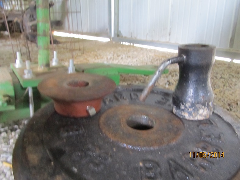

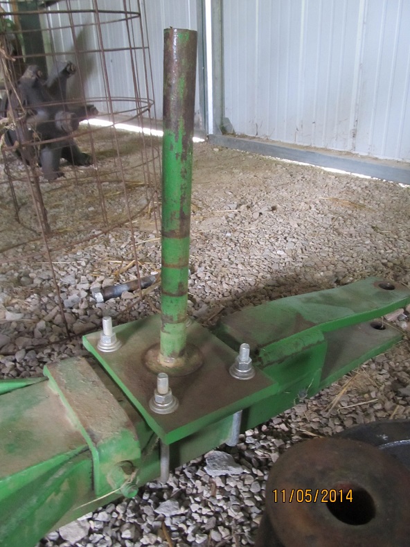

Here's how I did the tongue weight thing. The post is 1/2" plate with a hole punched in it that's the size of the hole in the weights. I set the round rod in the hole, stopped short of it flush with the bottom and welded it in. Got some U bolts and bolted to the frame. The bolt threads sticking up are OK because the spacer shown in the photos allows the weights to clear the bolts. The cap shown on the right keeps the weights in place while bouncing around.
There are four 25 lb weights and I can add whatever I want or don't want in a hurry. This solves my fishtail issue, makes everything safer and can be removed quick for field work. Seems like this idea would work for other things as well. Cost of weights $10, steel, $5, U-bolt $4. Satisfying ride down a country rod at 35 MPH (rather than 15 MPH)...priceless.
Photos below.
