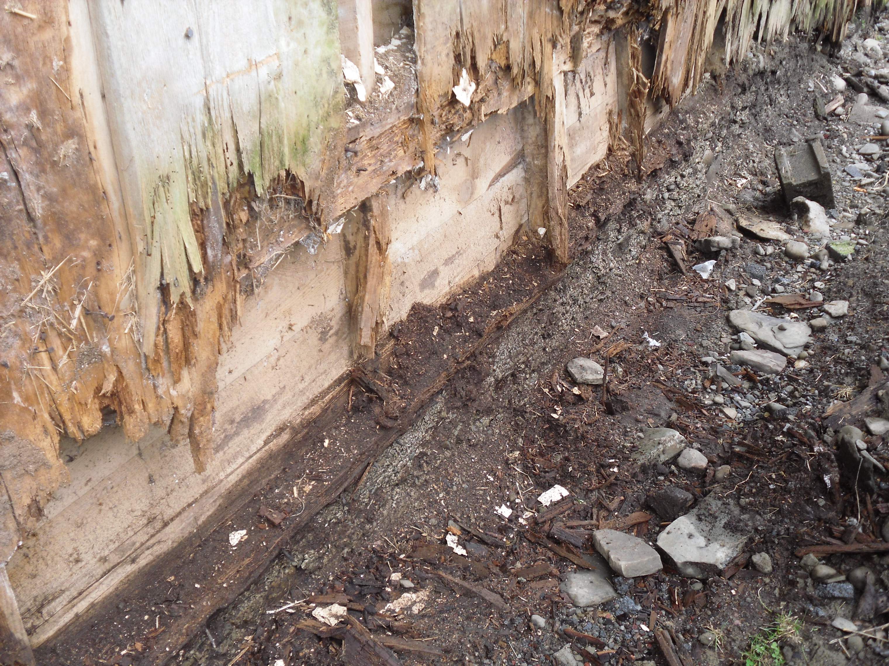

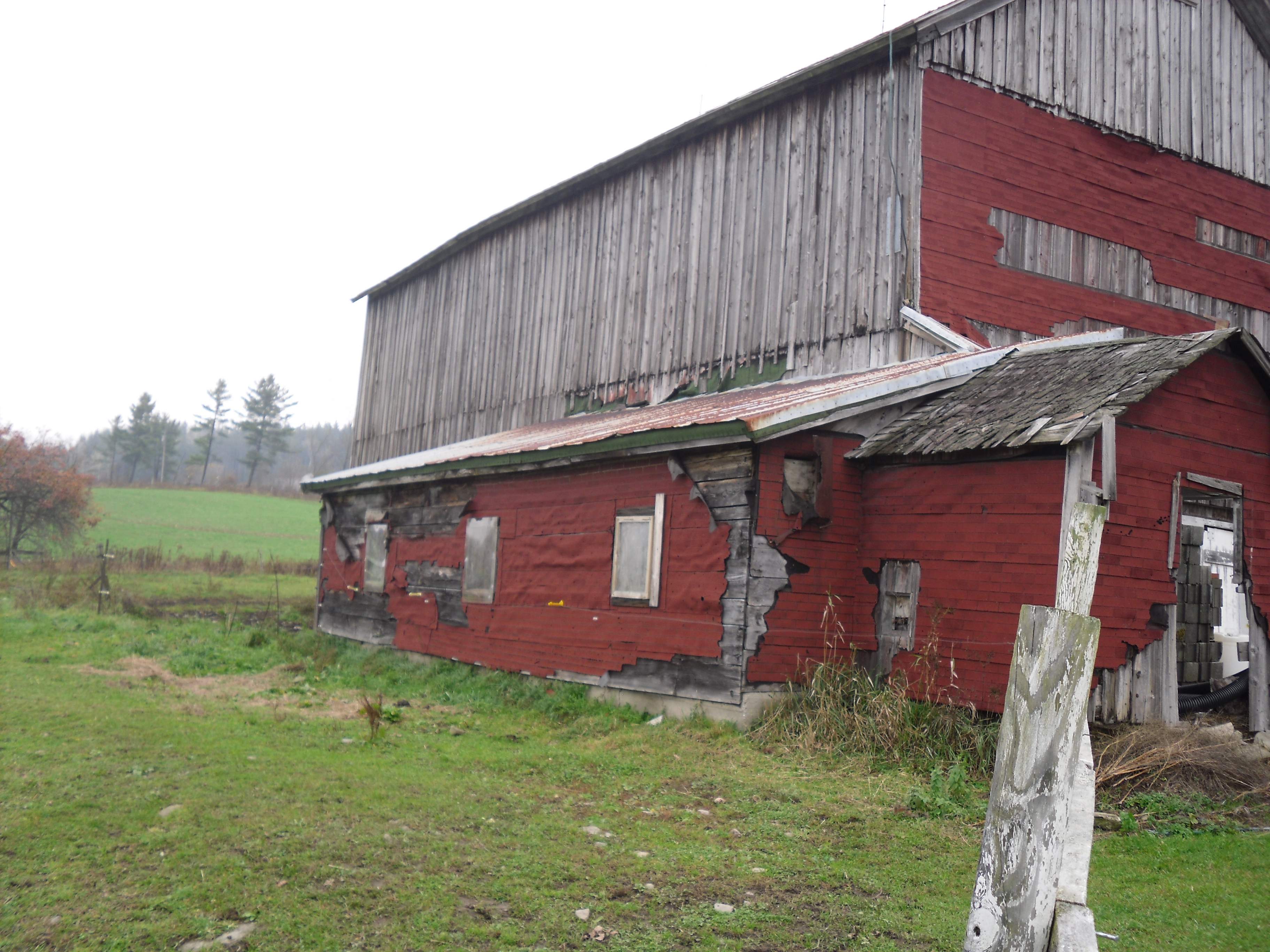

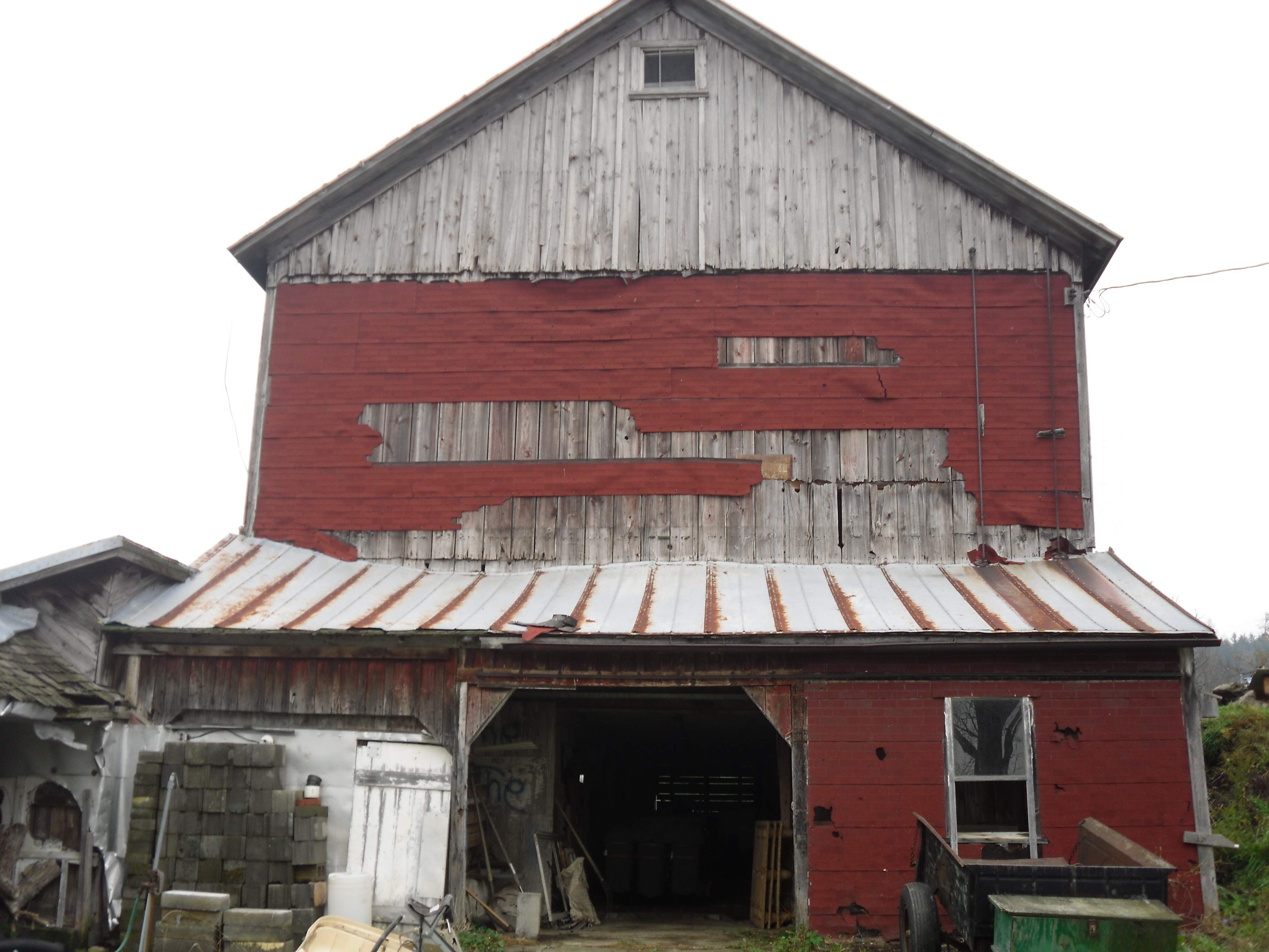

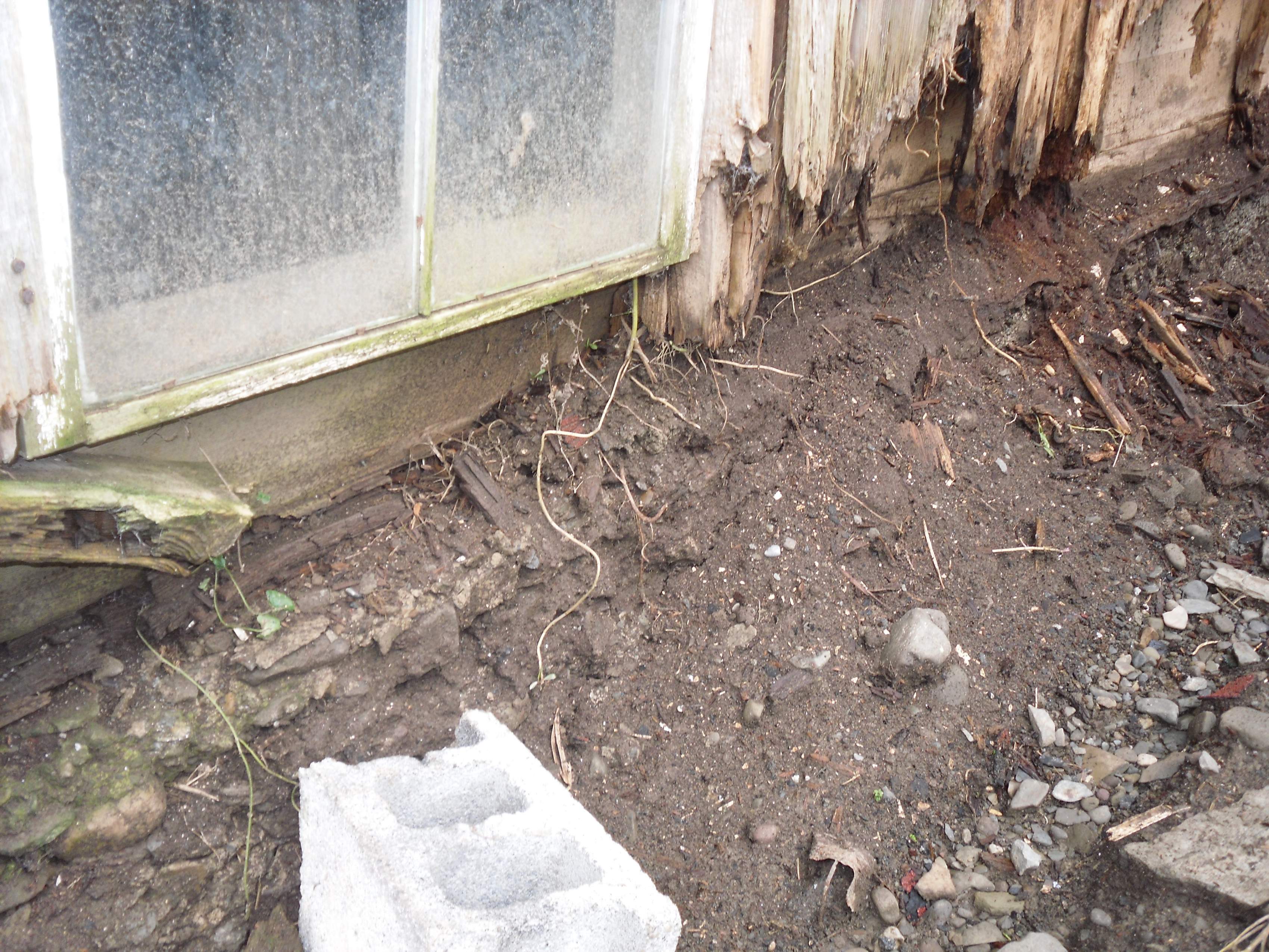

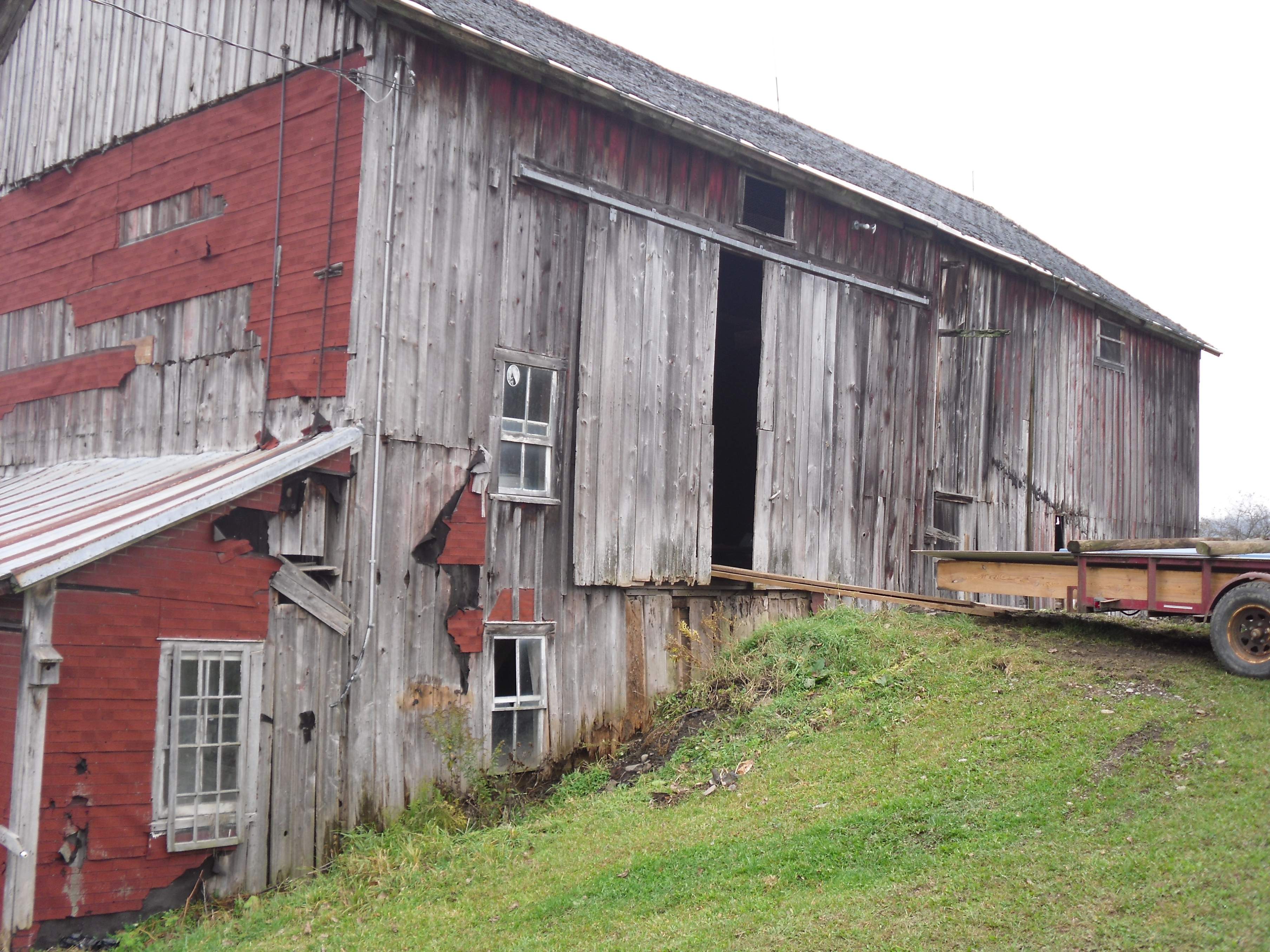

Well I started taking pictures today but stupidly I didn't think to check the battery level so I was only able to get a few before it died.
This is the side that needs the most work
Just some shots of the outside to get a general picture of the building. That goofy red stuff on the exterior walls in spots in like tar paper that looks like fake bricks......been there for years put on by somebody before my parents bought it.
A couple close ups of the side need most of the work. You can see how years of dirt and stuff piled against that wall has really taken it's toll.
I'll try and get some more tomorrow

Wow, that barn looks pretty dang straight to me. I've seen a lot worse structures still being used.... haha. But making it safe and sound is definitely still the right path.
Thanks for the pics.
