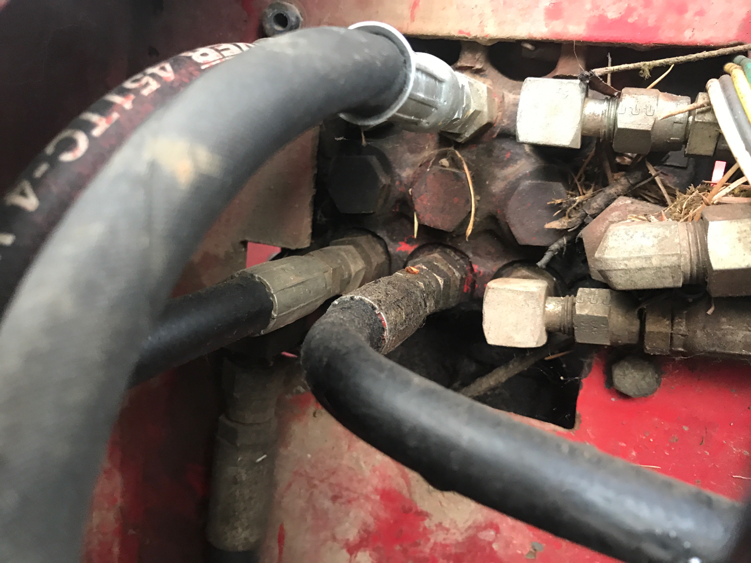

   / Rebuilding / Cleaning lift tilt dump control advice please #5
Those are the ones! As you can see, not the easiest place to get super clean.
I have been trying to remember, but I am suffering from a bad case of CRS at the moment. I think that there is a small piece just behind the hexagonal cap, so be prepared for it to pop out just in case.
All the best,
Peter
Hey peter. Are these the bolts you are referring to? View attachment 659585
   / Rebuilding / Cleaning lift tilt dump control advice please #6
I wonder where the engineered leakdown on the PT hydraulic systems is? Maybe under those caps....

Yes, under the little cap is a plastic gizmo that allows a leak down bypass to act as a pressure relief in the cylinder circuits when they are not active.
It would be easy to blame the leak down on low quality.
FWIW: according to Terry, it is an engineering choice. If you do not have a leak, or bypass, then you get pressure spikes in the closed hydraulic circuits when the temperature changes. (With the valve closed, you have oil sealed in a fixed volume container of the cylinder and hoses. If the metal contracts, it raises the pressure in the oil, and vice versa.) That would necessitate higher pressure hydraulic hoses and pistons, and /or having accumulators or relief valves on each circuit.
Terry told me that there are versions of the valve block that do not bypass, but the risk is blowing cylinder seals, and sucking water and dirt past the seals. Given the dirty environment that our PTs operate in, it seemed to me like a reasonable trade off, but what do I know?
