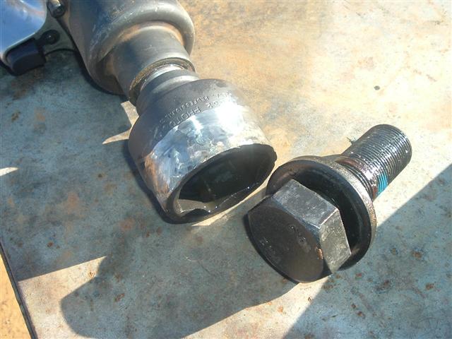

I went to the dealer to find out what sized socket they use on the piston. The mechanic there showed me a 2 inch impact that they put on a lathe to get the outside diameter small enough to fit.
$29 for a Proto socket, and then grinding off the outside of it really makes me question my sanity, but there's really no other way.

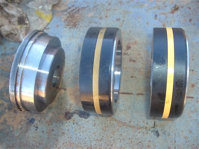

The new piston is on the right. The old piston is in the middle, and the part on the left is something I haven't seen before.
There was one metal ring on the outside that I repalace from the kit.

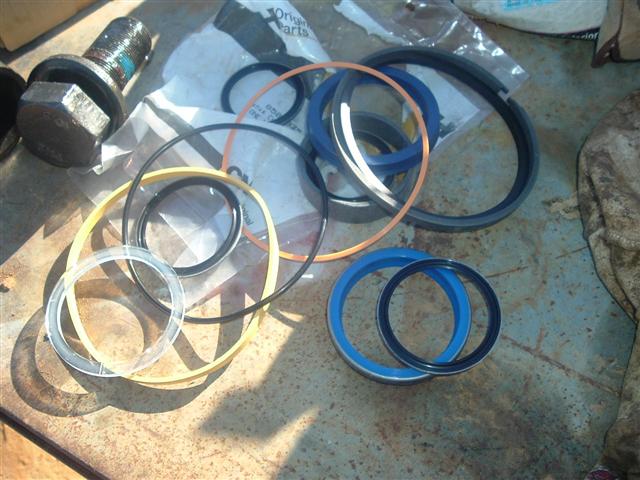

Here's the rebuild kit. Lots of gaskets, some of which you don't even use. I think it's a standard kit for different cylinders since both Case and New Holland do this with every kit I've bought.

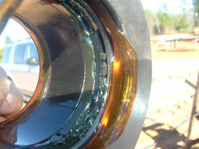

Here's a good view of the problem. Not sure how this happens when it was working fine, then all of a sudden they get all mushed up and start leaking.

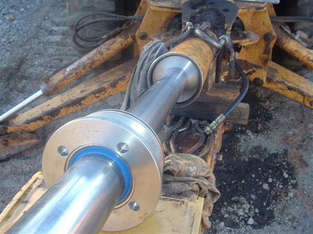

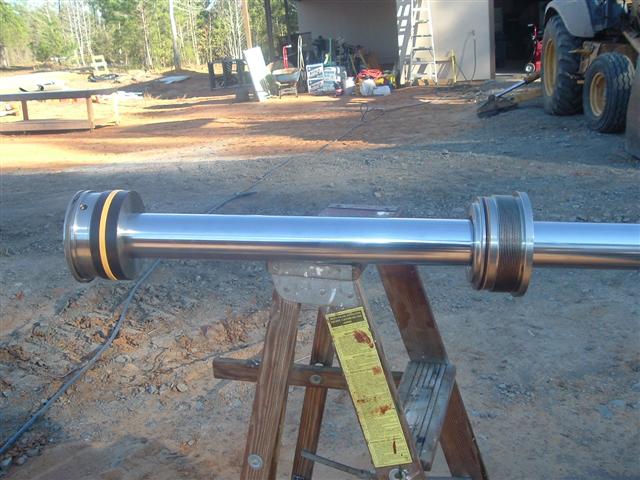

Here's the piston and rod assembly back together.
On the case rebuild kits, they include instructions showing which way the gaskets go. New Holland doesn't include this and I had to check my manuals to make sure on one of the gaskets.
I really should have had the New Holland parts guy print me a copy of the cylinder when I bought the kit, but seem to forget this every time I do a cylinder on this tractor.

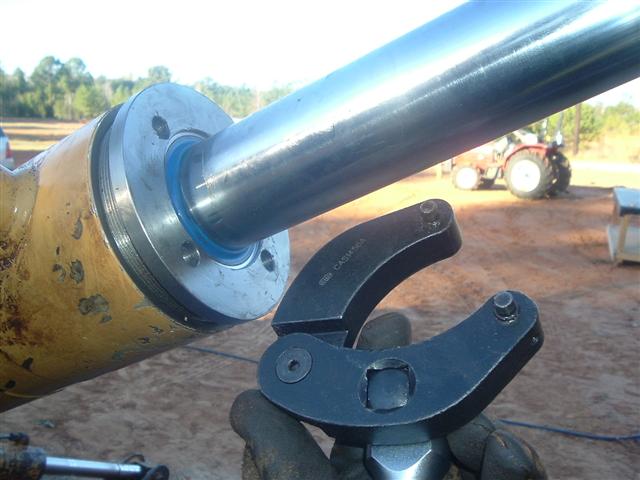

The hardest part is getting the cap off the cylinder. If it's on with loctite, then you have to use a torch to melt the loctite. I got lucky on this one and it came apart fairly easy.
The second hardst thing to do is get the piston back in the cylinder. It can be very hard to extremly hard. Either way, it's a royal pain.

Here's another view of the tool used to loosen and tighten the cylinder caps. It opens and closes to fit different sized cylinders, and the pins are reversable for smaller or larger holes.
