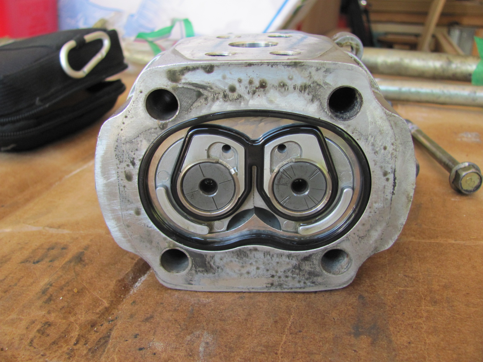

Dfkrug, They are not aluminum granules. That is a powdery substance from the bolts.
I removed the pump today and opened the front cover. I noticed the dealer installed the two rear bushings upside down. If you look at the illustrated parts breakdown from my previous post, you値l notice the left inside of the pump housing comes to a sharp point where the two gears mesh. However the right inside has that sharp point milled flat. I致e included the post mortem pic of the rear of the pump after the dealer rebuilt the pump.
IMG_6720 Bearings installed upside down.JPGI値l reinstall the bearings and try the pump again this week.

Congrats. You may have found your problem. Rebuilding these pumps is not hard, but you do
have to pay attention to how the complex seals go in there.
View attachment 513372I値l reinstall the bearings and try the pump again this week.
if they did not replace the center section of that gear pump and by the looks of it they did not I would tell them I want my money back or credit you for the repair expense toward a new pump- those bushings are toast
Take it back and demand a refund, if I had done that I would have been thrown out the door.

Success at last! It took some time but I was finally able to get back to working on the tractor. I installed the bushings correctly. Every thing inside the pump looked good, no pitting or scratches. I reinstalled the pump on the tractor. It works great!
There is no need to prime the pump. It'll suck the flees off a dog at forty yards.
The dealer promised to replace the seal kit and refund the labor cost (basically $100.00). I've already received the seal kit. I haven't seen the $100.00. Don't know what I'll do there.
