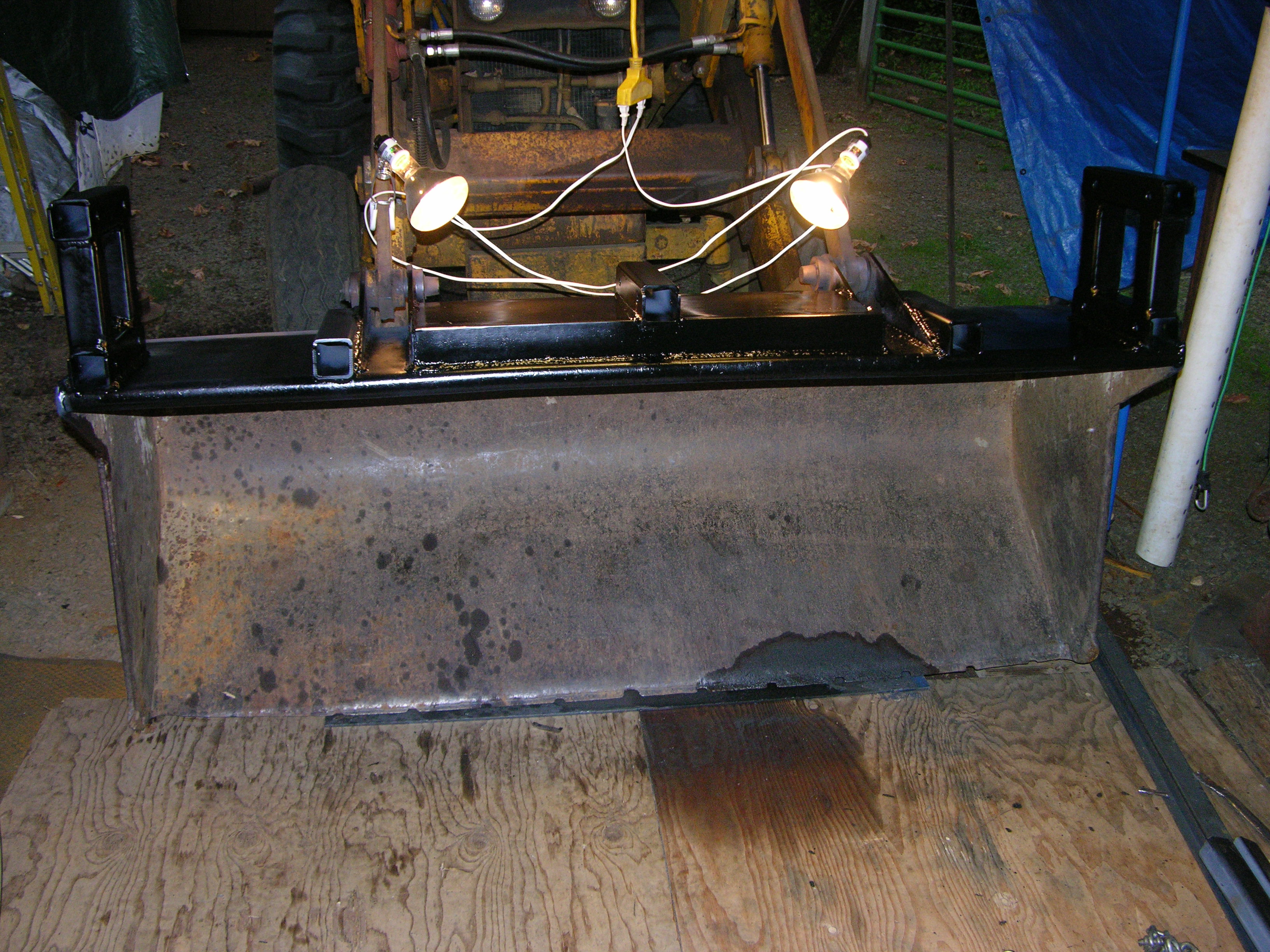

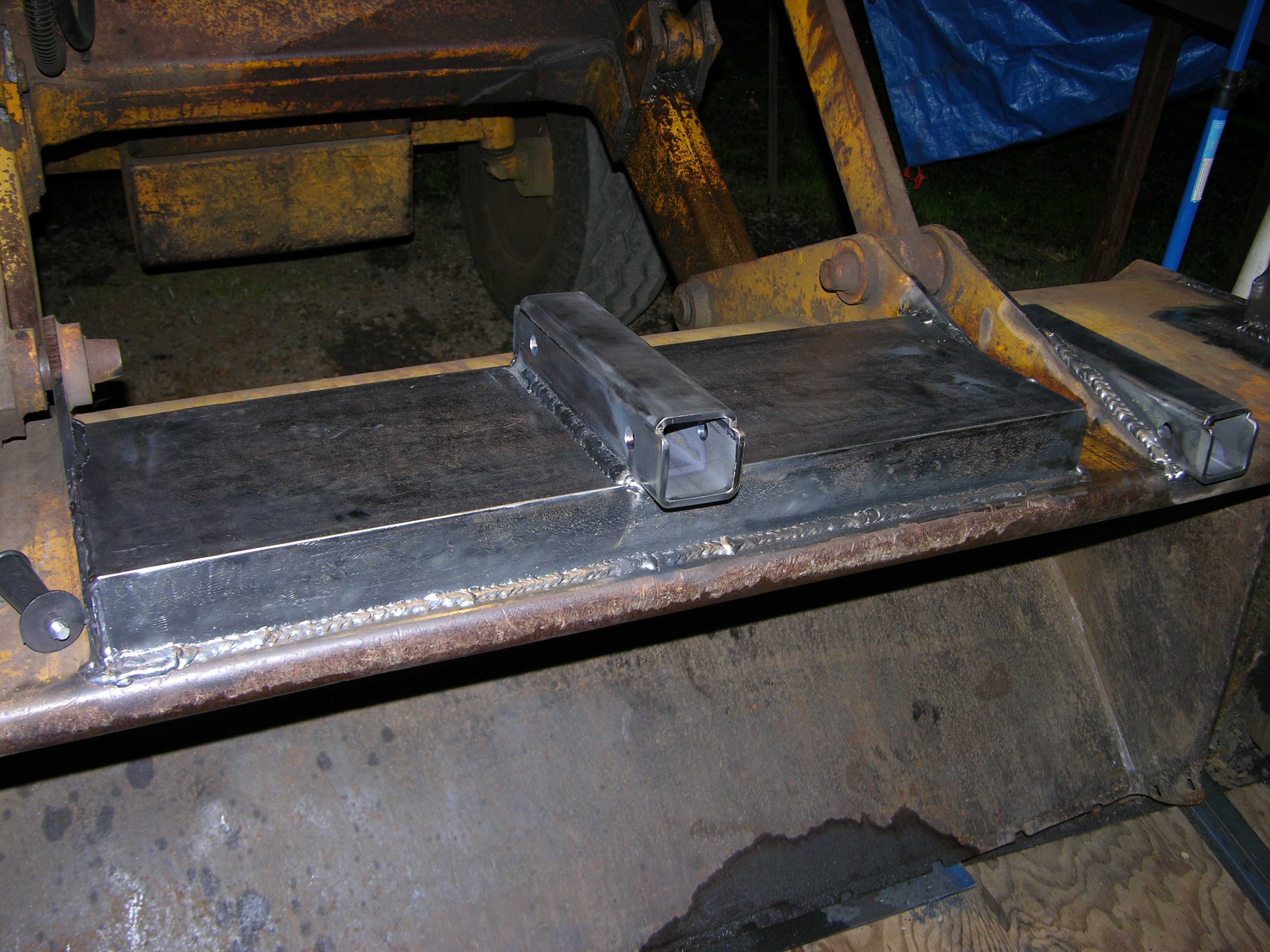

The stock you want for "normal" sized RECEIVERS - is 2.530" OD, with .250" wall leaves .030" clearance for .250" wall 2" STINGER material to fit inside. (just standard heavy wall 2" tube)
The actual "receiver" material might be a bit harder to find, but the standard 2.50" tubing is a "HAMMER" fit in most cases.
This is what I did on my 580's loader bucket, then I have GOBS of inserts of all shapes and sizes - makes for a really versatile setup for whatever you wanna pick/drag/lift/push, etc -
Notice the trimmed back top edges on those receivers? If you have ANYTHING that's very heavy to plug in, you'll appreciate this tip. I have a vise that's mounted on a piece of 10" C channel with the stinger feeding thru 1/2" FB and full welded, whole thing weighs right at 98 pounds -
With a straight cut receiver, you need to match things up almost exact before you can let the receiver take any of the weight - with that top trimmed back about 1/2", you can rest part of the weight on the first 1/2" of the receiver, and THEN line it up and push it in the rest of the way -
You can do the same on bench mounted receivers, whether or not you use some of the other excellent suggestions for taking the slop out... Steve
