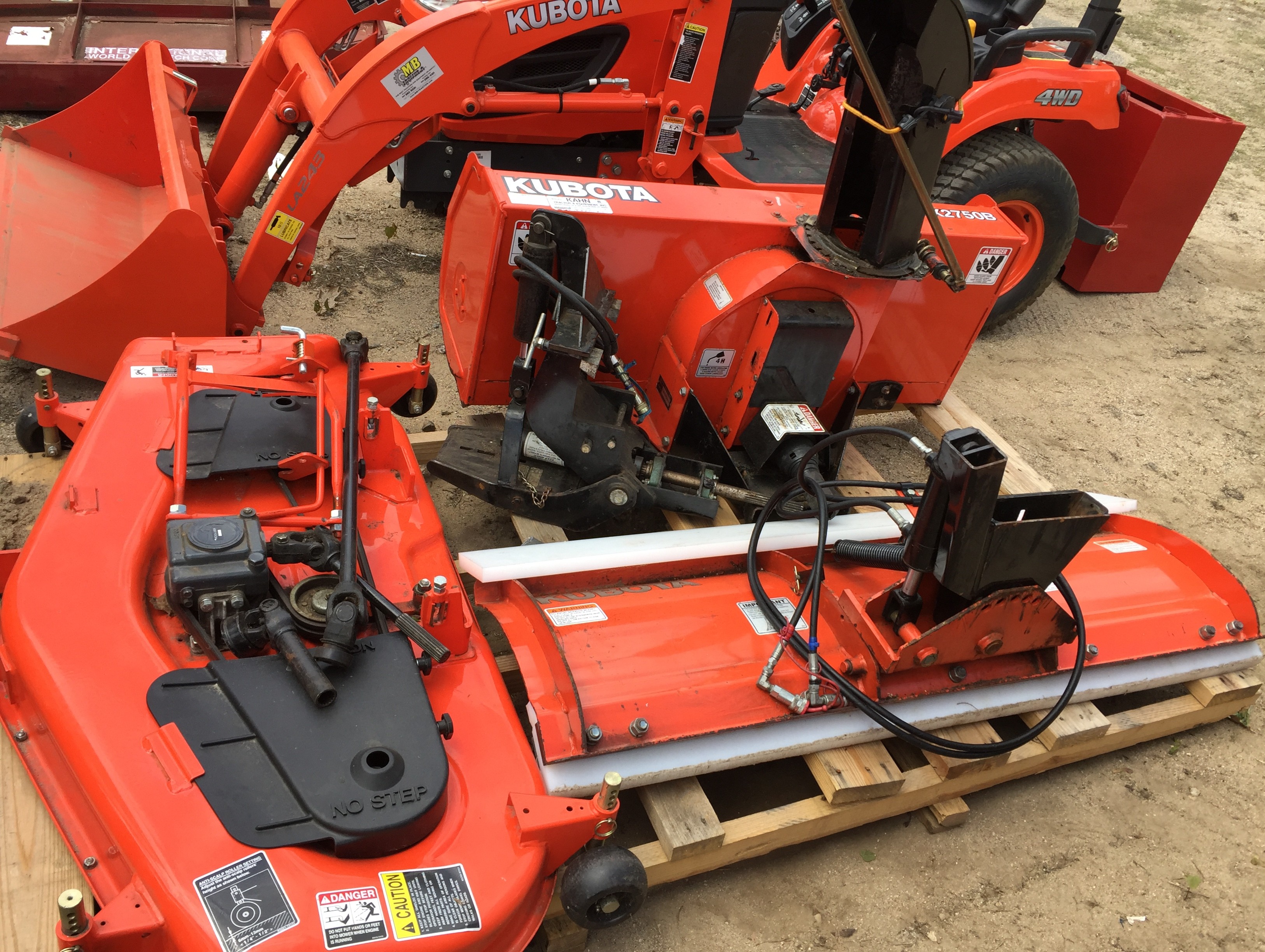

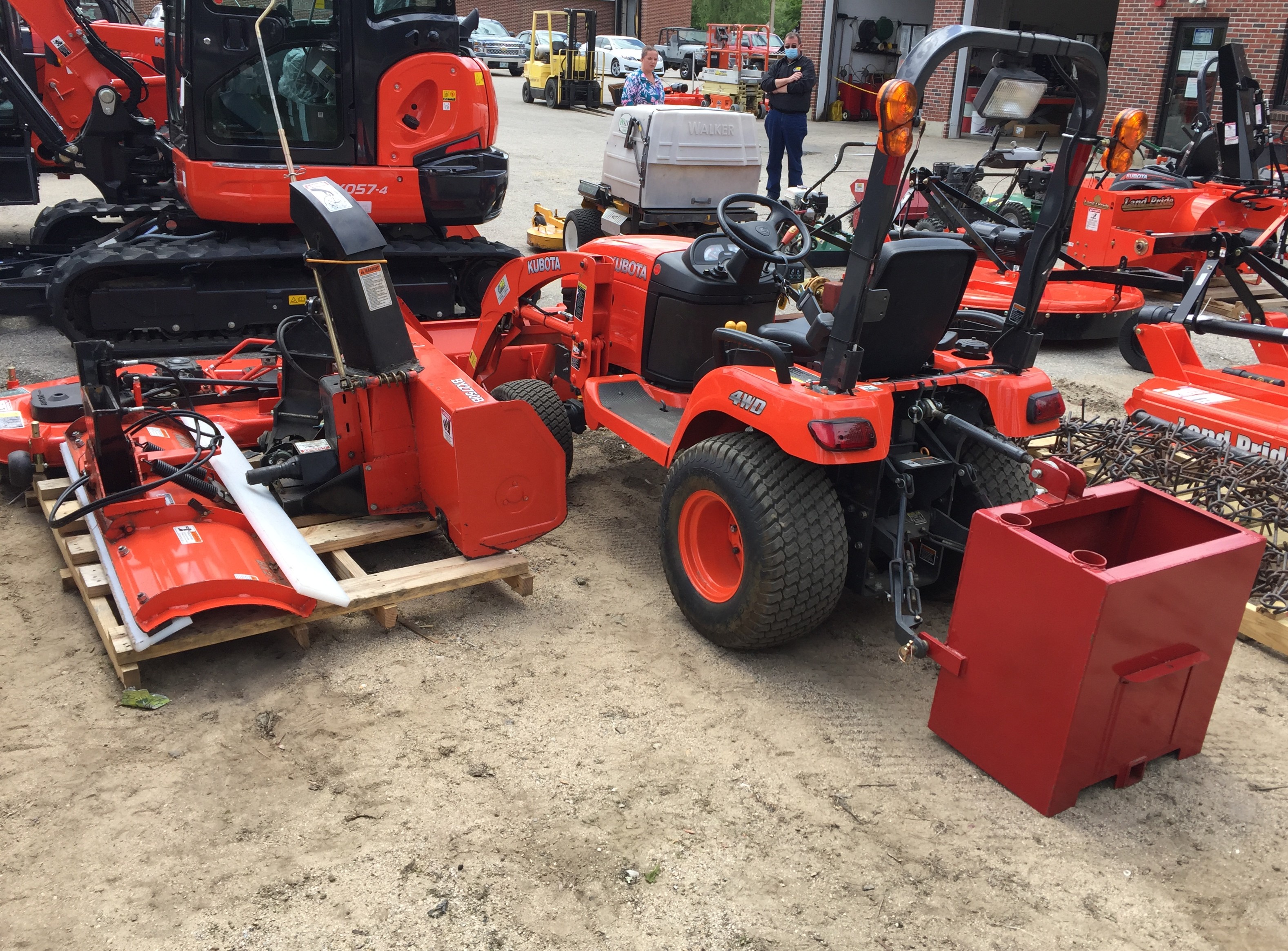

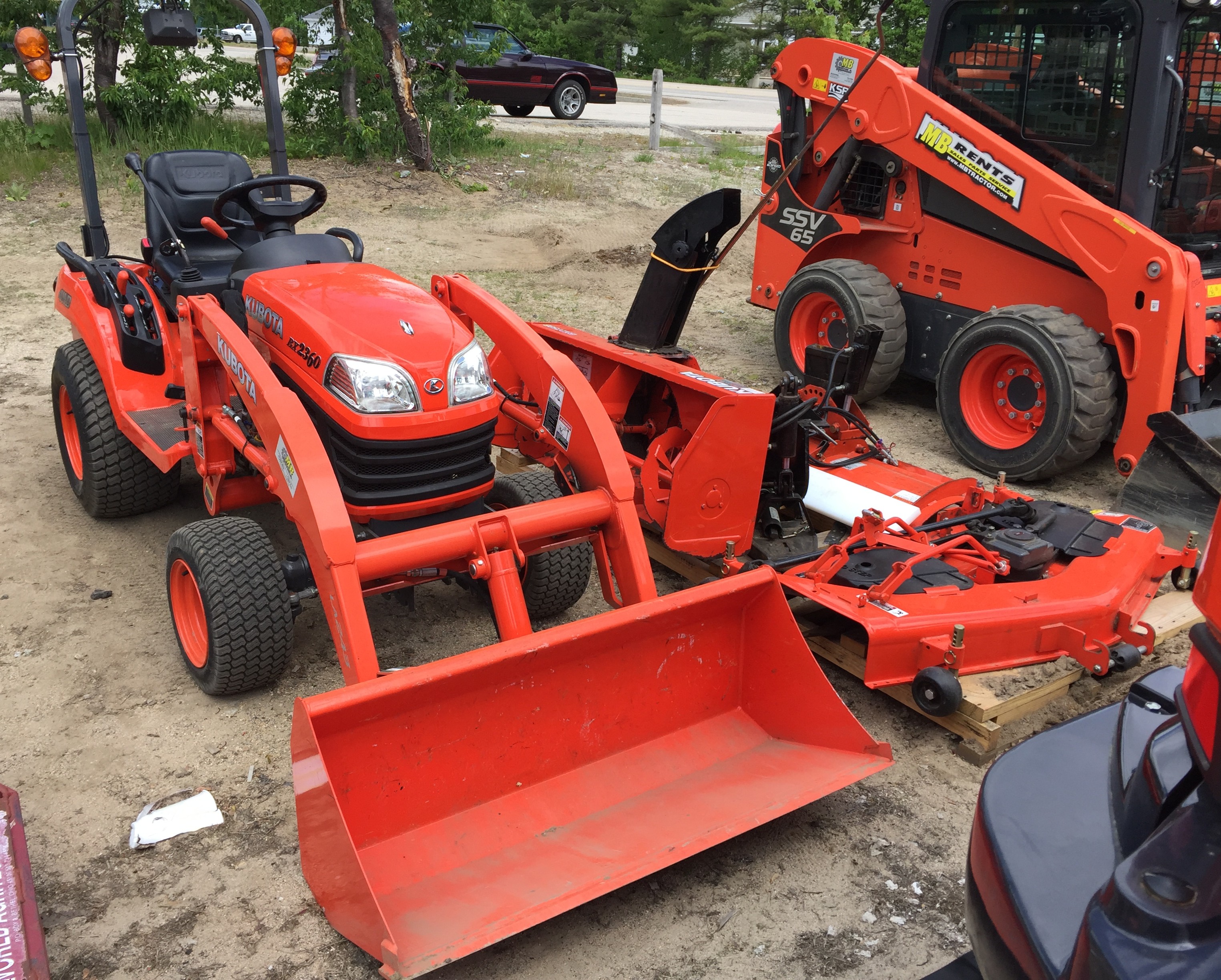

Purchased June 1 2020, took delivery about one week later from MB Tractor in Conway NH.
2011 BX2360
Loader and Bucket (didn't necessarily need or want but it came with it)
54" Deck
Snow Blower
Power Angle Plow. (didn't necessarily need or want but it came with it)
Based on hazard light placement and bolt evidence, it had a grass catcher but I didn't get it.

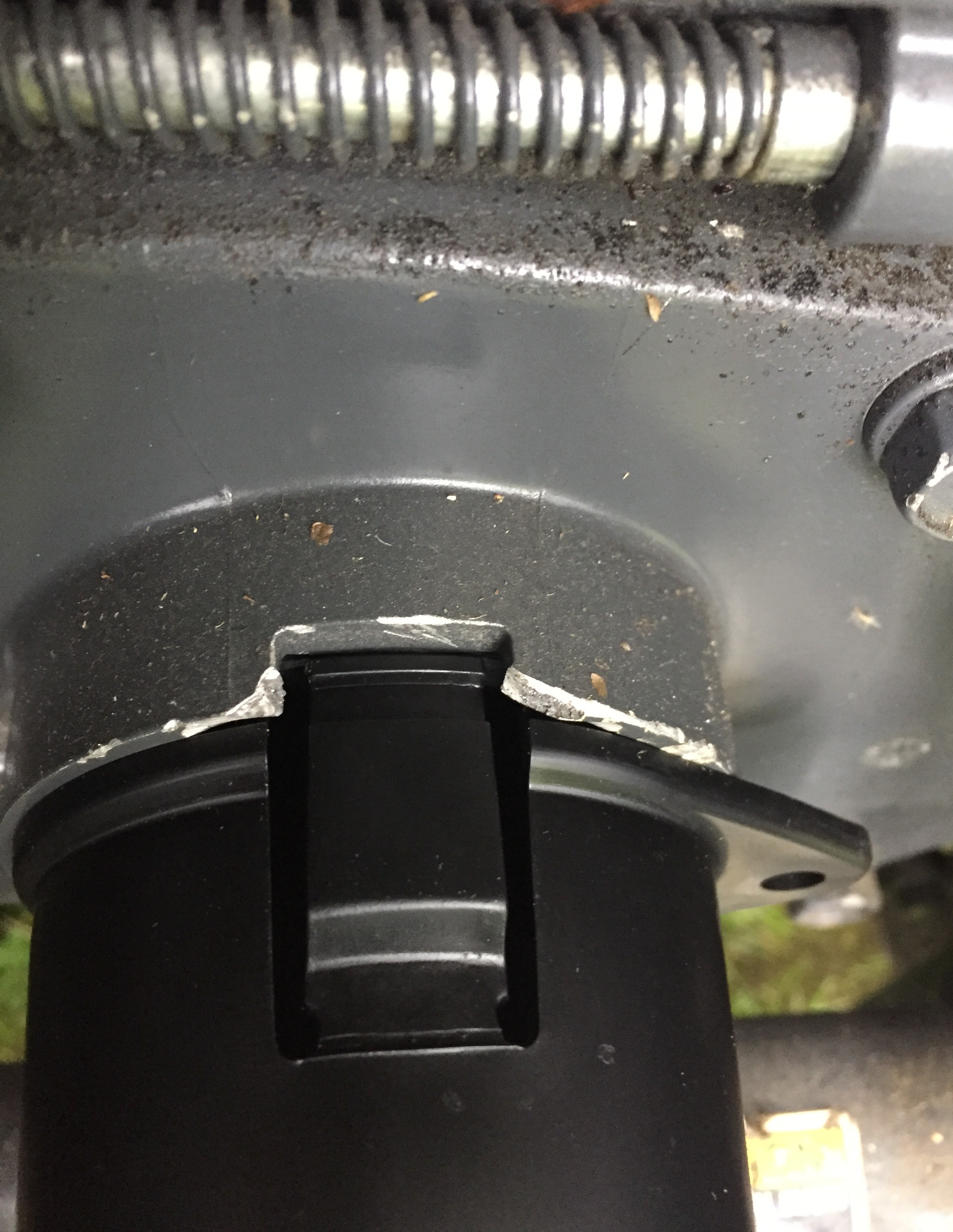

Lower Rear diff. cover plate boss for PTO had upper clip slot broken out, care not to replace part at this time, or ever. Cut stainless hose band clamp with no serrations, flattened, bent tab. Bought another 3"-4" band clamp, slipped manufactured tab in between, wrapped boss with clamp and tightened.

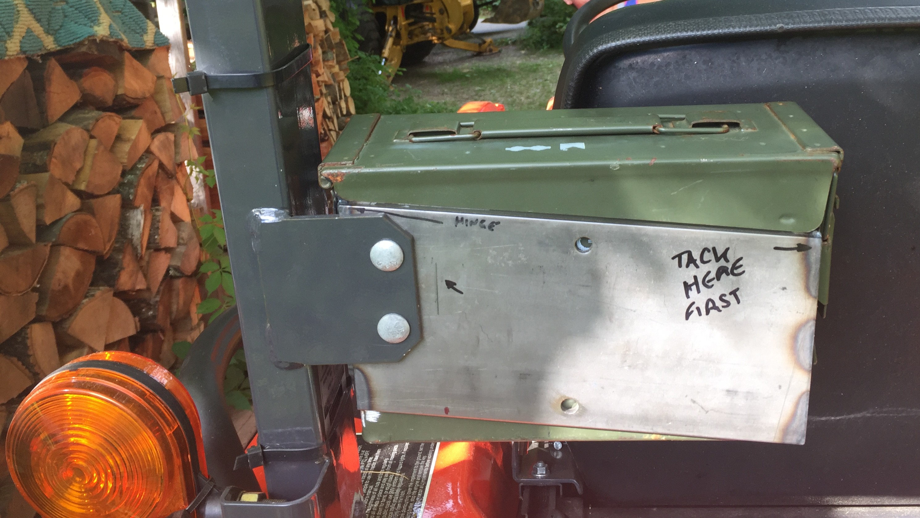

Almost done with 30 Cal. ammo can tool box. Plated one side and added smaller plate inboard as well, drilled two small drains just in case, but expecting and hoping for water proof. Mounting to SMV bracket on ROPS. Fabrication done now, in process of paint and sealing now. Results confirm inclination and design...it is very rigid because of plate despite being cantilevered. I think I could stuff it with lead.

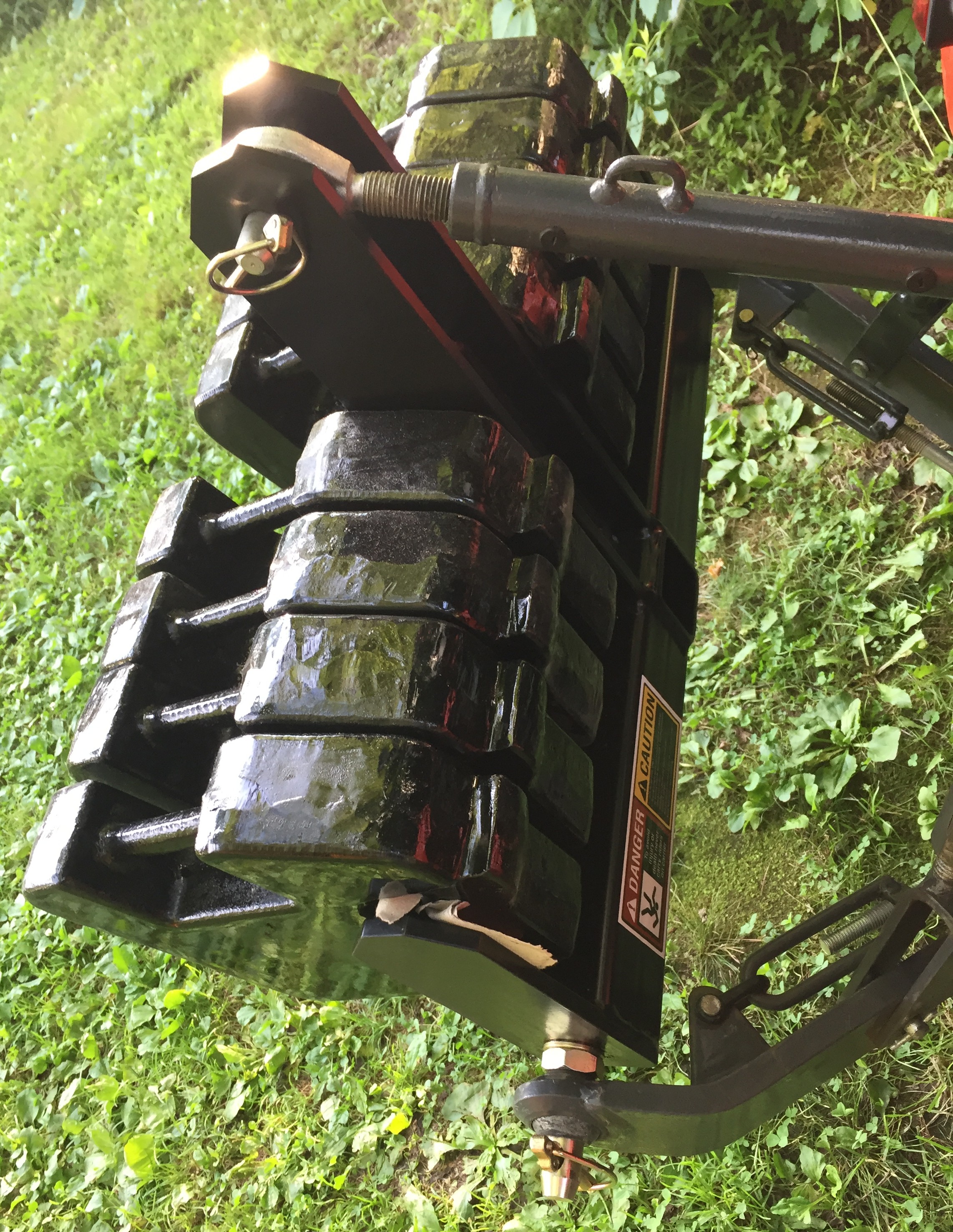

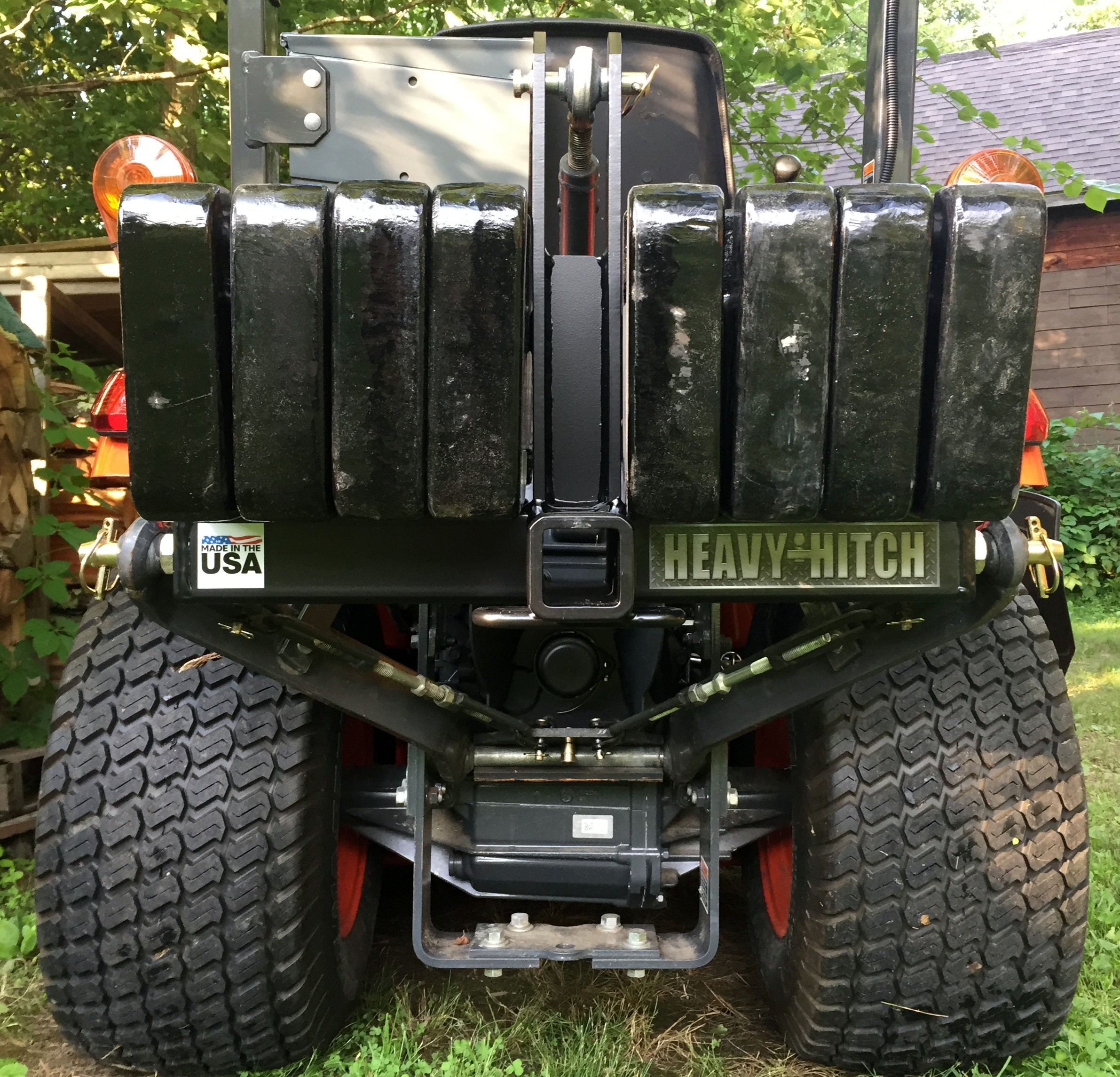

Sold the ballast box as received from sale. Ended up purchasing Cat.1 standard heavy hitch with suitcase weight bracket and eight suitcase weights.
