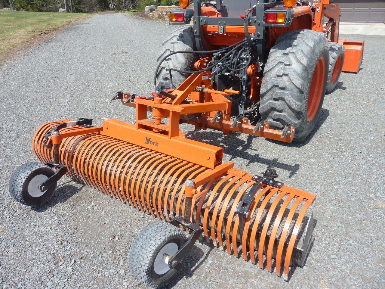

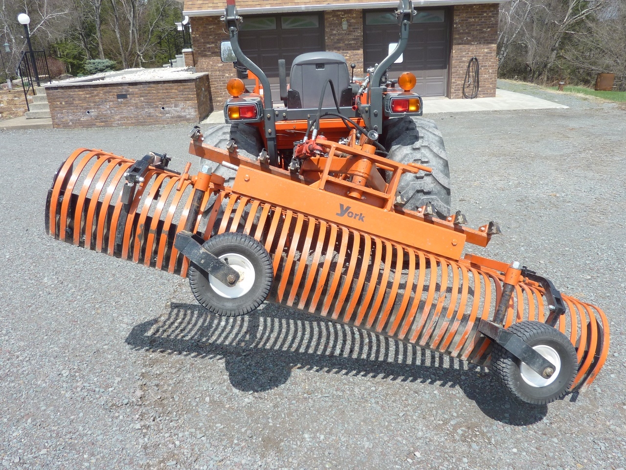

I use the same approach to maintaining my 1.25 mile private road. I have an 8' York rake with grader blade and gauge wheels. I also use a T&T kit, which makes the rake far more useful for cleaning ditches and getting a good crown:
Without the grader blade, the tines are spaced too far apart and leave the fines behind. Working the material too much tends to separate out the coarse gravel, and without the fines, it's difficult to get the graded surface to hold its shape.
