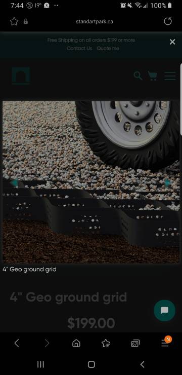

That's a good option, the driveway mats if they are available in your area. Just remembered about those.
Or geo grid or whatever they call em. They are square or oval shape tiles you push into the ground.

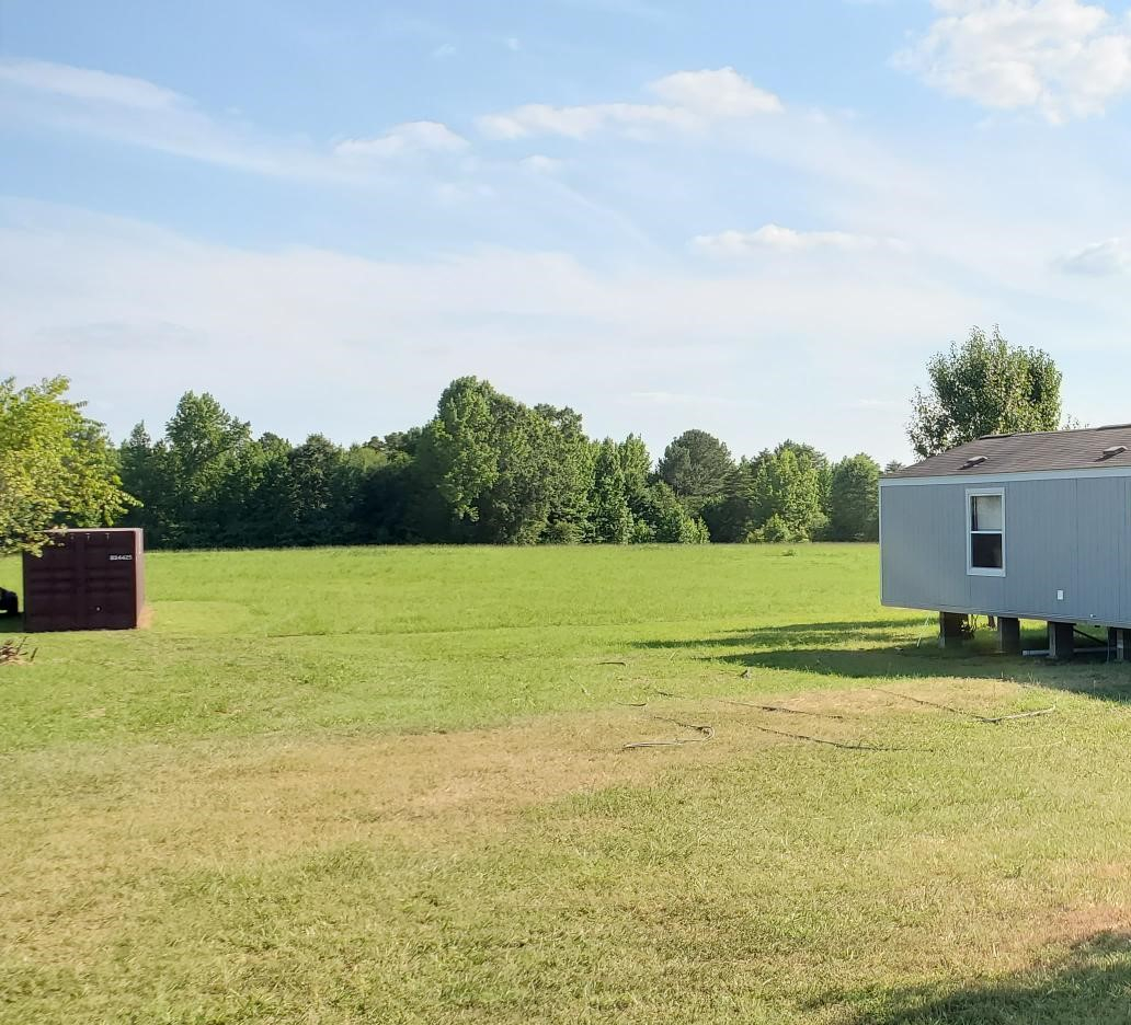

Morning all,
My family has just moved onto our new property. We moved a house trailer out to where there was one several years before, while we finalize plans and build a house. There was/ is a gravel driveway in the right spot but it has been so long since it has been really used it is almost undiscernible from the rest of the lawn. I know there is gravel under there but there is a layer of... lawn?... on top of it. I guess the grass grew through and created soil in and on it. Is there a way to reclaim it short of just adding gravel and packing it in? I have a 1025R and a box blade. I started to just start dragging and see what happens but I'm afraid I'll just make it worse.
You can see the slightly discolored grass where the driveway is here. It is raised 6-8 inches from the yard grade. This is from when we were setting it up so don't judge the mess and unfinished trailer please.
The purpose of a gravel driveway is to keep from forming ruts, getting your vehicle stuck or muddy, etc. The gravel driveway, especially as it is above grade, even though grown in with grass, accomplishes all this. It isn't less stable because of the grass growing in it, it is actually more stable. I have a 1200' driveway that is gradually growing over with grass, bermuda coming up from below, and we take 60,000# trucks over it even when it is soaking wet with no problem.
I'd leave it as it is and use it. And that is ABSOLUTELY the least expensive option.
