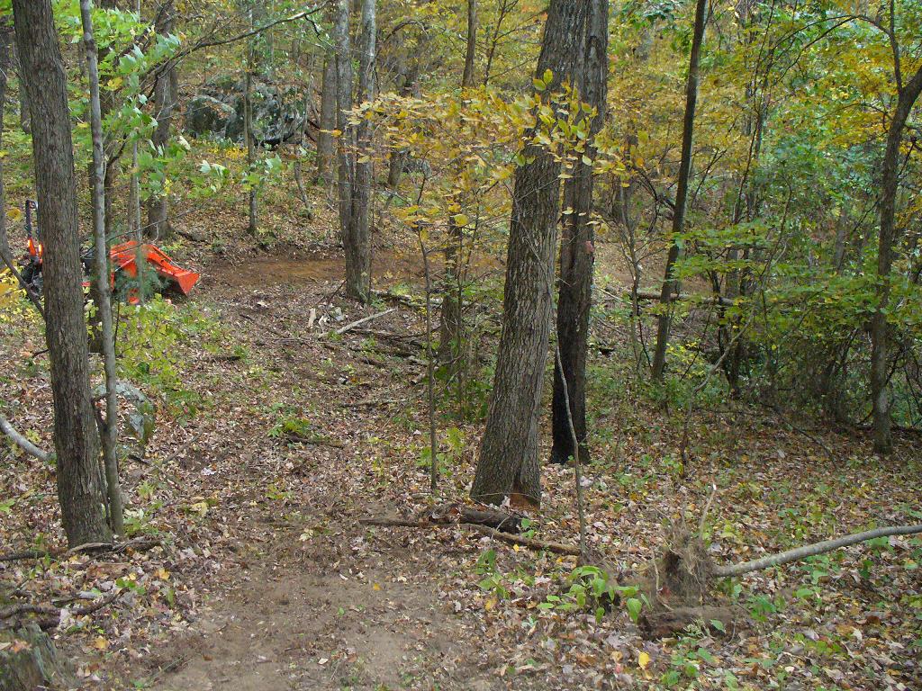

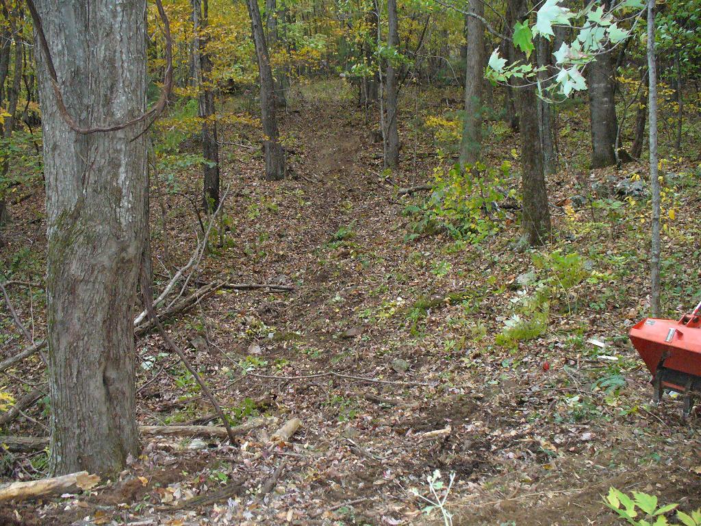

Here's a few pics of the end of the trail. I got it cut up to another trail so now it's a complete loop. I'm still debating about what to do with that gully, but I can get a tractor across it so it's not pressing. I've also started cutting a new hillside road through some pretty dense woods on the back of the farm. I'll probalby start a new thread for that sometime soon.
First pic is looking out the end of the trail, second is looking back towards the aforementioned gully from the end of the trail.
