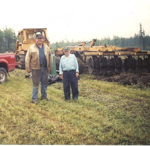

Here's a 12 footer, but at 853 lbs per blade I doubt that your neighbors tractor will be able to make good use of it. This seems to be a recurring theme every year. It is not just the width of a disk that needs to be considered, but type and weight per blade along with soil and terrain conditions is what will dictate what one can make use of with their tractor.
First time I've tried to attach a photo from my iPad but if it shows its a picture of what it takes to pull a disc with that blade load. It rips up the oil pretty good, plus chews up brush and anything else on the ground. It's a Cat D6R.
Lmao! Great photo.
