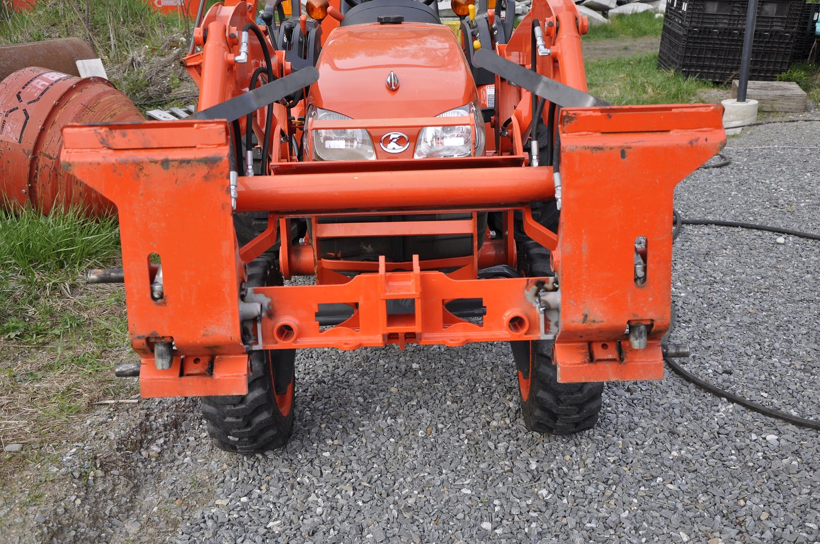

Not sure exactly what the pricing is - it's going to depend on the options. Jery is a little web impaired - so his site doesn't have all the bells and whistles. He always responds to email though.
The grapple setup goes along with his Tach-N-Go quick bucket attach. I put one of the Kubota SSQA setups from the Bxx50 tractors on my B3200 - so Jery made me an "insert" that I welded into the SSQA setup after removing the crossbar. The insert has a 2" receiver - that is part of the connection system for the grapple - and I can also use it for moving trailers. There's also a couple of round receptacles for bale forks just in case I ever need that.
