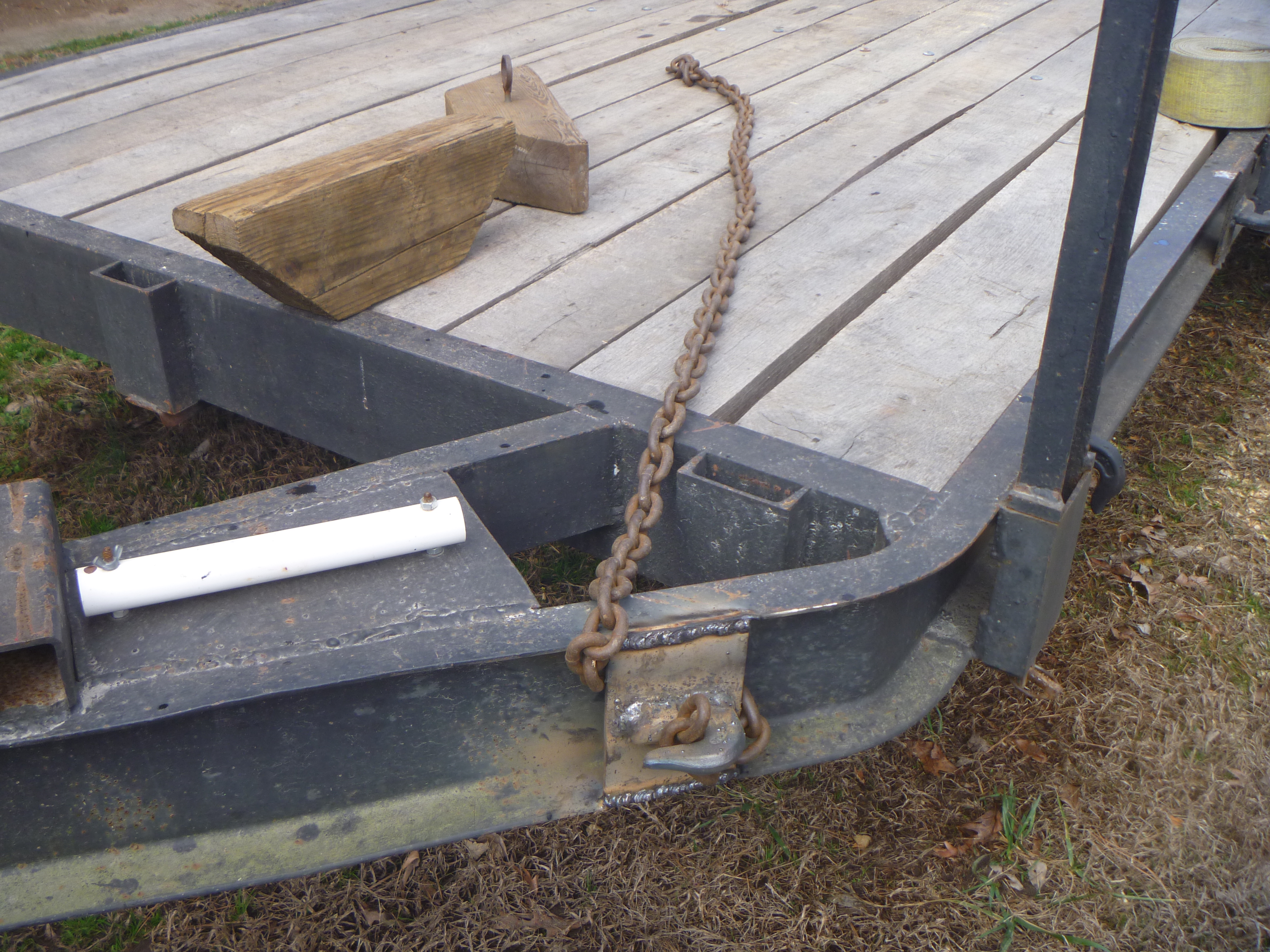

I wouldn't bother with d-rings, first of all because you'll never find the right place where they work for everything, and second, they are going to be a pain to deal with if you ever transport bulk materials in the trailer. If you really must add extra tie-downs, have them welded/bolted to the edge of the trailer frame where they are much more versatile and out of the way. You also get maximum stability since your tie-down chains/straps will now angle all the way to the side of the trailer and have a wider footprint.
   / Recommendation on short tie-down #17
That is what I did, welded 4 D rings to the side rails of my trailer. I did this after loading my tractor on it and determined the best location front and rear for them. The D rings lay flat on the rail so unless something is hanging off the trailer, they wont interfere with it laying flat on the trailer boards. I actually slanted the D rings mounting rather than mounting them 90degrees to the rails so that when chained to the tractor the chains are pulling at the D ring in a straight line. The location happened to be half way between the standards on the trailer frame so it added 4 more tie down points.

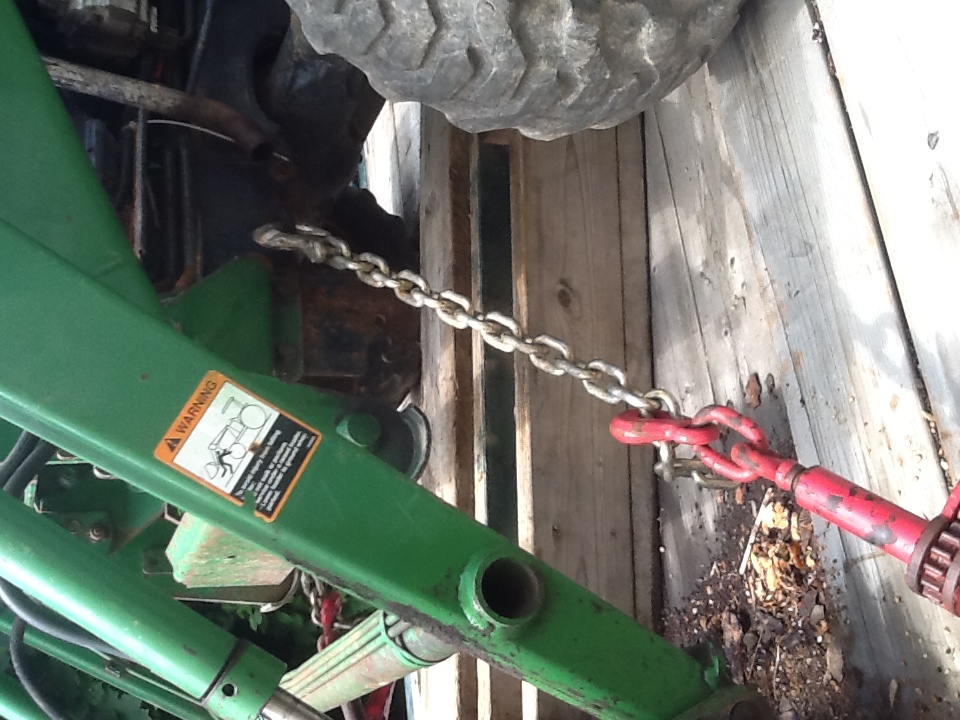

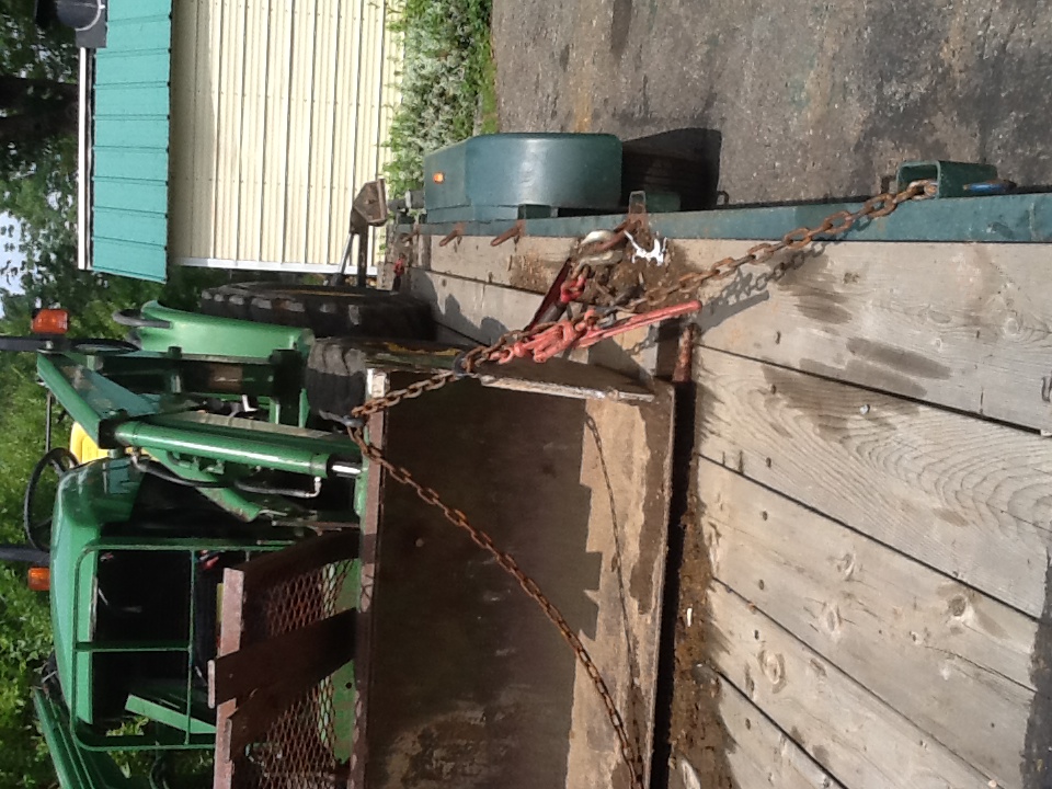

Pictures of tie downs on trailer.
