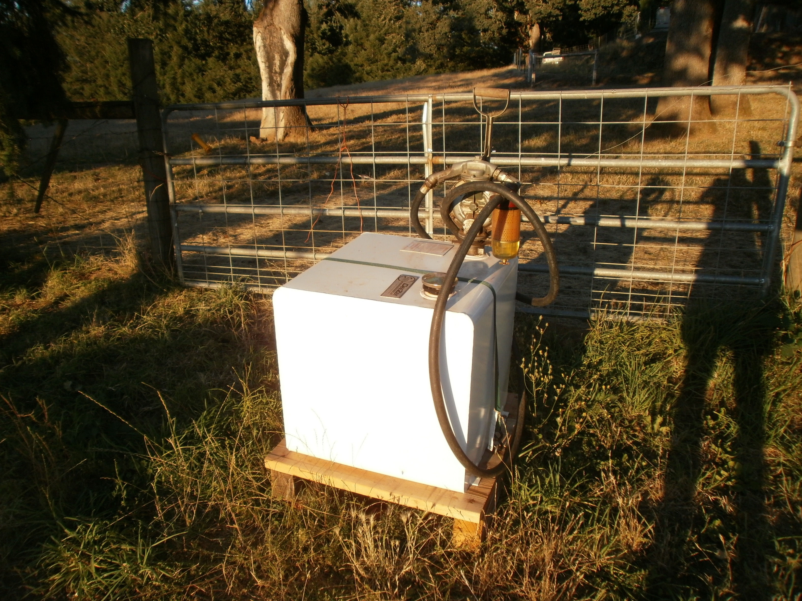

Use a 50 gallon cube with 12v pump. fits nicely in the pickup or on the flatbed trailer when needed.
Fill it twice a year with offroad diesel

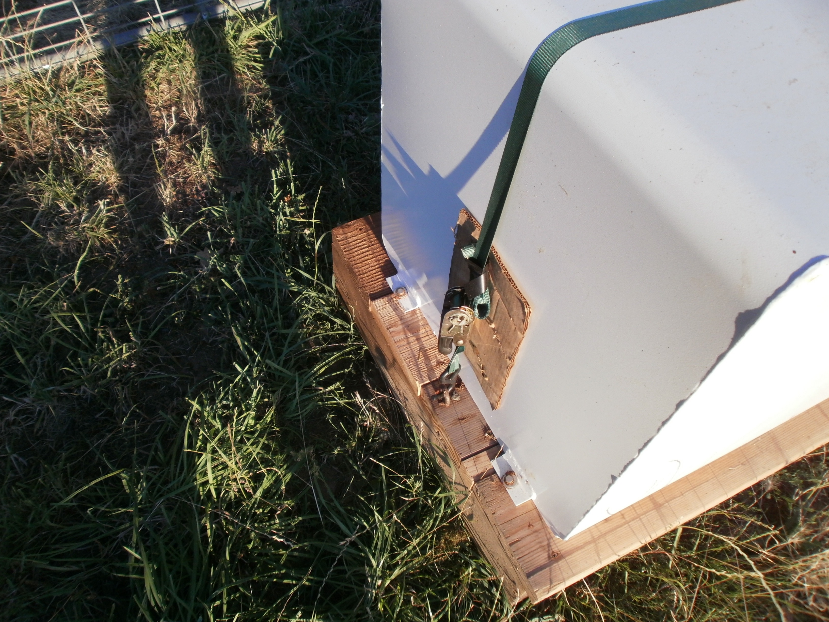

I just went to a local tool supply house and bought one to suit my needs.
100G filled twice a year is ample for my usage.
Local shipper has a 100G minimum order.
All I need to is keep 2-3 empty 5 gal tanks around for overage.
Never let the tank get empty.
