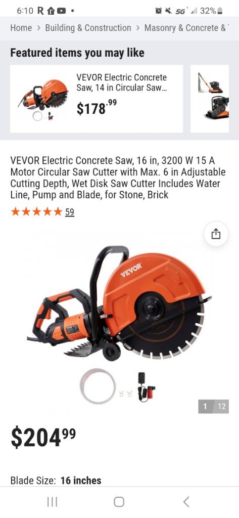

Street saw, and lift panels with forks on a front end loader. Far less ruble, fast, and clean. If you get a good feel for it, you can pull whole 5ftx5ft squares out, sometimes intact, other times, maybe 2 or 3 pieces. Here is an electric one, that comes with the blade, for $210. I think the saw will be more useful than a electric breaking hammer.
Edit: I'm far from a safety guy, but maybe I've watched too many Silicosis training videos, run water, and where a mask/glasses. I've sawn plenty of concrete through the years without a mask, and only a water bottle with a nail hole in lid, and a helper squirting the blade to keep dust down, but not ideal.
   / Recommendations for hand held electric pavement breaker please #20
Also, the saw and lift approach, if you are repouring, requires less regrading and prep work for the next pour.
