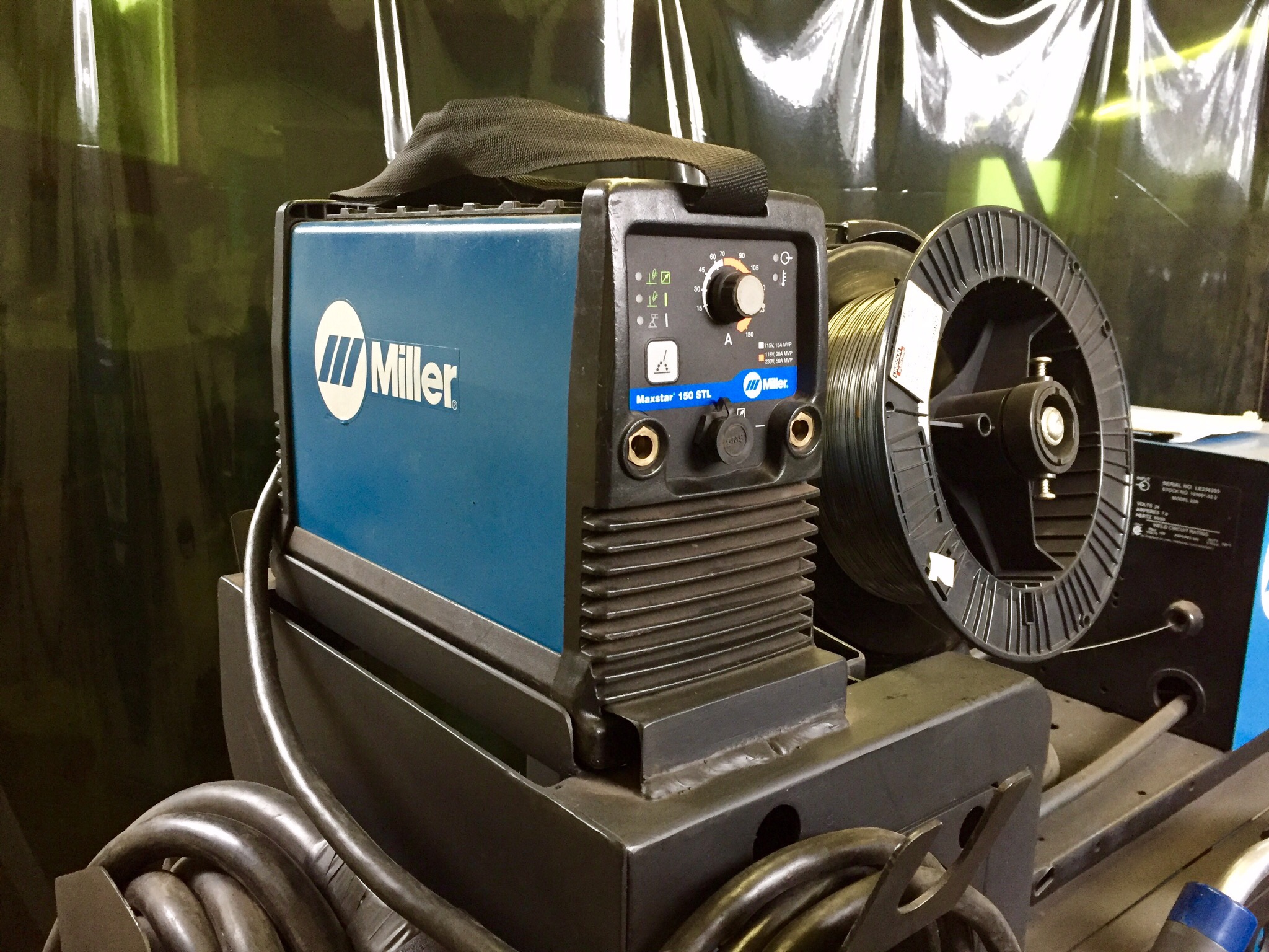

I really like my Miller Maxstar 150STL. Dual voltage and only 14 pounds. I got it one year old off eBay for $450. IMG_2088.JPG

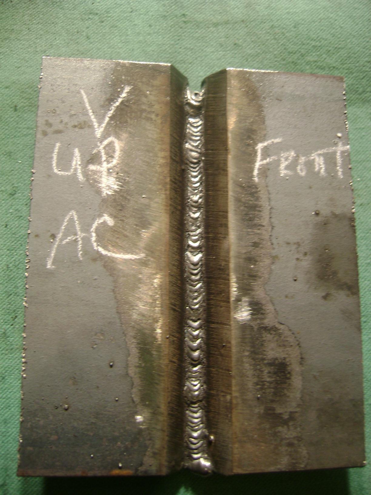

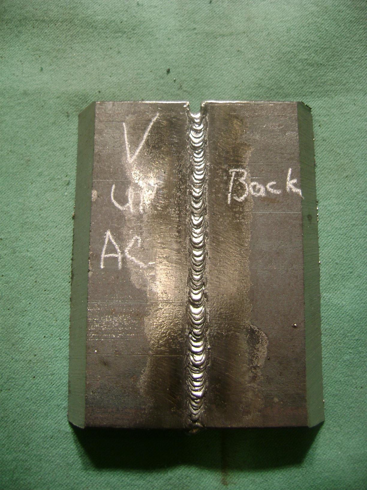

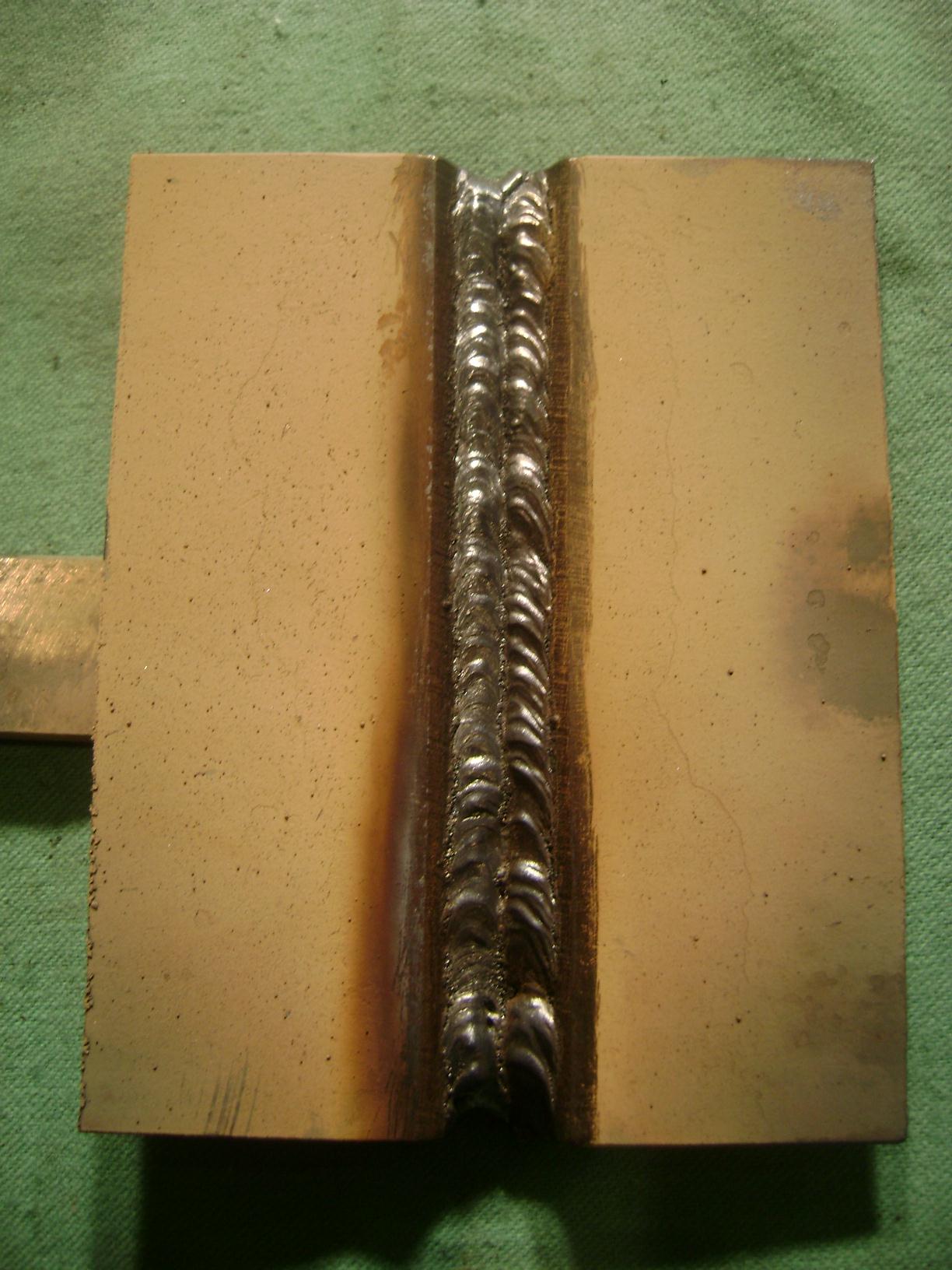

On the job, all we ever got were DC only engine drives. I thought AC was for Tig welding aluminum:D. The subject of SMAW with AC comes up every once in a while. Few years ago, I tried it I was shocked over the sound it makes!:eek: The first picture is over head with 6011 on AC. The next two pictures are vertical up hill open root plate with 6011 on AC.
