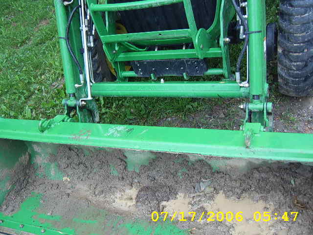

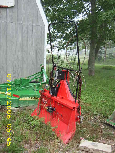

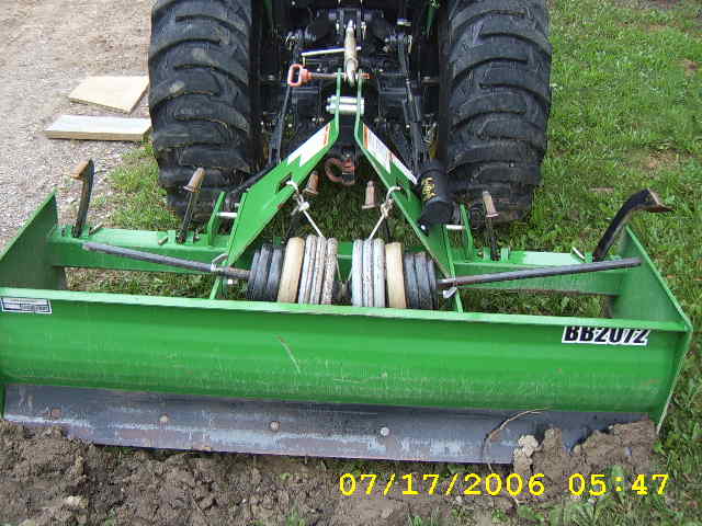

I have 534 #s of box blade & 235# weight bar attached 90% of the time using the loader; ~800 #'s of log winch otherwise... either one gives me plenty of ballast for most of the loader work I've done... that said the 300CX can easily lever up the back end when under an object or loaded beyond ballast.
I don't know how much steel or granite you've got, but you could try adding them to your box then add crushed rock... those box numbers you give do seem light for ballast, and depending on the rock, could be pretty light.

My experience is that my tractor has an fairly effective counterweight on the back... I'd rather have a genuine 800-1000 lb Box Blade on the back though!

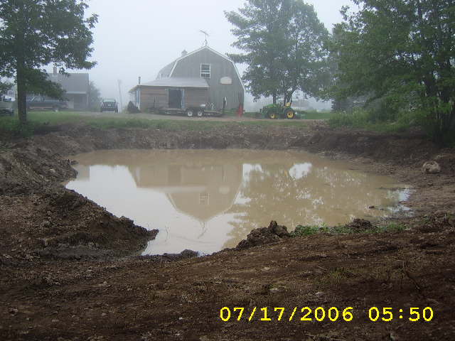

I have moved a lot of material with the FEL (technically, probably the majority of my hours HAVE been loader work) in digging out the attached pond... prior to adding the additional steel in the back of the BB I was not very efficient using the FEL, and did lever the back up, lift a wheel on either side, etc.
As is, the tires still rut 3 areas of my field... Once my pond is done, bushhogging will be my primary use, so I'm leaving them as is to minimize rutting & compaction.
