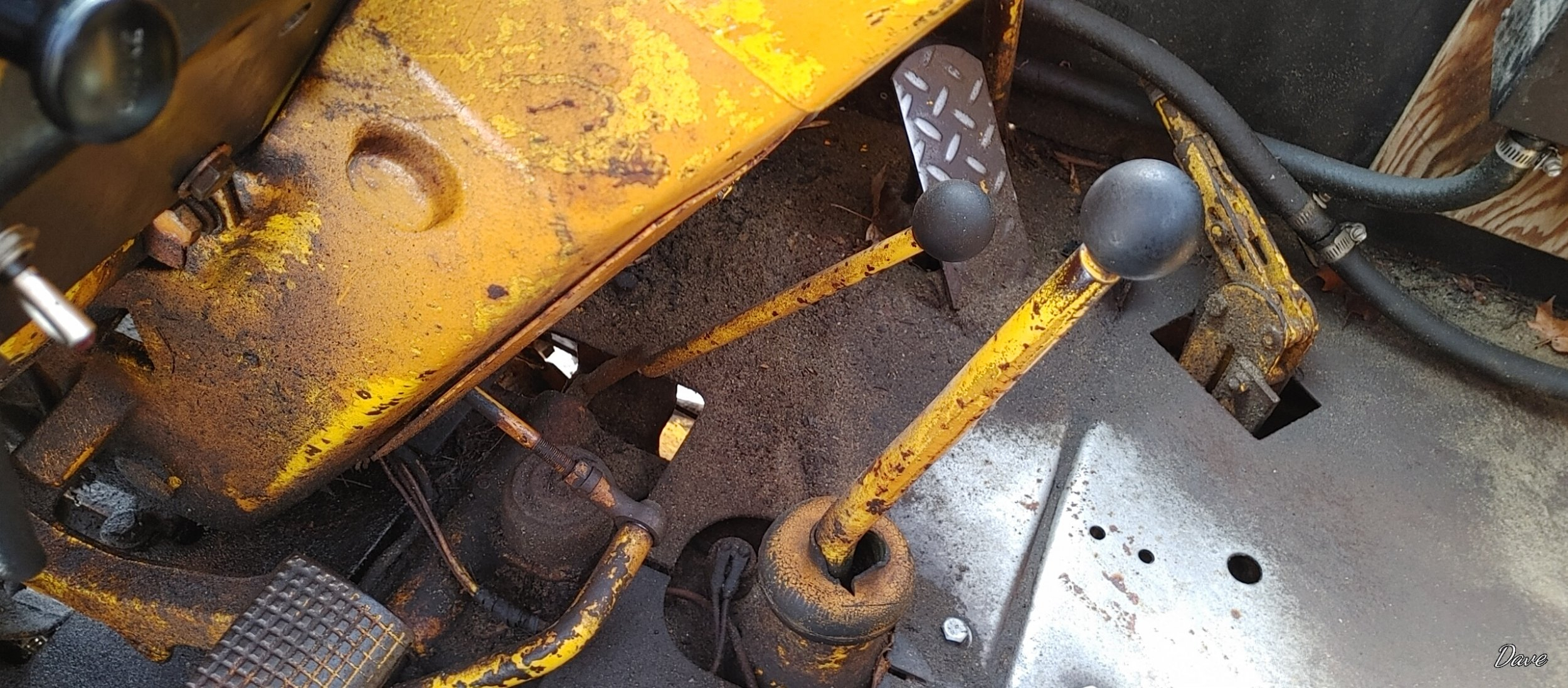

Took a picture of the shifters on my 580B just for giggles. I have not been able to find any information about this setup.
Very messy looking after oil blowup. I have tried to clean up a bit by pouring hot water on the floor and it washed sand out of all the crannies, can't clean right up until it warms up a bit.
One of your water ingress issues is the torn shifter boot. You need to replace that, not only will it allow water in the tranny but it will allow filth inside as well. The shifter goes directly into the top of the transmission.

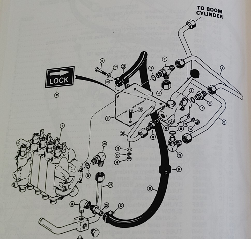

Steve... My hoe has the same type of lock to hold the boom in the upright position as yours, for travelling etc. I have to bring the boom up as far as it will go then push down on the boom lever a bit and then bring it back fast to bring the cylinders far enough back to lock. It has a lever to unlock outside the cab, have to push boom ahead a little to release it.
From my understanding, the lock I show in the picture is actually a dipper lock. It says in a couple of publications that I read that its to allow the dipper to be used as a "crane". Although I have never used it at all for any reason, but it is free and opens and closes fine. The rubber hose slipped off the end, it doesn't appear to be split or have any break in it.
5030: Yes I have to fix the shifter boot. The machine has a good cab on it that doesn't leak but the grudd is definatly an issue for sure. I will hunt around and see if I can find one.

5030, good call on the boot - mine's getting a bit "long on the tooth" too, my cab's likely the reason I've gotten away with it too...
Dave, the "crane" comment dredged up a long-forgotten option I don't have - but I'm having problems with a rubber hose just "slipping off" of a connection that almost HAS to be a pressurized line??!? Are you sure that hose didn't slip out of a CRIMPED connection?
I've used my hoe as a crane a couple times, back when ALL the hoses didn't leak - but I've spent too long in maintenance environments to EVER put any body parts where a failure could get me in trouble - besides, there are too many ways to deprive me of enjoying about $30k in musical instruments and at least that much in tools... Steve

I know strange setup with rubber hose and clamps but that's how it is. I assume its under pressure but not as much as other connections. There was a lot when it came off, that's why I figure maybe froze a bit and cause more pressure than the connection was designed for. Have a look at the photo from a parts manual for the 580B, it show just a rubber hose with hose clamp connections at each end. I think the rubber hose is some sort of bypass...

Yeah, must be a tank return; pretty much ALL of my return lines are done that way. That tends to support your theory about freeze plug causing the oil bath.
Seeing where that option gets its feed, I'm thinking that our main control bodies are the same; seems like I had a plug where your part#29 ties in... Steve
