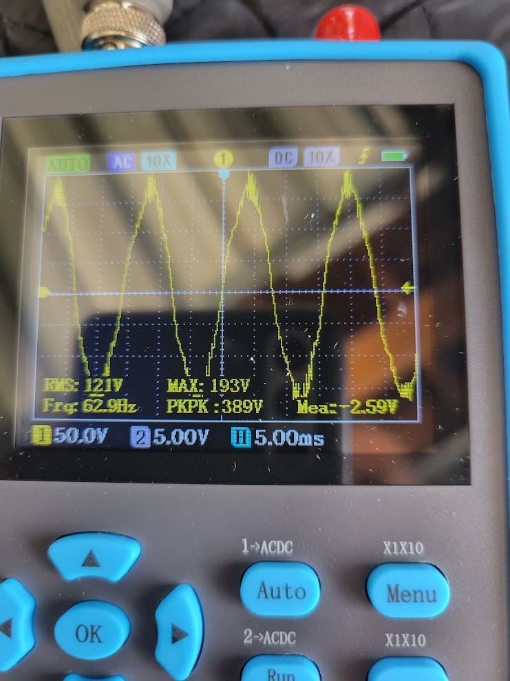

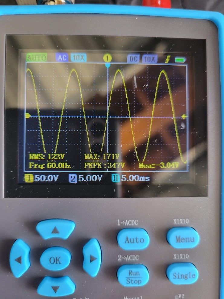

I even bought a cheap oscope (was $80 from aliexpress, same unit as this on Amazon)
I really just wanted to see compare the signals from my conventional and inverter generators. Big difference!

now if your testing generator power, go fluke or go home. Chepo testers cant reliably read dirtier power from a generator correctly. Ive even had greenlee and klines give false readings on generator power.
An RMS meter is an RMS meter these days, just make sure it is a "True RMS" meter. You might have been comparing a True RMS meter to one that wasn't. You are kind of saying your Kioti and my LS can't move dirt as well because they aren't a Kubota. You do need an o'scope or a THD meter which is really spendy if you want more detail.
