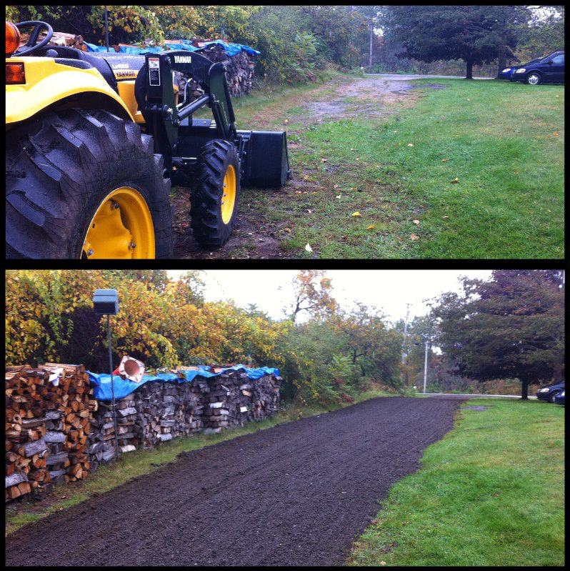

There is a place in my town that converts waste materials to road maintenance and landscaping products. For driveways, parking lots, etc, they sell a product called C&R, which is 3/4" and finer crushed concrete, asphalt shingles, and some brick mixed in. Its' pretty reasonable, about $8 cubic yard delivered. Between my mother's and my driveway, I've spread about 140 cubic yards of it. This place rejects asbestos shingles, so that should be a non issue.
Some foreign material has gotten in there, like pieces of ceramic and thick rounded pieces of glass, but the last couple loads were pretty clean and I have never seen any metal in it. It can be pretty smelly when its delivered, but the aroma dissipates.
My mother's driveway is shorter than mine and has thicker layers of the C&R material laid down presently. We are now entering Mud Season in Maine and my stepfather is thrilled at how there is no mud in their driveway. We have also noticed the cars stay cleaner and less dirt is tracked into the house with the C&R material down.
The C&R spreads on darker when its moist, but it does gray-out over time as it dries out. Here's a picture of my mother's driveway after the first load of C&R was put down and spread with a box blade. Once we thaw out a little more I plan on ordering another truck load to put down at my house.
