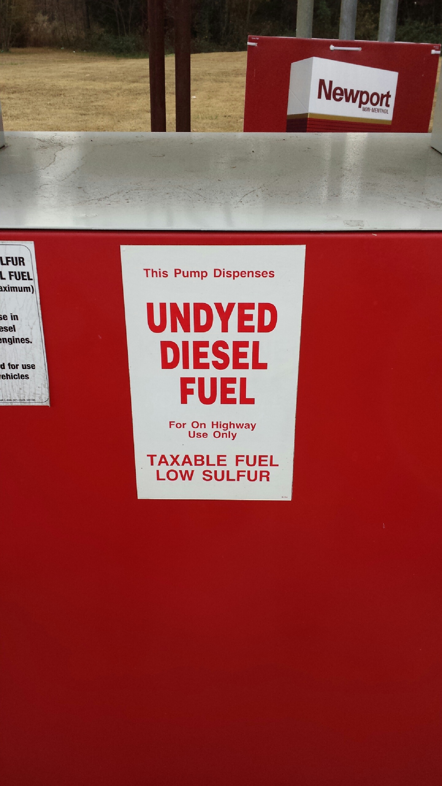

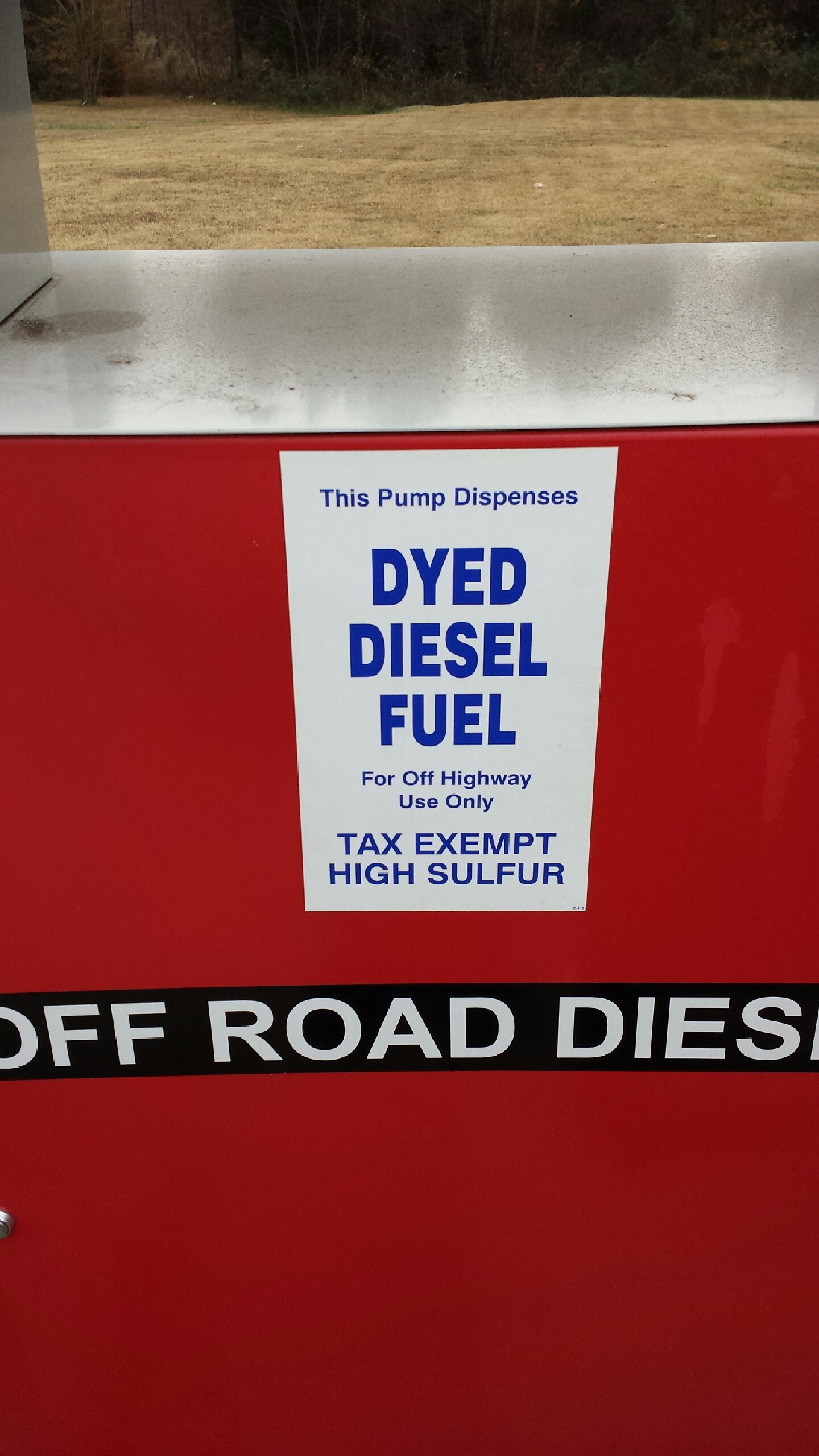

/ Red Dye Diesel #14
I often wonder about this. Still filling up my tractor at Love's with on-road diesel. Nobody can assure me any off-road where offered is ULSD. In fact, one place in particular has it posted that it is high sulfur.
/ Red Dye Diesel #15
I believe in Missouri the State requires pumps be labeled as to Sulphur content.
I average 125 gallons of diesel per month. I only burn red fuel. The savings is .30-.40 per gallon. That's substantial by year's end.
I buy all my fuel thru a distributor called MFA. I think it's local to Missouri. Their stations are card use stations only. If you buy red fuel there with a Credit/Debit card the pump charges you road tax. If you buy red fuel there using their "Petro Card" you don't pay road tax. Weird huh???
/ Red Dye Diesel #16

Well I guess it will all be ULSD by Jan 2014.

EDIT: Everything now is ULSD, or is supposed to be. There used to be a "High Sulfur Diesel 500 PPM - Off Road Only" sticker on my folks' diesel barrels. A couple years ago the fuel supplier scratched them off, saying that everything was now ULSD. They haven't noticed any differences in the fuel but at best they have Tier III engines. My Dad was very particular in buying new equipment *before* the changeover.
