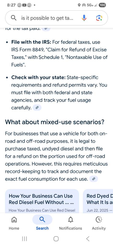

So, I think this is what the road builder in question did. You buy taxed diesel, and record the use in off road applications, and file for that tax to be refunded. It sounds like a lot of paper, but the fuel truck keeps a log of fuel/machine hours/lube dates/PM services for each piece of equipment anyways,
